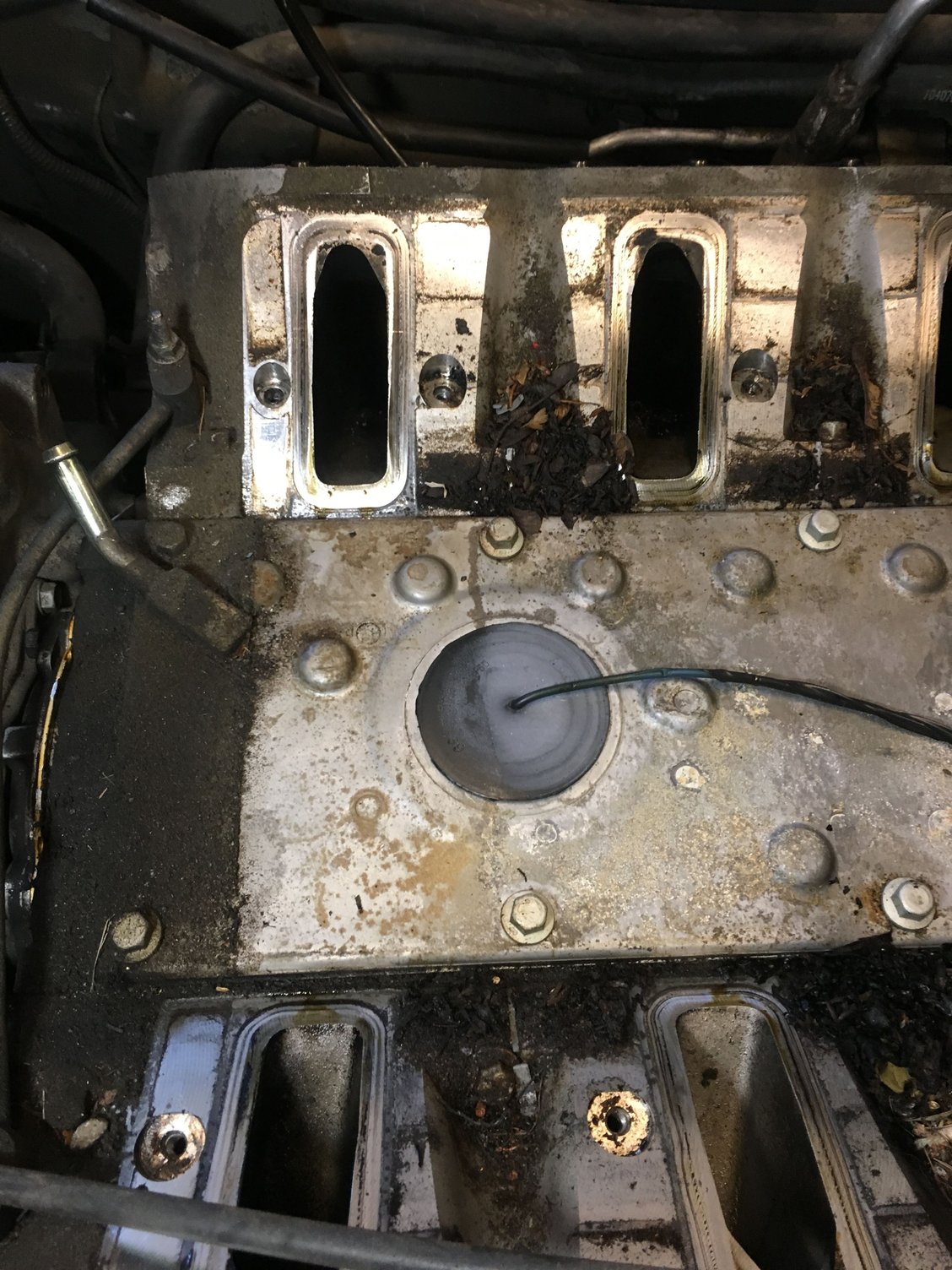

Passenger head off. I can't believe how much dirt was under the intake manifold

Be careful cleaning the engine deck surface. Don't use any abrasive. I carefully scraped the gasket material off with a razor. Both the engine and cylinder head deck surfaces need to be perfectly flat like within less than .001". The exact speck is in the book. That doesn't leave much margin for error. If the Head shop has to deck the head more than .003" you may need a thicker gasket to maintain the same compression ratio so wait to order the gasket. With a supercharged engine too high of a compression ratio can cause pre-detonation problems (knock). Pre-detonation is the enemy. You may want a thicker gasket anyway with 243 heads as the LS6 has 10.7:1 compression ratio. 11:1 would be a little too much for FE unless you are planning on running E85, meth water injection etc...
If you want to be **** you could check your cylinder bores with a dial bore gauge to make sure they are not tapered or out of round. That's is up to you.
What do the heads look like?

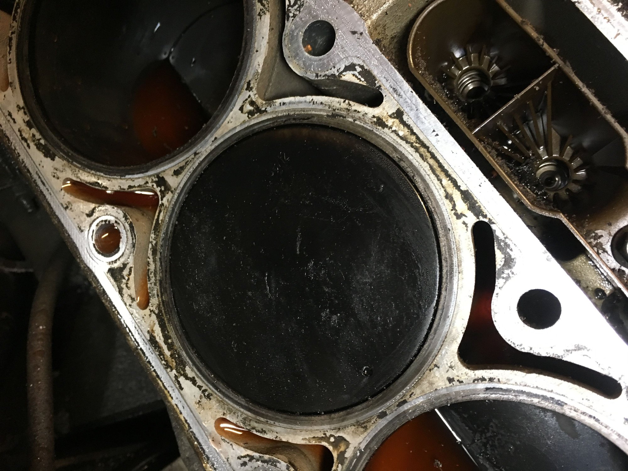

Great thanks for the tip. Any idea what gasket I should get? Also after I vacuum all the coolant out of the cylinders is there anyway for me to tell if the pistons are bad?
Vertical grooves in the cylinder would indicate a broken ring (large enough to catch your finger nail). There may be some cross hatching but that is just the factory hone. If you can still see the cross hatching from the factory hone then you probably don't have substantial cylinder wear. These engines are really pretty hardy. Look for any chips or cracks on the edge of the piston (ring-lands). Get each one at top dead center where you can see them. You can only make an estimation at this point.
There is no good way to check ring seal with the head off or with leaky heads. When You put the rebuilt head on you can check compression.

By looking at the spark plugs in your other thread it appeared that the carbon build up was consistent with the carbon on the pistons with no burnt oily residue. The oil on your Plugs looked wet and fresh, probably from your compression test.
If all checks out I would have a fair amount of confidence that the ring seal is good.
Don't get any sand or trash near the cylinders or rings. I know that is near impossible but do you best.

You can clean the carbon off of the pistons with a soft brush and brake cleaner. Try to keep trash out of the ring area. The pistons stick out of the hole a few thousandths so you should be able to hold a rag around the edge. Carbon isn't as bad as getting sand in there but be careful.

I would advise against ordering comps trunnion kit... I made an old thread showing the abnormal wear they were having on my car and many others have had the same issue, if you search you can find that thread and there are lots of pics... in my opinion the straub trunnion kit is the best choice... a friend showed me a trick of how to get all the trash out of the rings... you don't want to use compressed air to blow it out because that can also get more trash lodged in the rings... get a can of wd40 and spray it in around the edges of each piston and turn the motor over and all the trash will collect in the wd40 and get pushed to the top of the wall and then you can use a cotton towel to wipe it up... just repeat that process until they are squeaky clean... also use mineral spirits to clean the dog crap out of the deck to make sure the new gaskets seal
