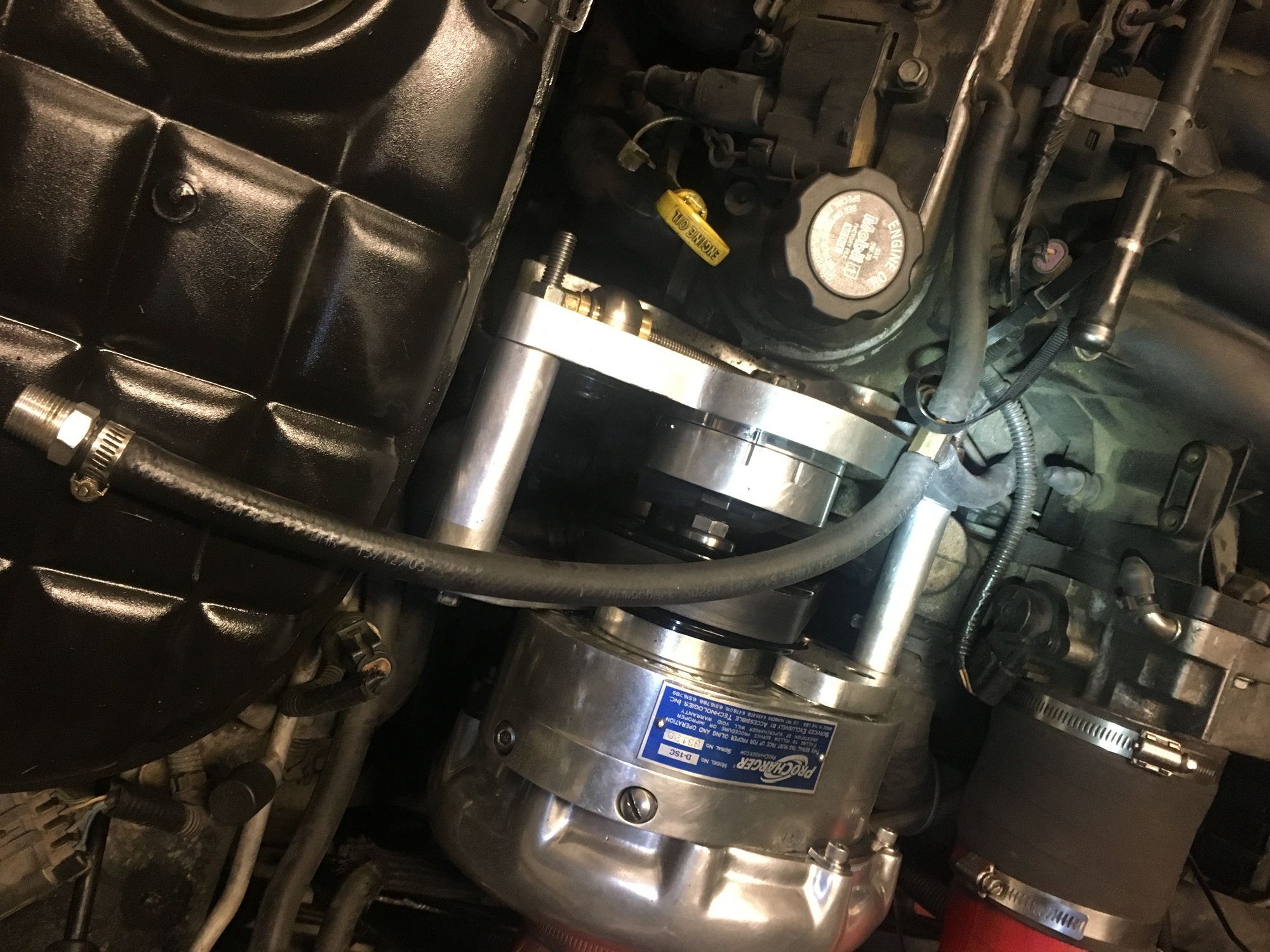

So I been reading a lot online and a lot of people are saying the oil shooting out can either be a vacuum issue or my pcv isn't setup right. This is how my pcv is setup on my ls6. I had that end going on a one inlet vented catch can. Nothing is going into or coming from the intake manifold. Just a line from the passenger side head and the valley cover.

When you make boost you loose vacuum. Maybe the supercharger is pushing air into the PCV system the wrong way where it inters the throttle body. There needs to be a check valve (PCV valve) in the line to keep it from doing that. I don't see one in the pictures. You might be getting boost in the crank case and catch can through that line. That could be enough pressure (8+ PSI) to push oil out of the seals. If you do have a PCV valve make sure it isn't in backwards.
If you are concerned about the condition of your engine then just do a compression test. Compression gauges are not expensive. They usually measure above 175 PSI, or possibly lower but should be within 10% of each other.
Check all 8 cylinders and look at the condition of each plug. You can find a chart that tells what the deposits on the plugs means. You can label the plugs and post pic's if you want.
I doubt you are having engine failure based on the information you have given.

It is a one way valve so you don't get pressure in the crank case. You probably need an aftermarket one for blowers or find a PCV that will fit to block boosted air. Here is a diagram with a breather. That line could go somewhere in front of the blower.

You have the LS6 type valley cover with the PCV line coming out instead of it coming off the valve cover but you get the gist of it. You need a valve in the throttle body line.

Boost is getting into the crank case through the hose at the valve cover. You have a line going from the throttle body that T's off and one end goes to the valve cover with no valve anywhere between.
If you can blow air into the valley cover tube then there is a problem there too.
