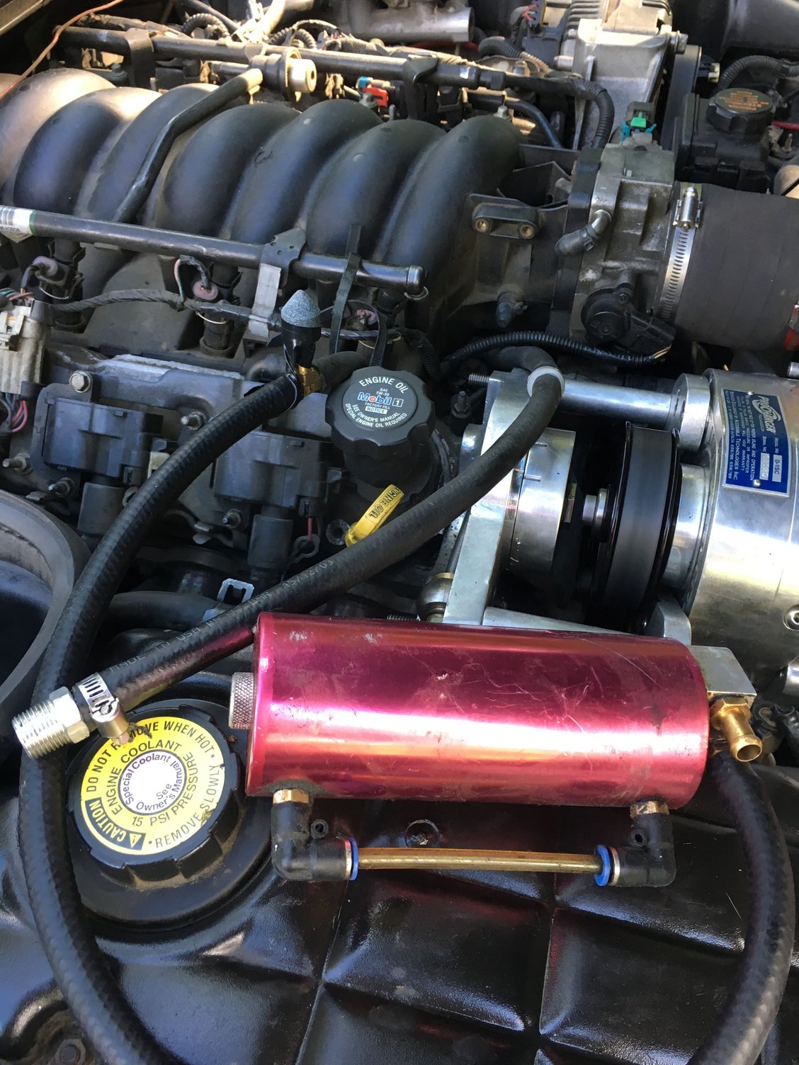

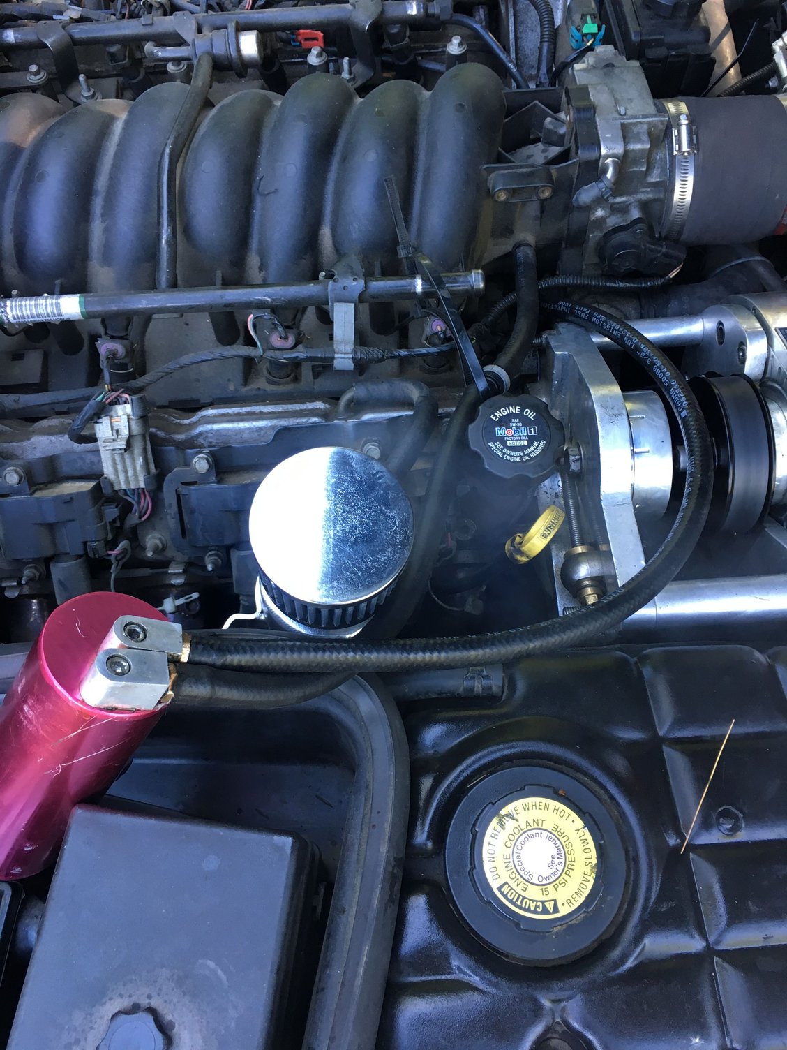

So I took the T off and had the hose from passenger header go to an open ended catch can and then I had the hose from the valley cover just hanging out. At idle there was no smoke. Then when I hit the gas some smoke started coming out. Very very little oil if any this time. Now if I close the loop and have the hose from head go to one opening in catch can then the other end goi g to throttle body and the hose from valley go to manifold where does the excess pressure escape?

So I used two catch cans and tested it out. One from valley cover to catch can and then from that can to check valve to intake manifold. Then a hose from head to vented can. Smoke coming out of vented can immediately.

Should I route the hose from head into manifold as well? Or into throttle body? I don't think I want that smoke and mist going into my procharger right?

Just took it for a 5 minute drive. Smoking like crazy and oil dropping out of catch can breather. I think I'm effed.
