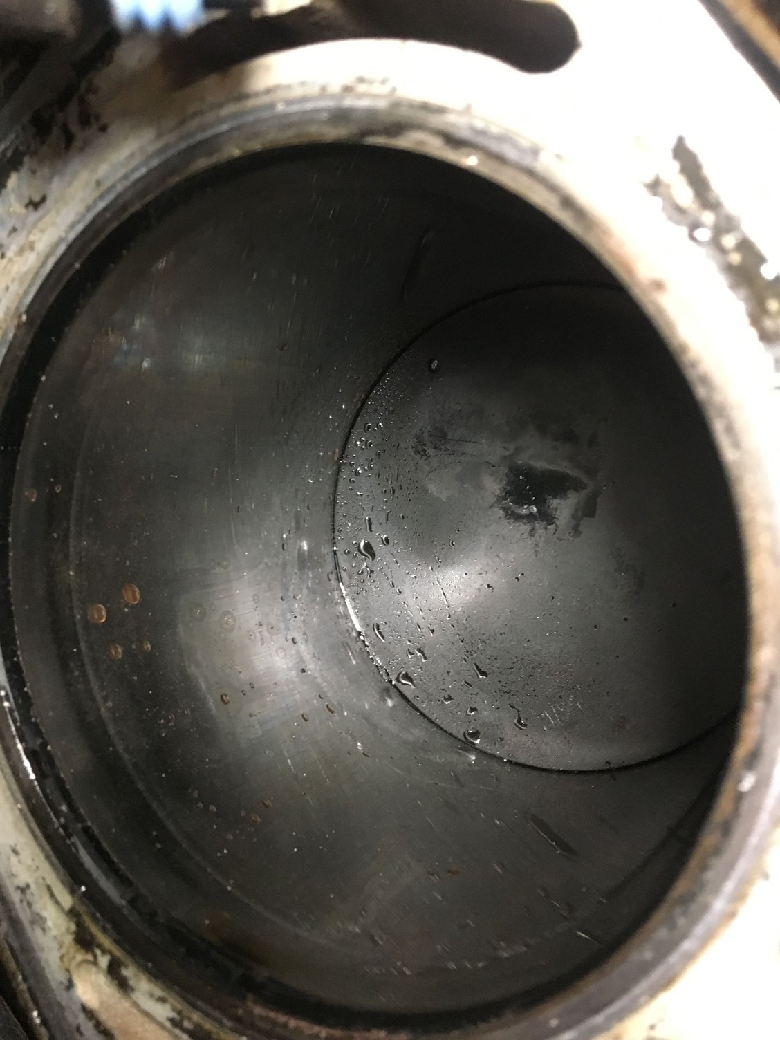

So got both heads off. The cylinder walls all look perfect. Not a single scratch. Can still see factory swirls. Hard to tell by the pics but they are really smooth.

Keep the rust out.
You work quick. You will probably be driving next week.
I think you could go ahead with the LS9 gaskets as far as thickness goes. I would do a search to see if you agree. I'm sure someone will have objections to them because of the bore size. I haven't heard of anyone having a problem. They have 7 layers instead of 3 and made for a FI engine.
