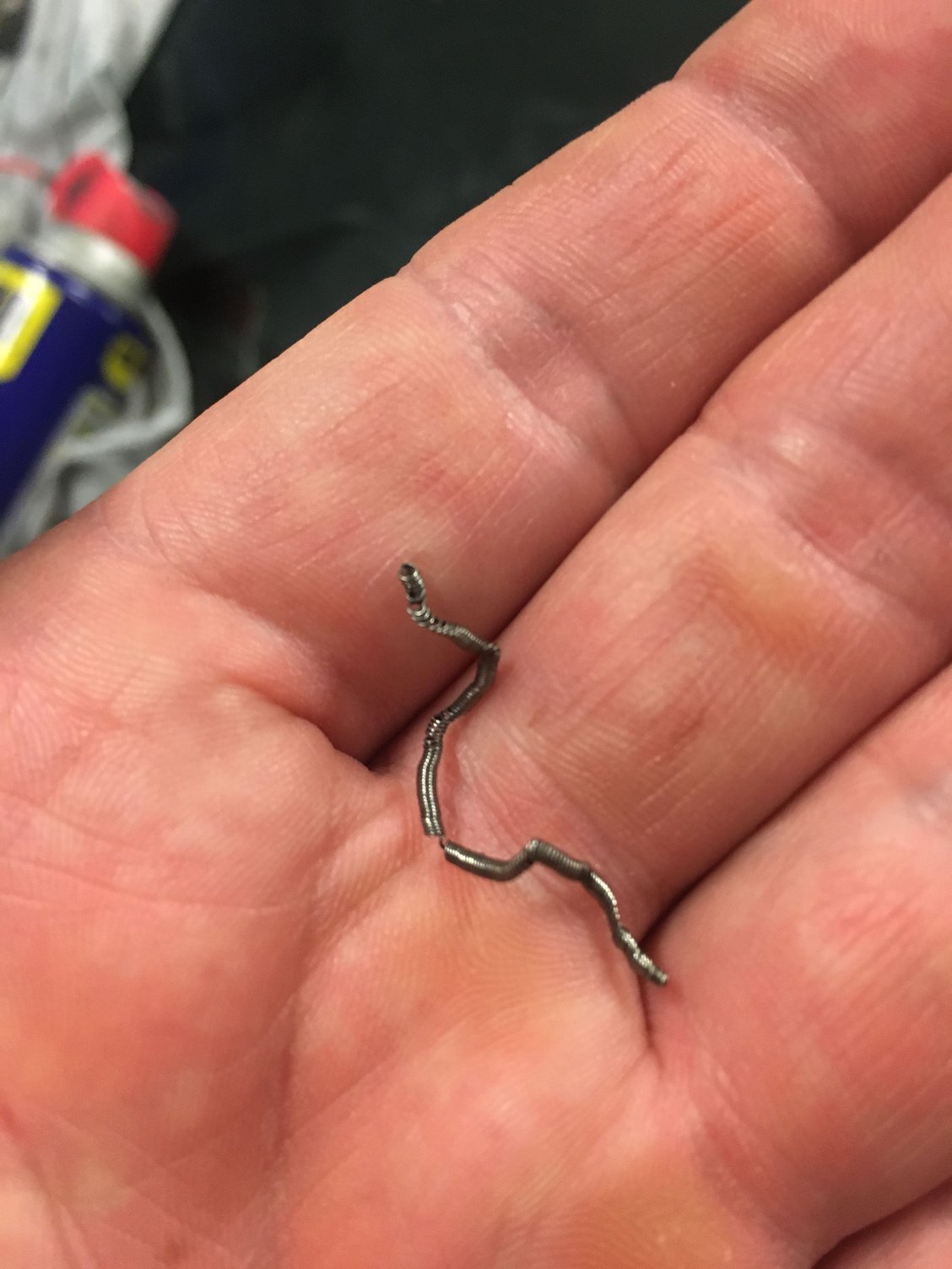

So I was taking out my old lifters today and found this in the area behind the lifter guide. Looks like a little spring that goes on a seal. Any idea where this came from?

It may have came out of that broken valve seal.

Yup that makes sense. Thanks
