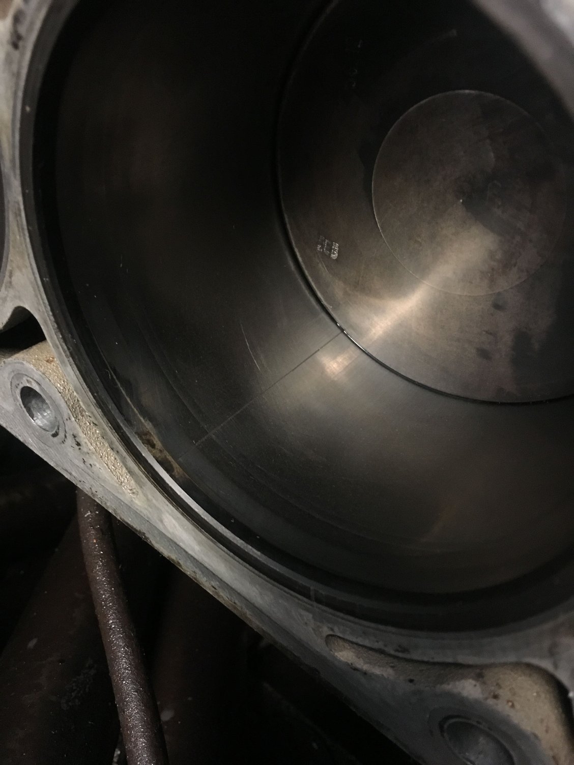

Well on another note. Since I had the heads off again I wanted to double check the cylinder walls and one piston was at top dead center. So I turned the crankshaft and when that piston went down I saw this. It's a straight line in the cylinder I can just catch it with my fingernail? Is the ring messed up?

That was supposed to have been checked earlier in the diagnosis.
If you skip one step in the building process your going to have trouble.
That could be caused by a lot of things. That piston has a marking on it too.
Was that one of the cylinders that measured good?
Was it the one with the broken valve seal?
Old Jun 22, 2017 | 06:33 PM

Yeah i I definitely rushed trying to get the car back on the road. I'm just glad I checked before I put it all back together and have the same blow by issue. I don't know if it was the one with the bad seal but i do know that it was one that had low pressure.
I think what I'm going to do is take out the engine and bring it to my machinist and have him check it out to see if it's fixable. Then if it's ok I'll have him balance and install a rotating assembly and put the whole engine together.
