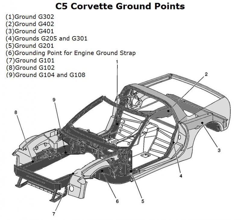

Have you checked your grounds?
The other thing you can try is cycling the 4/way switch - spray some contact cleaner in it and push it in & out about 25 times, this might help for awhile. If it does, next might be a replace.
