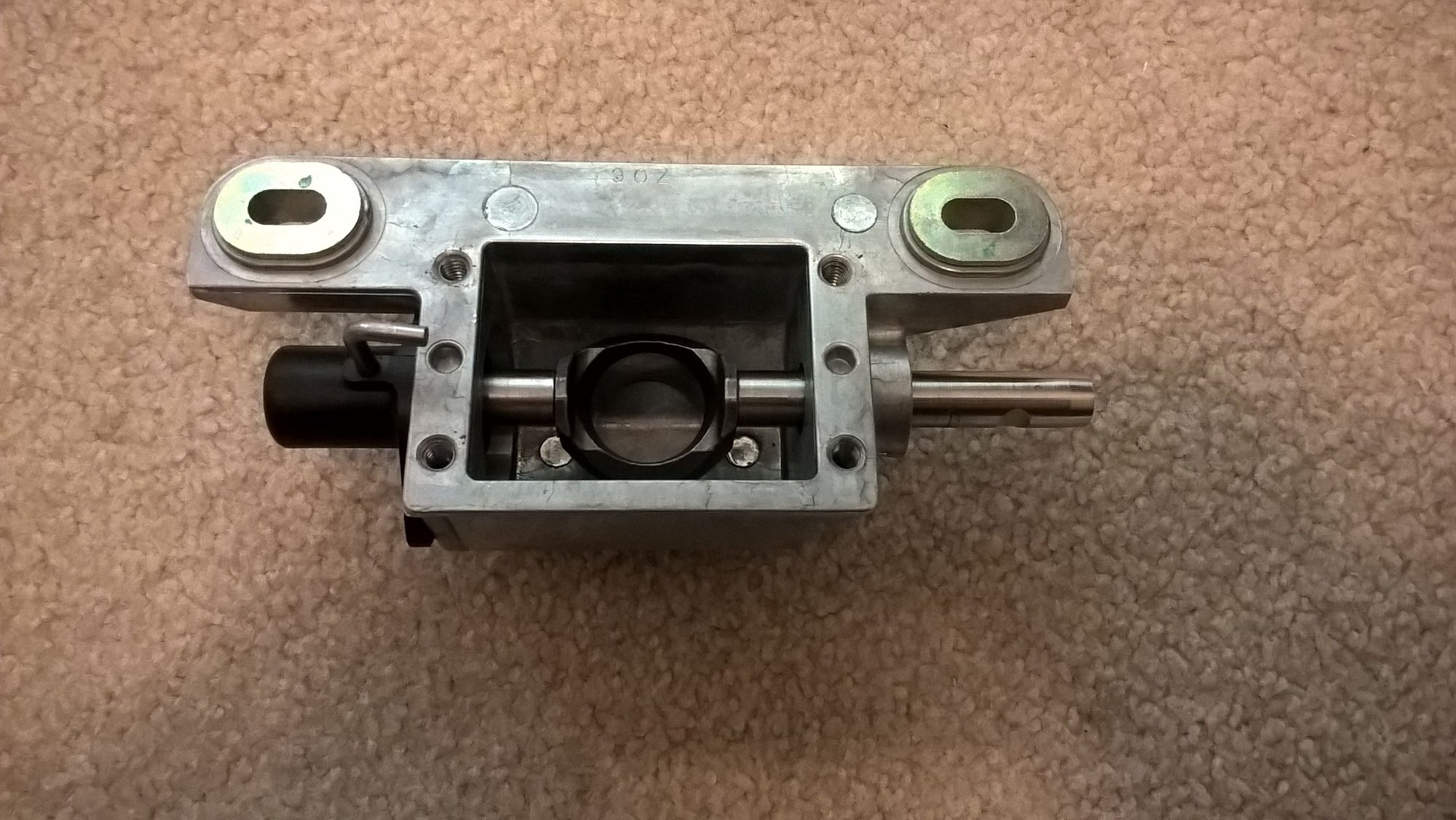

ZIP Products sells the poly replacement bushings. Also make sure that the four top bolts are tight and the shifter rod coupler bolt is tight and there is NO slop in the coupling.
I greased the lower box inner shift rod/yoke while I had access to the box. Helped out a good bit!
