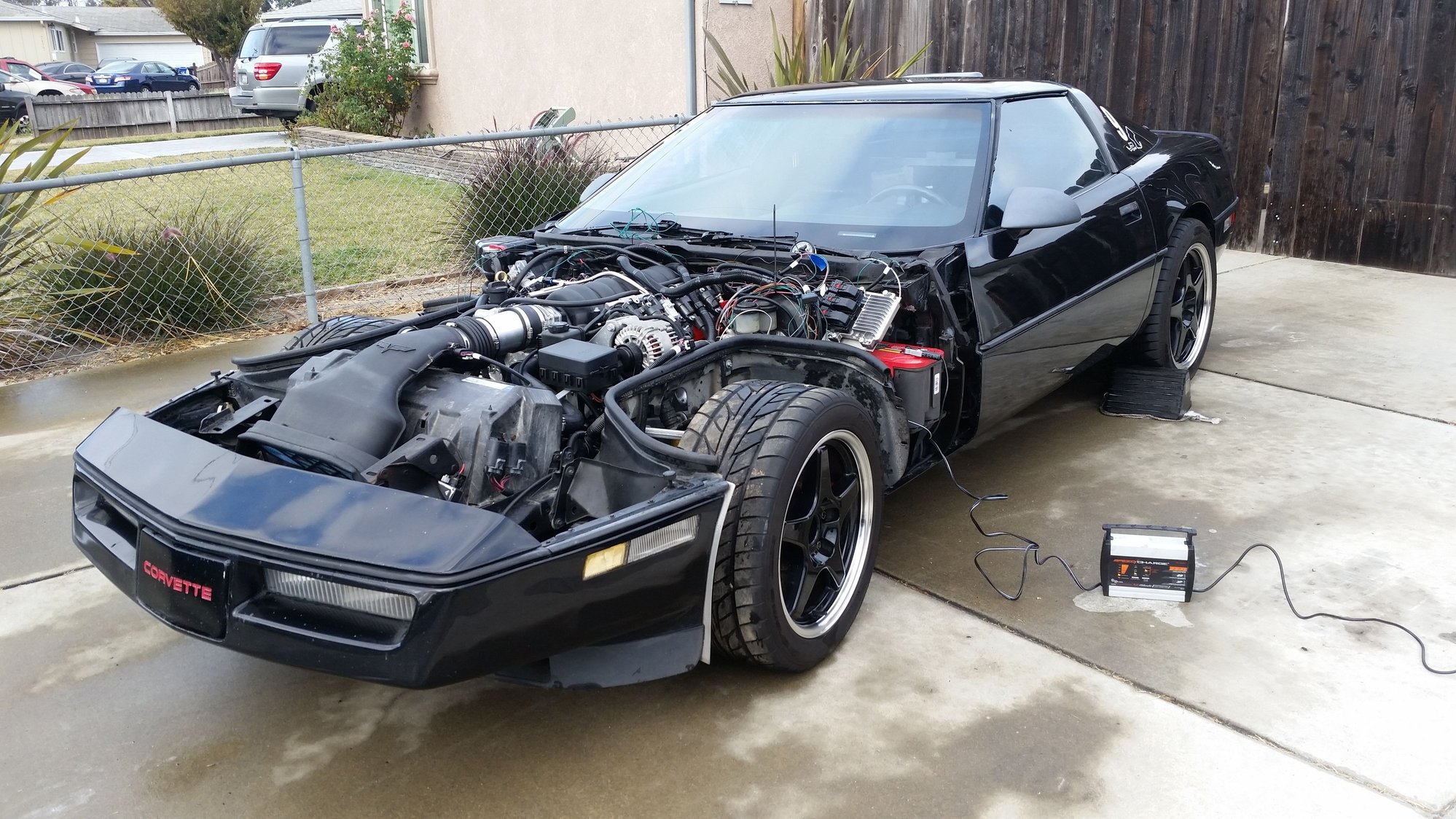

I did an LS3 EROD CA smog legal swap in my 1990 Base car 6 speed...its not hard for a tinker type of person...lots of work and I'm still ironing out the details. Financially it doesn't make sense but it was my first car I bought with my own money and I like the sleeper build surprising others when they see what I'm packing! I'm only here because I will be acquiring my dads 2000 FRC soon and looking into after market seats when I came across this post and just had to chime in here.
Here is my post on the conversion. I still need to update with all the finer details, but this will give you an idea what you'll be in for:
https://www.corvetteforum.com/forums...pe-clutch.html
