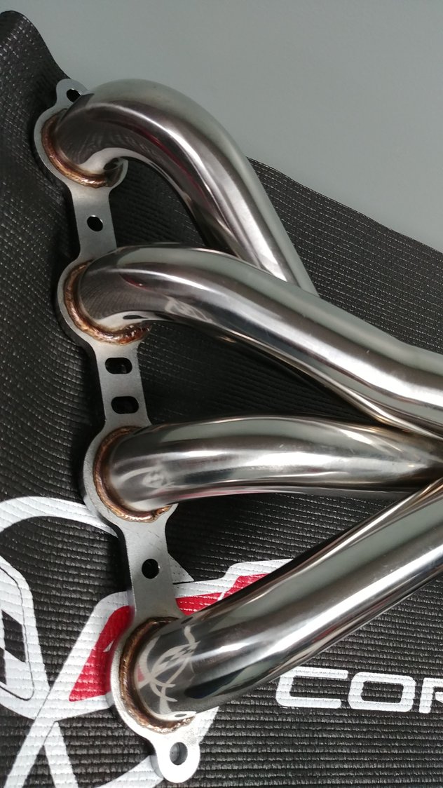

I figured that would be the next question
TIG welds of the pipes to the exhaust flange.

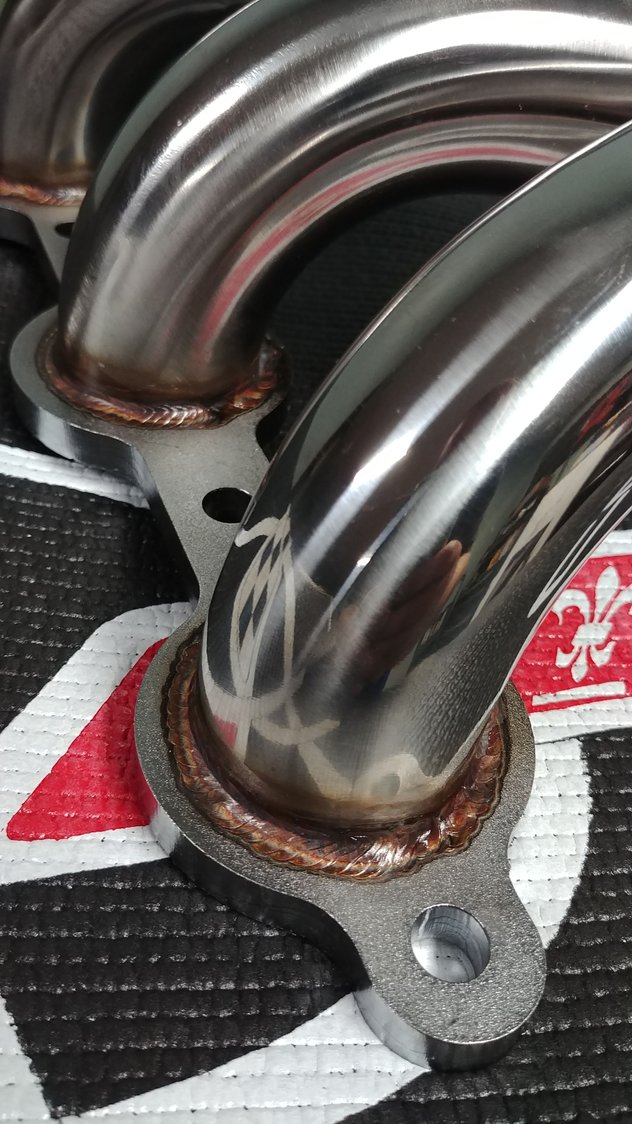

TIG welds of the pipes to the exhaust flange, pt 2!

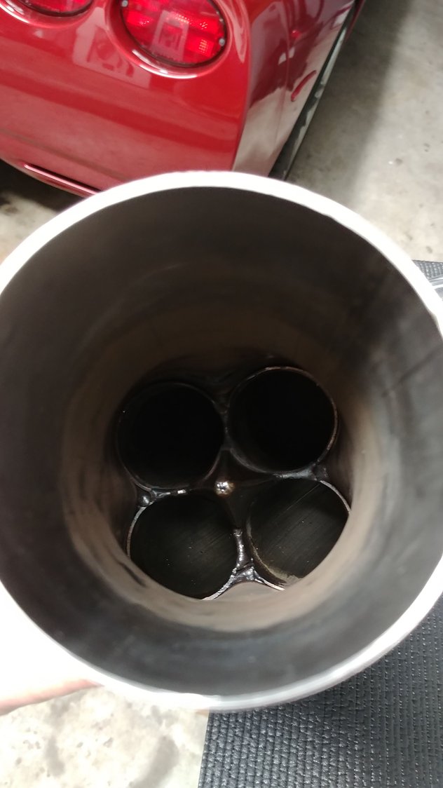

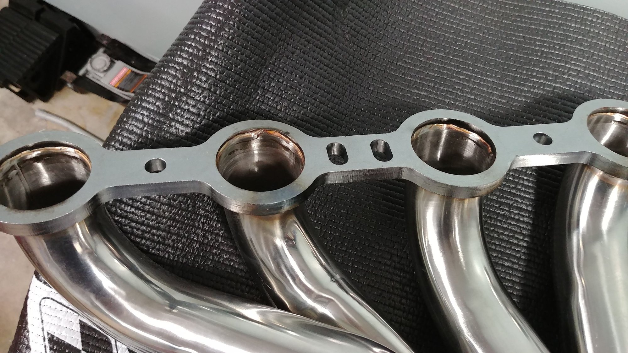

Inside the pipes.
Inside the collector, looking at the spike dead in the eye.

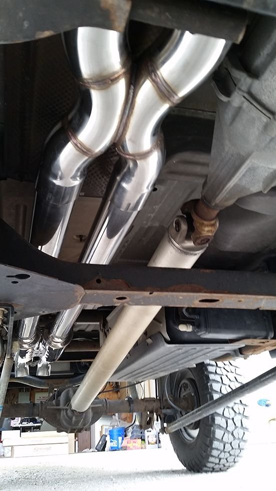

Fun Fact: I have Speed Engineering headers on my Silverado and I HATE them.. The Flange to the head and the 02 bung are NOT stainless, they WILL rust. In fact the entire header/x-pipe combo has terrible surface rust.. The bung was also welded in the wrong spot for the O2 and it hits the damn floor.. Cheap Chinese Junk! They looked good brand new..
Brand new
One year old
