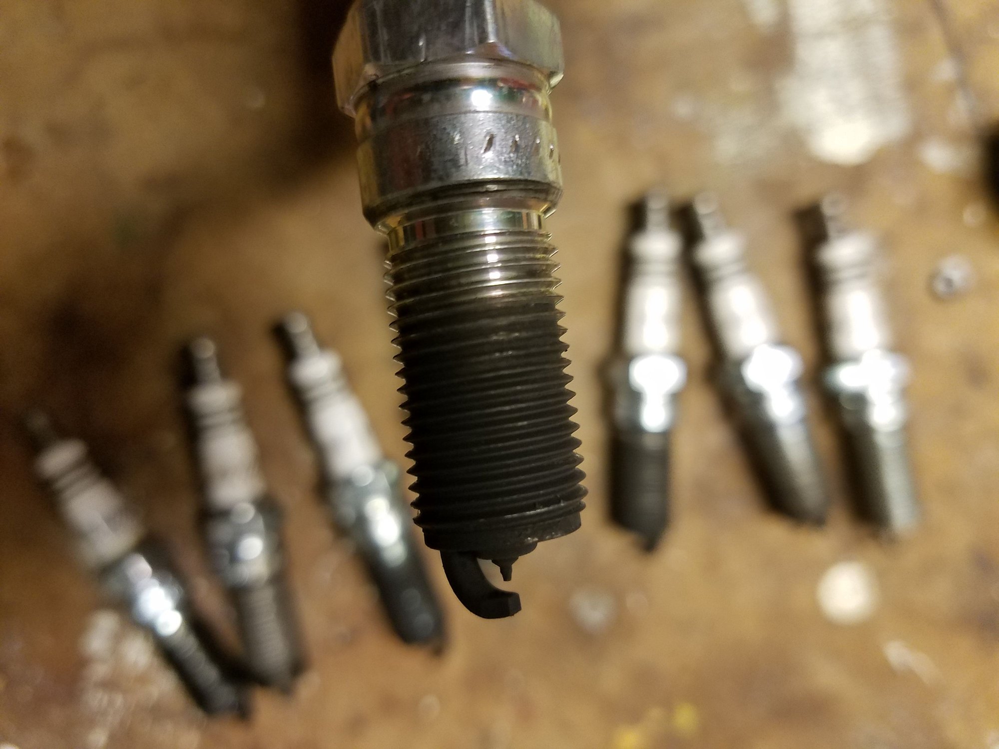

I went around twice when I reinstalled. Went back and checked and retorqued everything. Also, hit the plugs with some brakekleen. I noticed there is a a lot of carbon built up around the plug holes. I tried to clean them out a bit and reinstalles the plugs after they were all clean. Tried to crank the car 3 more times pulles the plugs again.

That doesn't look like enough carbon to keep it from firing. Even if there was a problem with those cylinders, the remaining cylinders should run unless there is a broken valve. There was no problem with valves before you replaced the intake though.
You could check the compression on the cylinder with the dirtiest plugs if you want reassurance.
