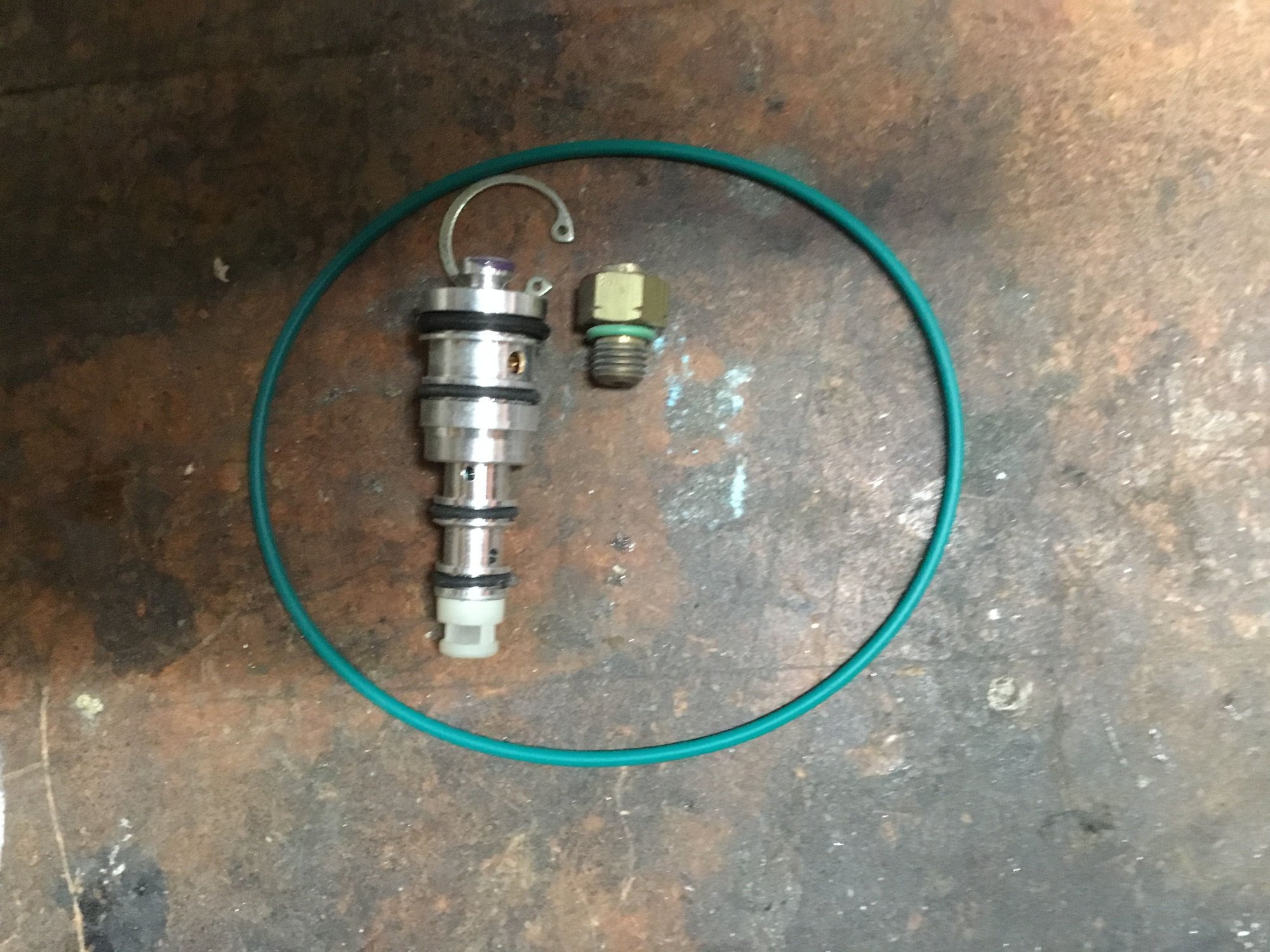

There are two additional leak paths from the rear head. The high pressure relief valve with the green o ring and the control valve with the black o ring. The large green o ring is for the cylinder. There are two of them, one for the rear head and one for the front head joints.
