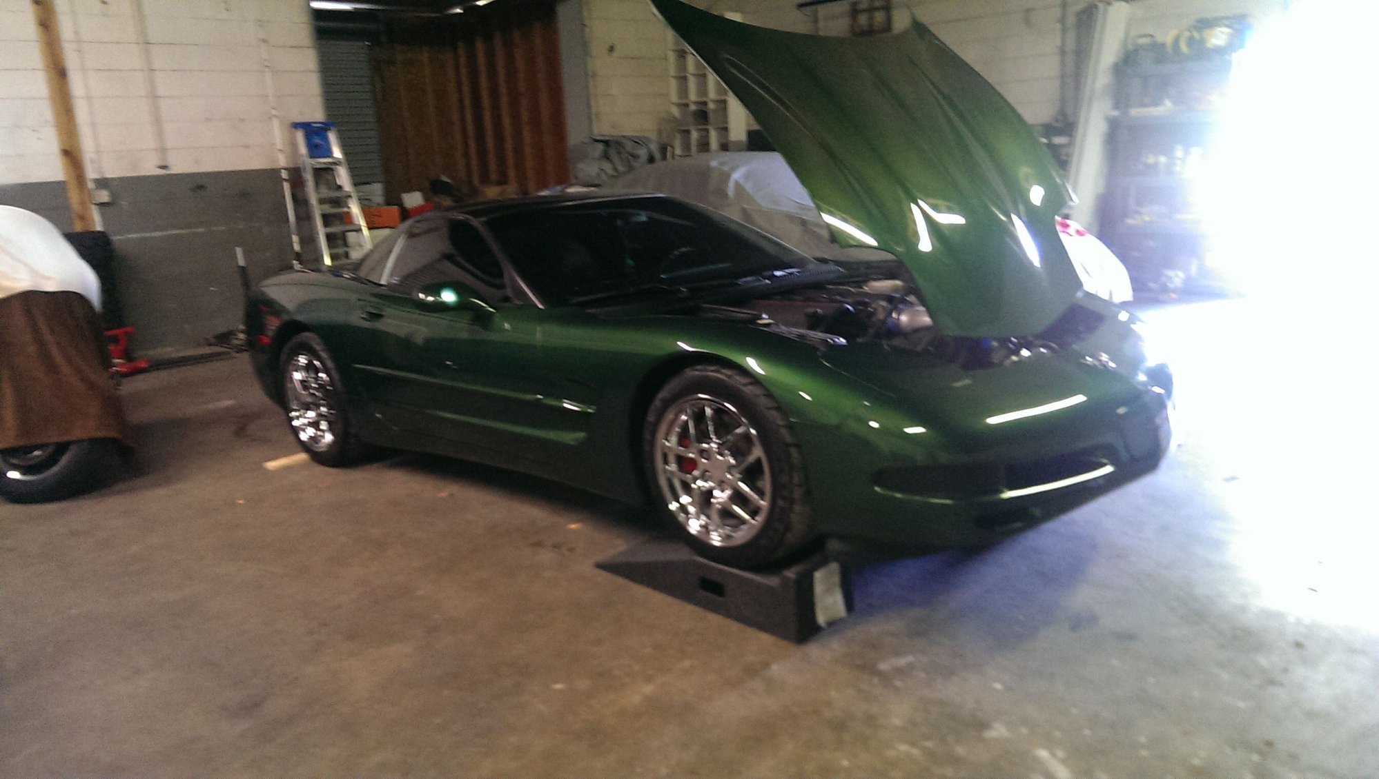

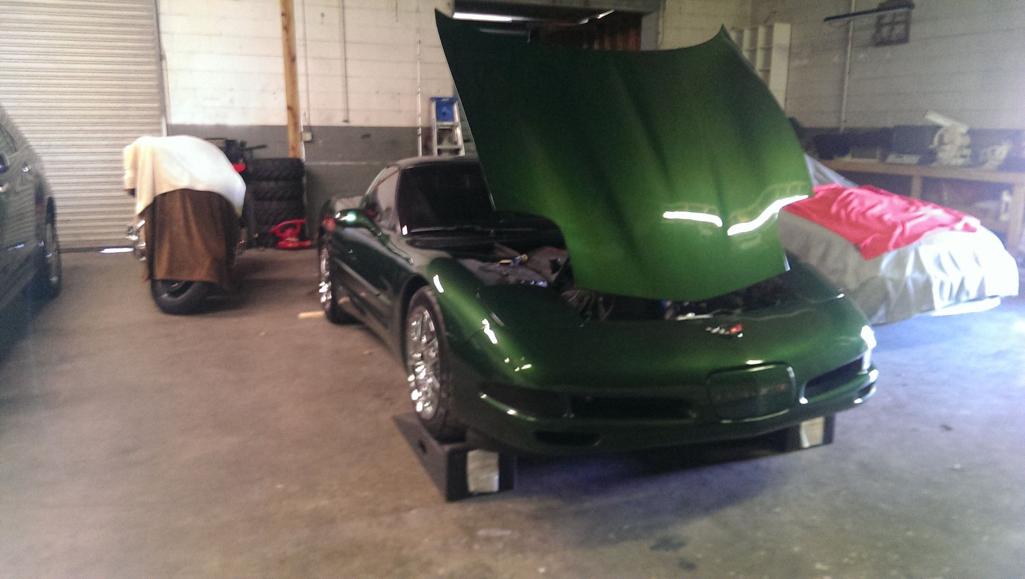

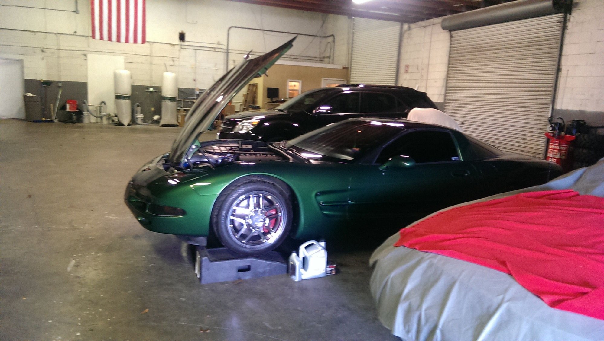

Well the oil temp used to stay around 198-205 now after not driving her for almost a month or lil more, it likes to go to 225 n maybe higher i havent driven it to far as in fear of overheating. Now it did take over 45 min of around town driving to get up there. But the first time i jumped on her she jumped from 217 to 222 in a second. I did plan on doing is putting her on the lift to see if maybe the radiator has some clogging going on. Just gotta wait till the weekend because of work Hopefully quick fix, i do have compressed air Great Idea!!
