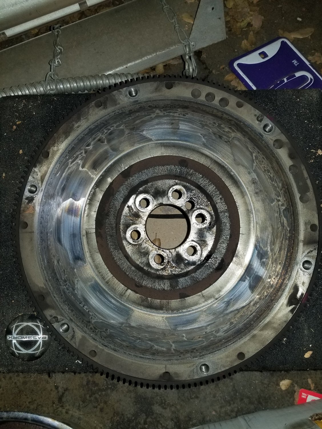

So I got everything removed and I marked my old flywheel position, bolts, everything. This is my first clutch change. I don't believe they are supposed to look like that.
Also, all the bolts around the outside had a flat spot towards the clutch disk. Is that normal? Like the clutch disk was hitting or rubbing on the bolts.
Rear main seal leaking. I did find that my very first rubber coupler was absolutely destroyed.

Do you ride the clutch much when you drive?
Old Aug 25, 2017 | 10:23 AM
Scholioso's Avatar
Scholioso
Joined: May 2017
Posts: 499
Nope. Left foot goes to deadpedal when not shifting.
