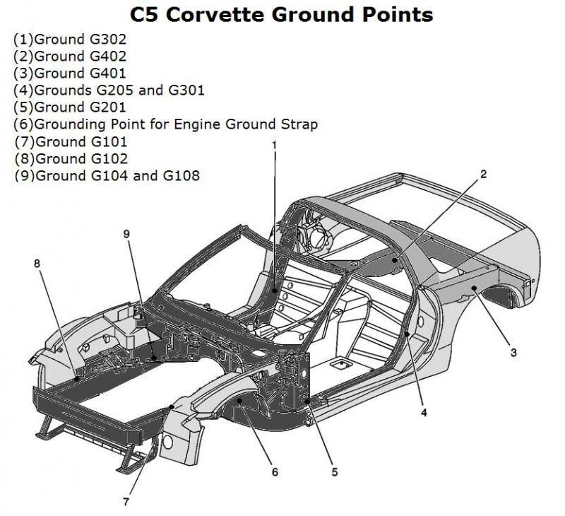

This may help...also check your grounds on the frame-left and right.

Default Cleaning ground connectors
Originally Posted by 8VETTE7
It WILL be back!!!!!!!
Chuck, so how do I clean the connectors, etc.? Baking soda and water and then maybe dry with a hair dryer? I don't what what dielectric grease is, but so it's ok to put it on the connections?
Also, do I need to disconnect the battery when checking/cleaning the ground points?
Thanks. Barry

its hard to ever argue with disconnecting the battery.....they make electrical contact cleaner and sell it at the auto parts stores.
first thing i would do is clean all grounds
