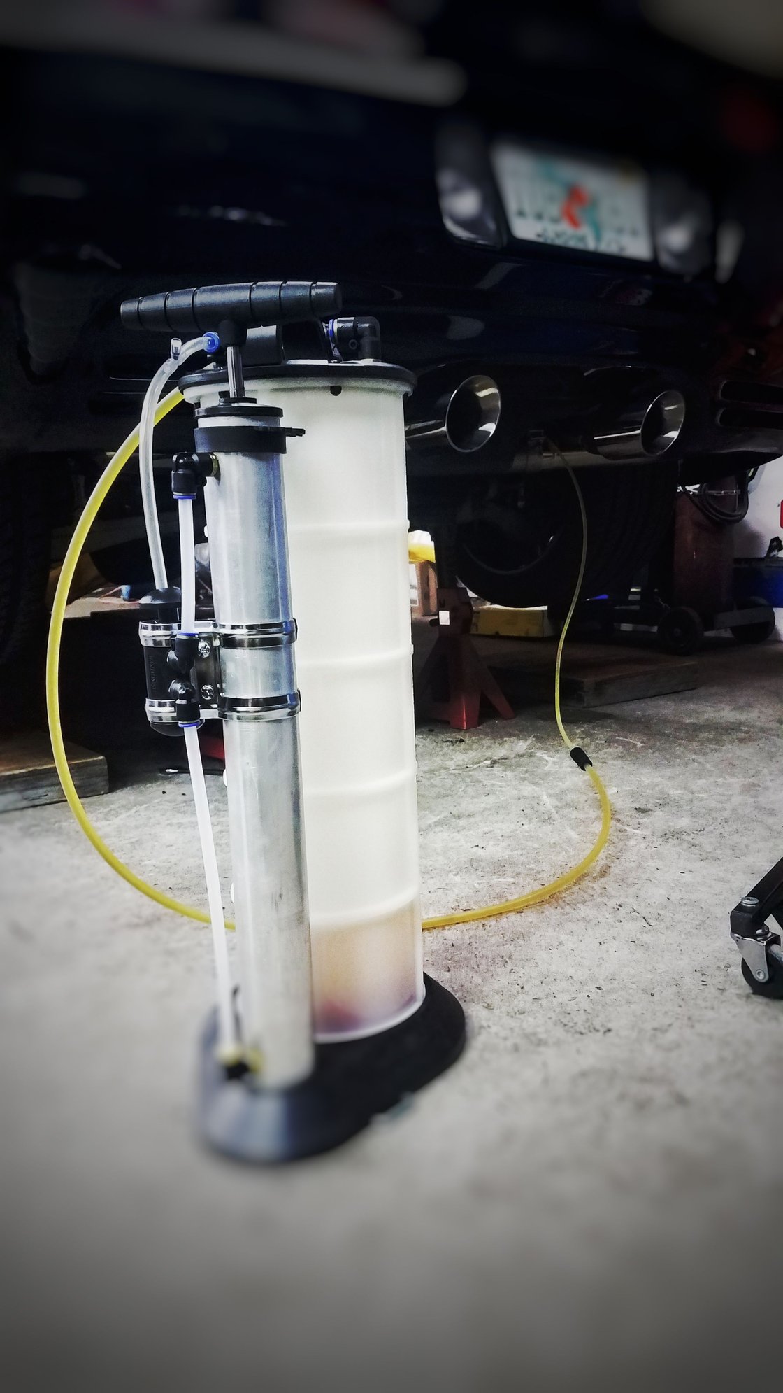

Filled it up with Synergyn and Lucas last night and took it for a quick ride. Pretty much dead silent now. Wish they made something like that for women sometimes lol
Let me tell you, this BluePoint fluid evacuator works amazing for this...

Yes, the fluid evacuators are quite handy.
But just curious why you wouldn't just pull the drain plug????
Then you'd get alot more fluid out and possibly more junk out

This was for filling it back up
