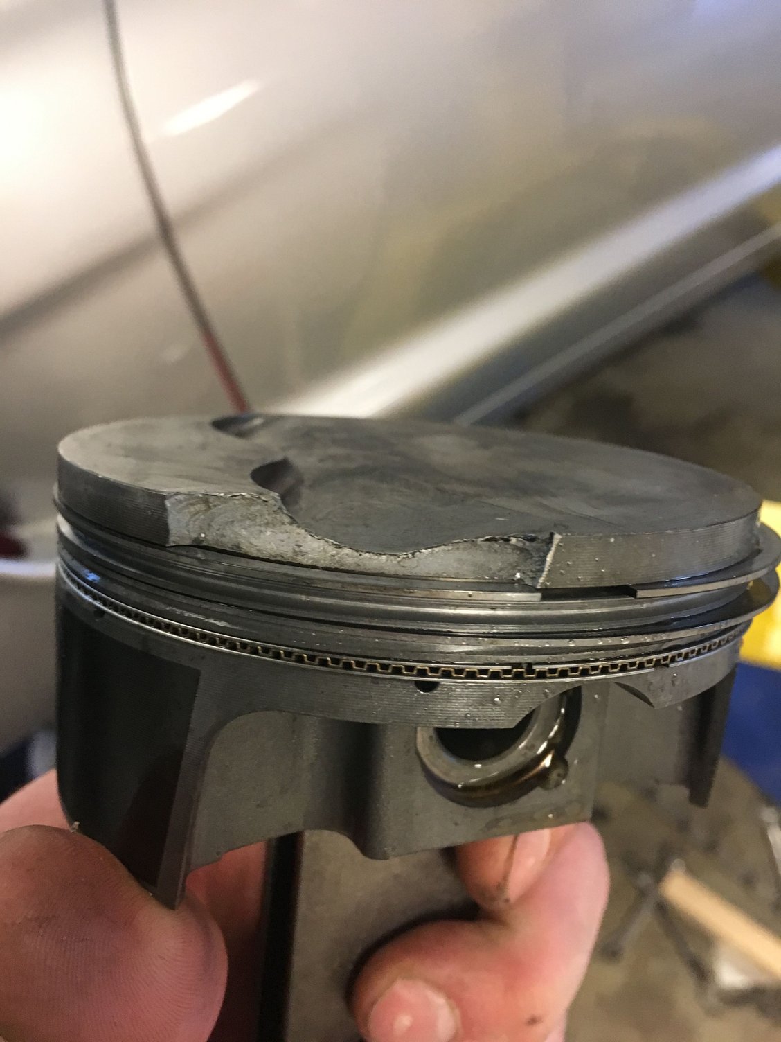

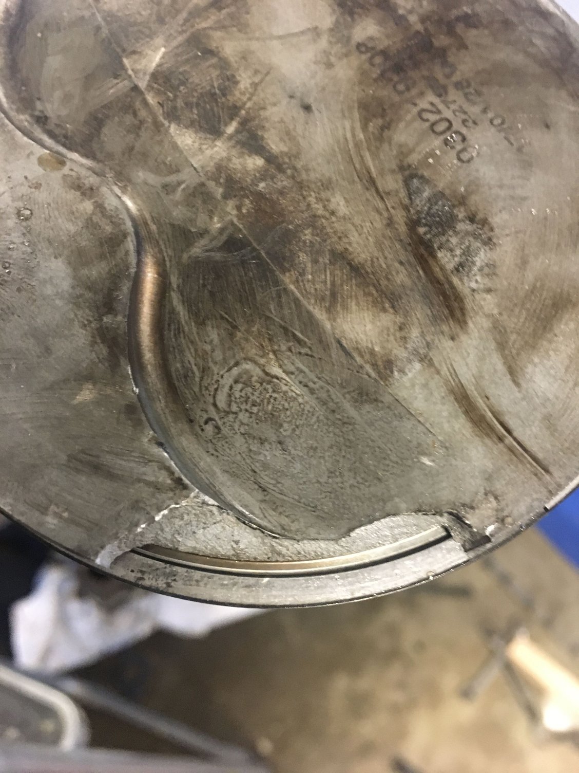

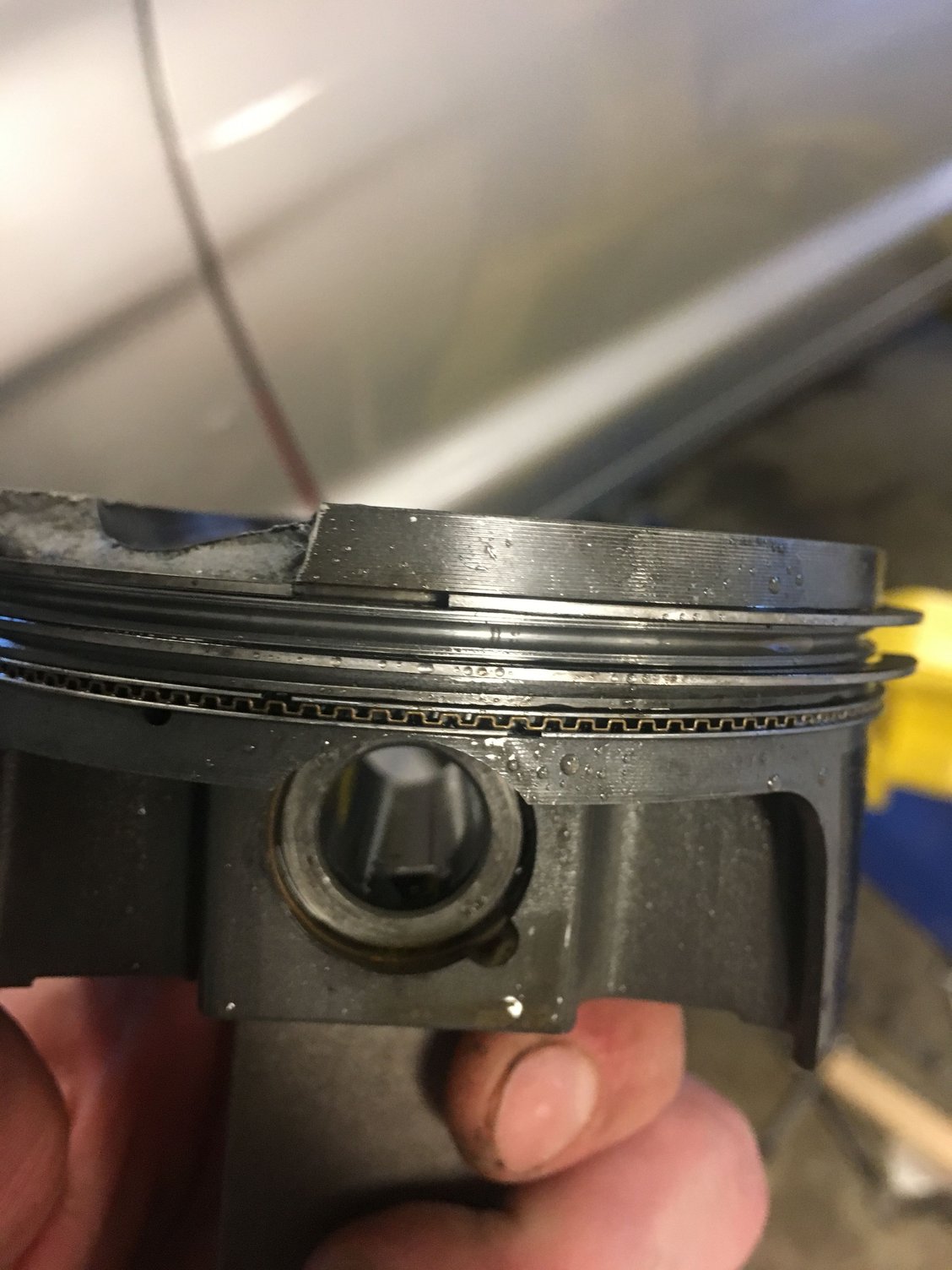

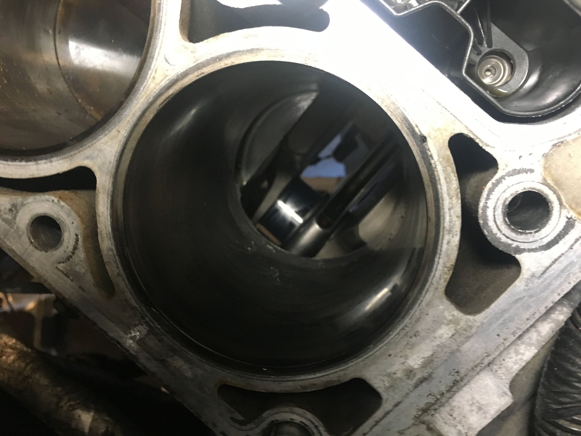

So just got the piston out. The rings aren't busted. The cylinder walls are smoothe as they were brand new. Not a single scratch. Hopefully I can just buy another piston and get new injectors and hopefully this is the end of it.
Still wondering how coolant got in with oil. Could the big detonation have pushed up my heads? The head gasket isn't broken. Might have warped the head.

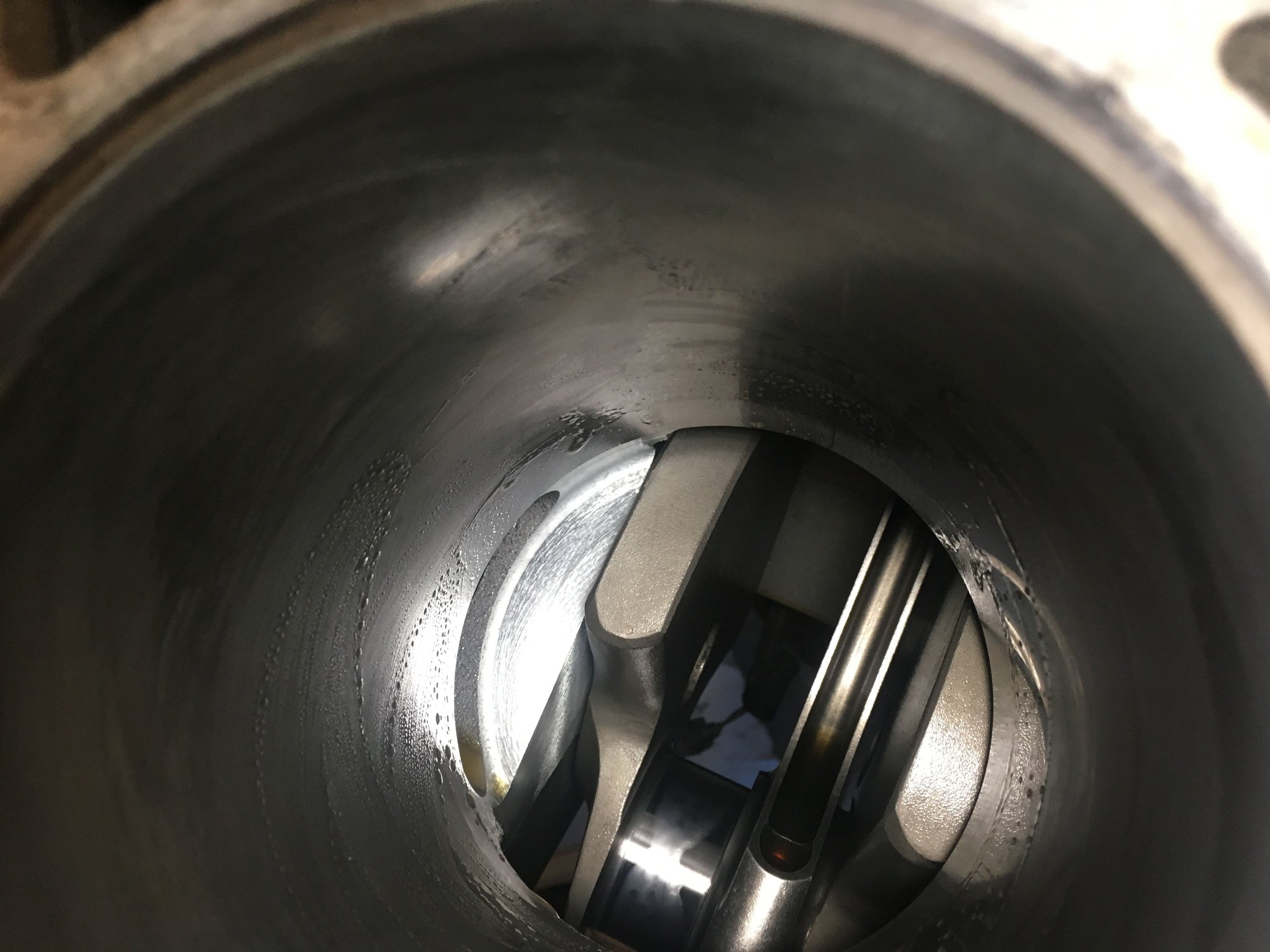

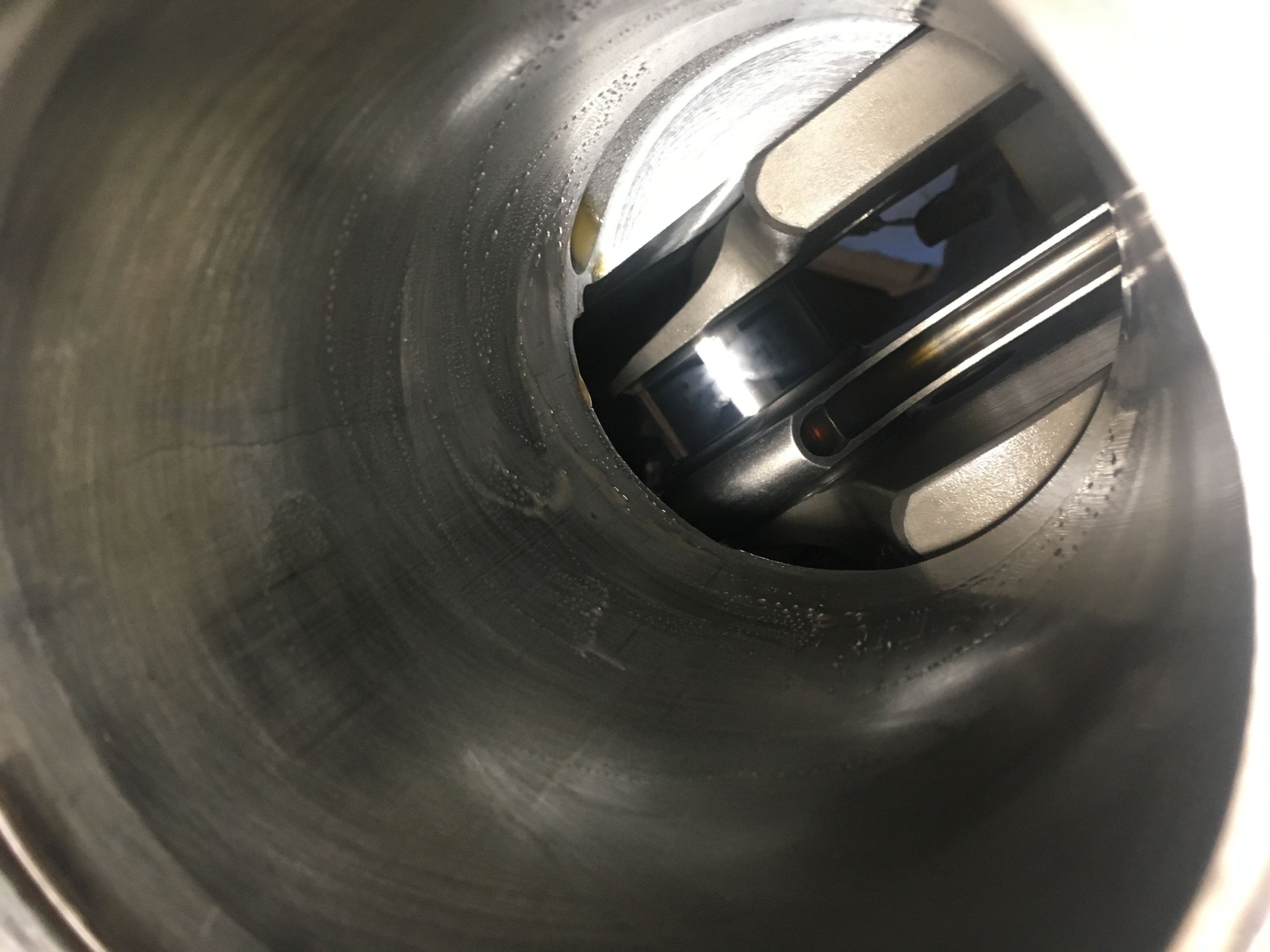

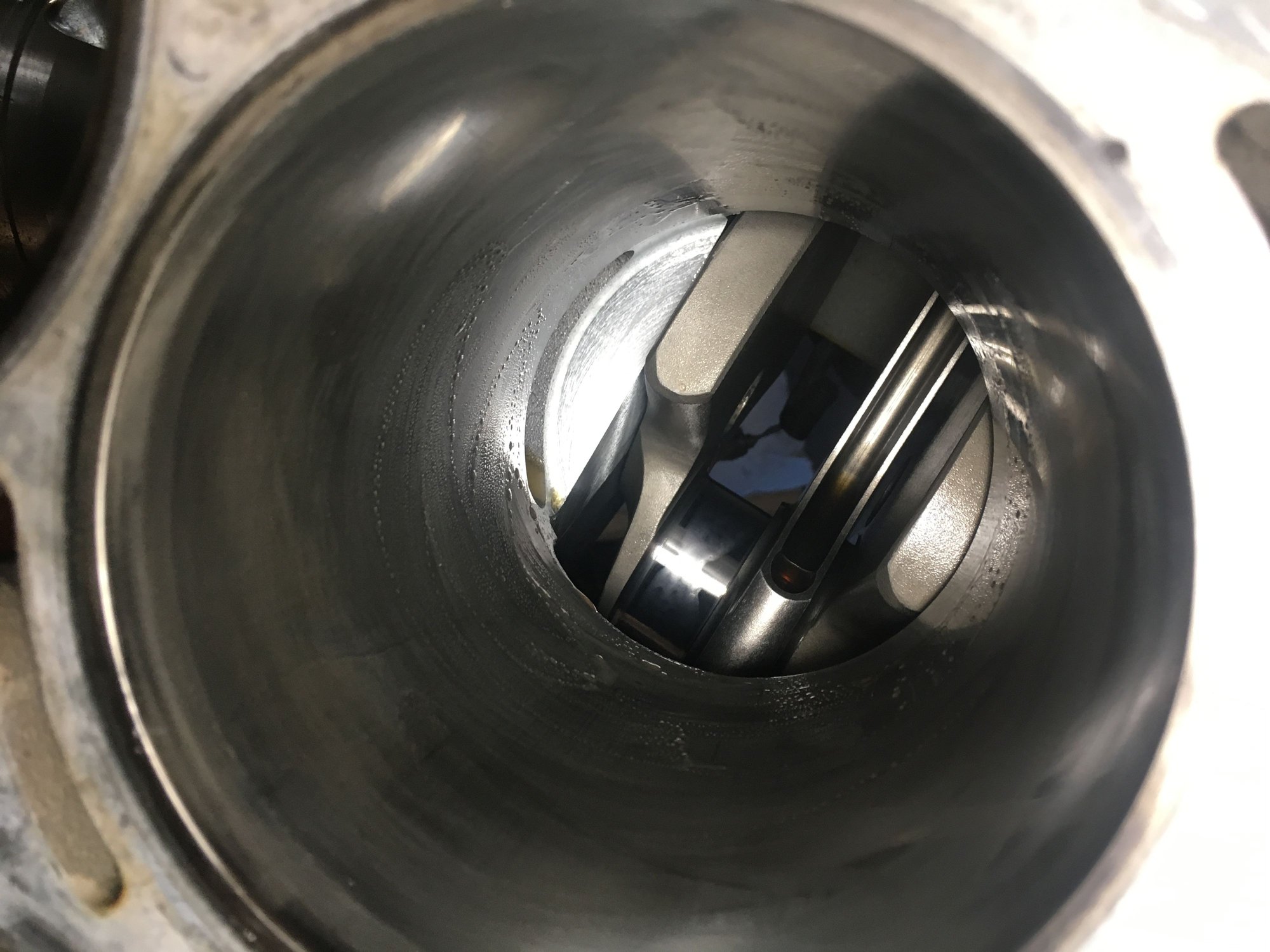

the first pic above, what is that line going down the cylinder?... looks like a cracked sleeve to me, but the camera could be playing tricks

Its either bore markings or oil and coolant from me rubbing my fingers all around in there. I ran my fingernail around the whole cylinder and didn't get caught anywhere.

Well now now that you pointed it out I just checked it again and it is indeed a crack. I don't know how I didn't feel it before. Maybe too much grease on my hands. But my fingernail def gets caught in it. Is that fixable? Or is the block shot?

you could resleeve it but not worth the cost in my opinion so a new block would be your best bet... did they not check it out before building it?... that was most definitely the cause of all your issues and not the injectors... sorry for all the troubles you have had

The sleeve must have just cracked. It was just bored. He would have noticed that. I'm sending the injectors out Monday to have tested so I'll know then.
Since I have a brand new rotating assembly with 3.908 bore pistons should I just get an ls1 block and have a shop bore it to 3.908. Or does anyone sell pre bored blocks?

Yeah now that I found the crack in the cylinder wall I'm probably going to buy a new bare block and one new piston. Then bore block out to fir my pistons.

that sounds like the best option in my opinion... you already have a good rotating assembly and a bare block shouldn't cost too much if you can find one already bare and just have the machine work done... just make sure they go over it really good and maybe look for a better tuner
