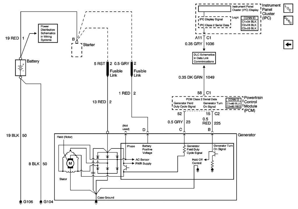

You will need to check the alternator-starter-battery connection path.
You can begin by disconnecting the alternator to see if the short disappears. If it doesn't, then go to the starter solenoid and check the main connection for burnt, corroded or loose wires. That is where the starter, alternator and battery connect together and it is often the cause of charging issues.
Two wires with fusible links run between the alternator and the solenoid post and the 3rd wire runs between the solenoid post and the battery(+). Look at the diagram:

First disconnect the big red wire from the back of the alternator. If the diodes in the alternator are shorted, that is a path tp ground.
