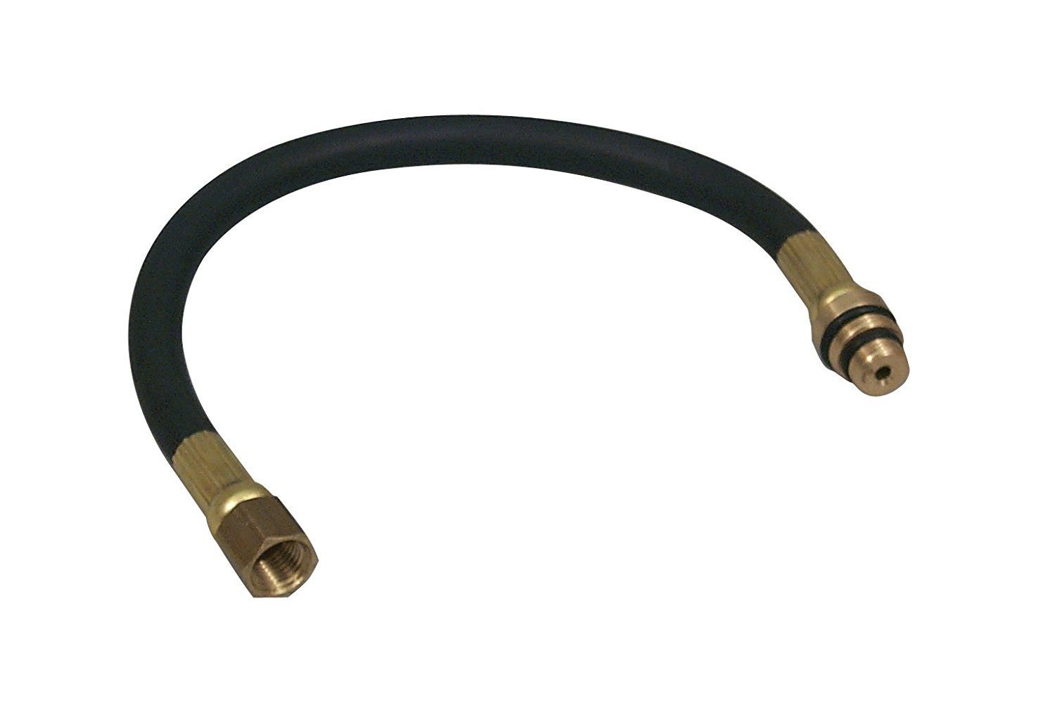

One thing i noticed that no one mentioned. You'll need an air fitting adapter that screws into the spark plug hole and the other end has a fitting for compressed air. By pressurizing the cylinder, the air hold the valve up in place while you remove and replace the spring.
https://www.amazon.com/Lisle-19700-V.../dp/B000COC7ZU
However, I think that most guys don't have an air compressor, and choose to hold the valves in place, by stuffing a piece of rope in the cylinder. Personally, I don't find that all that reliable, but it's easy for me to say, since I have a "big azzed" air compressor....

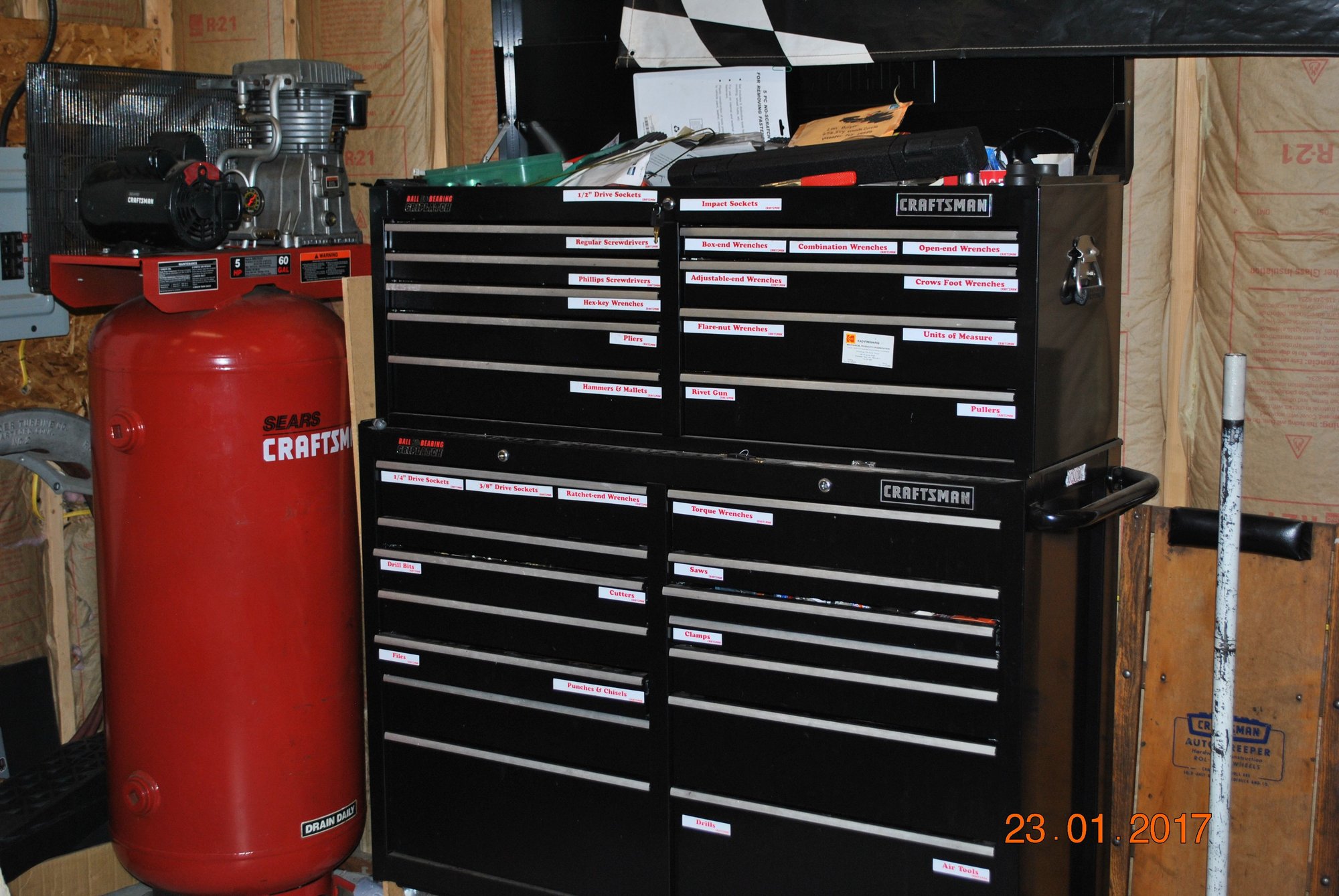

What man doesn't have a air compressor?
I got's me one!!!

That's good. The wires will probably come off easier that way then. As far as the tools go...do you have an air compressor? When I did mine I used my little $99 Bostich pancake air compressor from Menards. It did the job well. The only specialty tools you'll need are a valve spring compressor and the above mentioned valve holder (air hose that connects to the spark plug hole).
Heres the valve spring compressor I used (its worth it):
https://www.summitracing.com/parts/tfs-90306
Here's the valve holder I used (worked great)
https://www.summitracing.com/parts/lil-19700
If you get those and already have a ratchet set with a few different sized extensions, a torque wrench, a swivel adapter, some long needle nose pliers and one of those little extendable magnet pen things, you should be set.
