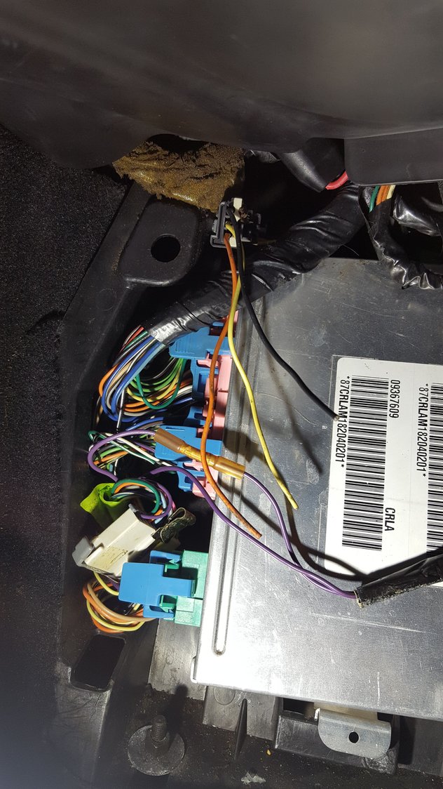

I just picked up my 99 and don't have an assembly manual yet, but I took off the passenger foot panel to check fuses and saw these wires cut...any idea??
Looks like a black, yellow and orange coming from a separate plug...
Thanks in advance for your insight!!

I think those are the accessory wires. They are normally taped up. PO must have untaped them. They are provided for you to connect after market electronics. Orange HOT at all times, Yellow Switched with ignition, Black ground.

You are correct. I used the yellow and black for my radar detector and usb charger. Works when the key is on only.

100% on the mark and they are 20 AMP Fused. The late 2003 and all 2004 C5 DO NOT have those wires!!
