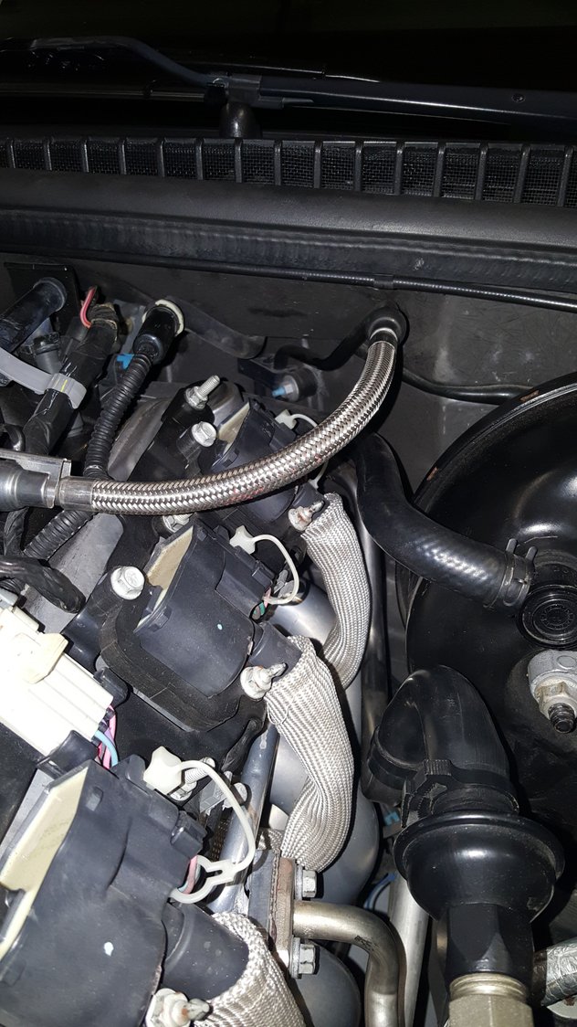

I was doing some cleaning yesterday in the engine bay and had my coil pack bracket off. While putting it back on and tightening the bolt in the very back something metal fell down into the bottom of the engine bay. I have no idea what it was and wasn't missing any tools. Went for a drive afterwards and when going uphill I heard whatever it was fall out but I never could find it. From this pic can you guys see anything missing? Sounded metal and pretty light, like a clip of some sort. Whatever it was came from somewhere real close to that back bolt. Thanks guys

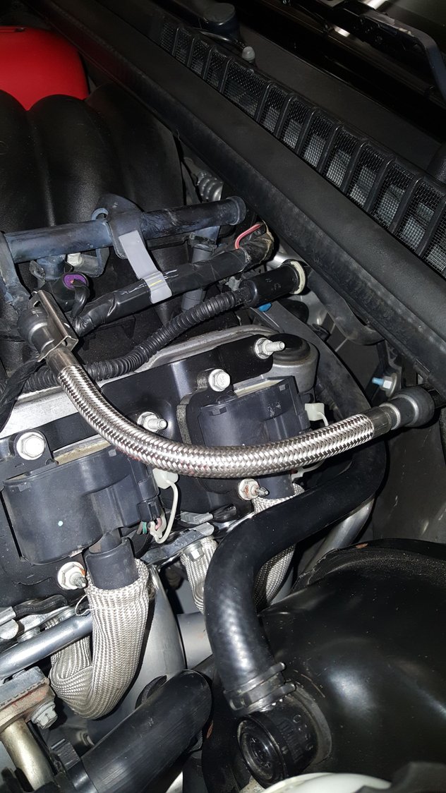

Here is another pic

I see part of the PCV system missing from the rear of the drivers side valve cover. The large grommet on the top next to the rear coil.
The whole PCV system lines probably need to be replaced due to rot caused by all the oil that is sucked through it. I have had to replace three of these over the last couple of years for mine and friends cars.
Gary
Don't know year of your or the OP's car, and can't remember the details, but later years had a different PCV system. My 04 just has a plug where his is, only a bit different looking.

Originally Posted by bwill03z
Here is another pic
Metal clip on the fuel line. Should be one on each end, the one by the firewall is missing. It happen to mine as well, but I've found mine.
GL.
Good eye, I couldn't find what was missing.
GL.
Ah ha! I was getting ready to suggest that. So now the question is how important is that clip?
keeps the fuel line from coming apart, important enough for the factory to use
It shouldn't come apart, as is, but that clip is a safety device, that should be in place.
Can someone send me a pic of what that paticular clip looks like? Or a link to where I could buy a replacement would be even better.
In your picture, there's one on the other end of the fuel line, where it connects to the fuel rail........
Right. I assumed it was the same but I didn't know for sure if it was identical to the fuel rail end.
