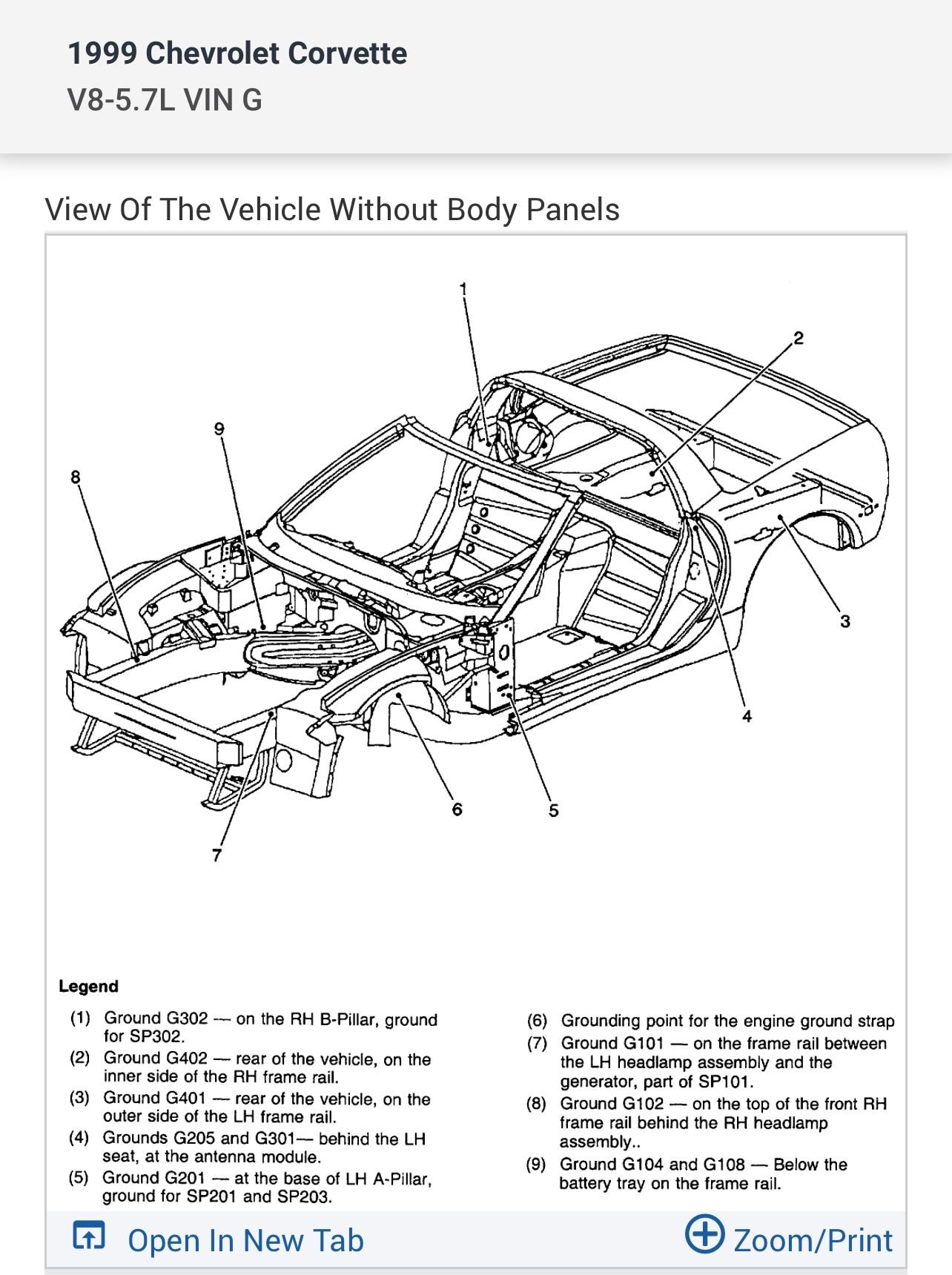

If you have already tried two IPCs, it might be time to evaluate the ignition switch -- provides the power to the IPC, and is known to have contact issues over time -- and also grounds, possibly the ground on the inside of the cabin at the bottom of the driver's A pillar, G201.
This thread,
https://www.corvetteforum.com/forums...locations.html
has some great ground information, including that G201 provides grounding for:
Data link connector (dlc)
Air temperature actuator
Instrument panel cluster (ipc)
Traction/suspension control switch
Driver door module (ddm)
Door latch, driver
Auxiliary power outlet
Windshield wiper motor
Steering column lock
Footwell courtesy lamp, left
Hazard switch
Telescopic actuator switch

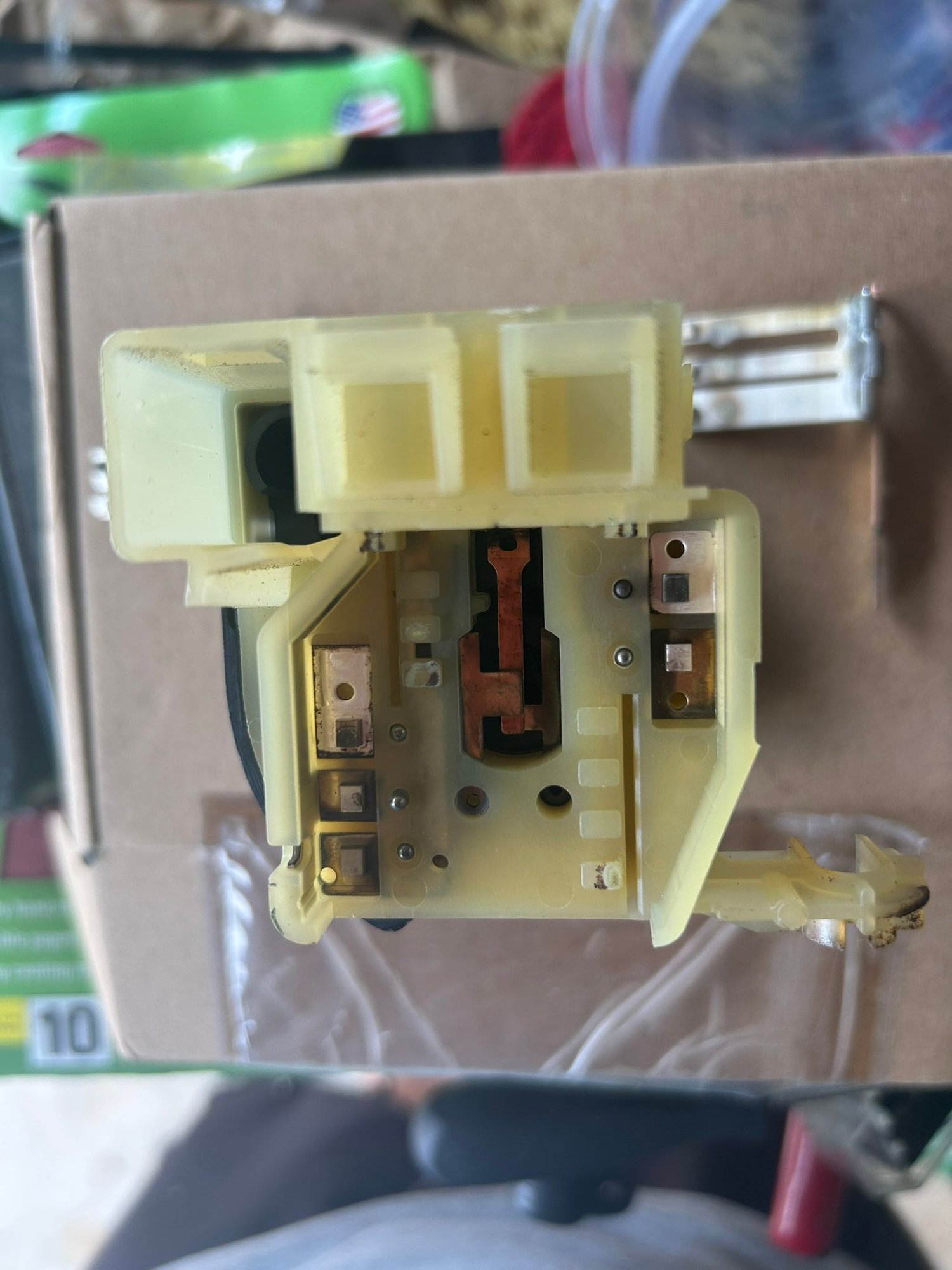

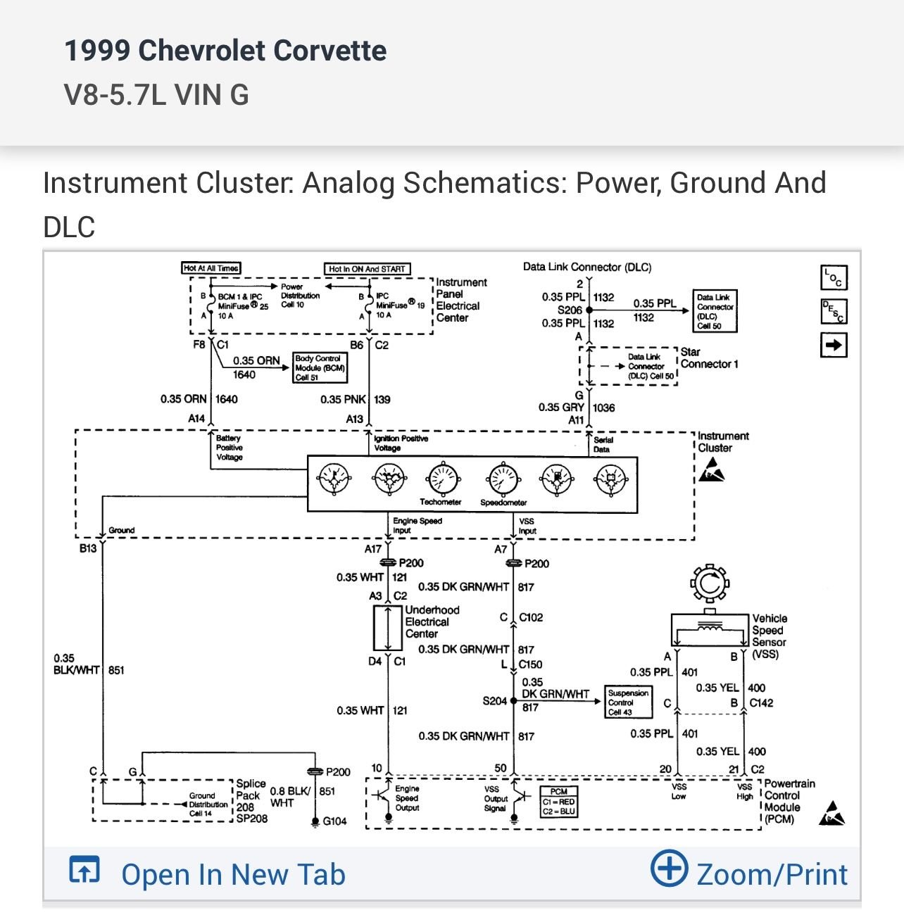

Incomplete update: I, like some other, continue to have both the Driver's Information Center issue and some other IPC issues, including an erroneously low voltage reading for several minutes upon engine start. I pulled the ignition switch and found two contacts that visually appeared quite contaminated. Cleaned and polished all switch contacts, then tested it good before reinstalling. No improvement, dang it.
I have a spare IPC, but since it's a used part there's no guarantee that it is necessarily better than the one in the car. None the less, will try it in the next few days since I have the bezel and knee panel out already, and it will be quicker than trying to get to the G201 (I think) ground. If the IPC doesn't fix, or at least change, my issues, I'll shotgun the ground and the driver's door connectors, both of which have been reported to cause issues.
I'll also see what the maintenance manual says about IPC troubleshooting. What a concept, eh?

Since the voltmeter gets it signal from Ignition 1 Voltage I would connect one lead of your DMM to battery positive and the other to either test point on tip of fuse 19 (IPC) and when you start the car see what the voltage drop is from the battery to the fuse…G104 is the IPC ground which is below the battery tray but it first goes into Splice Pack 208…208 is on right side of IP but does not show a picture…I’d check with ground at the IPC (Terminal B13)…you can use a test light connected to B+ but I would load it with an amp or two…NO RESISTANCE CHECKING OF GROUNDS !!…if you have a decent scan tool you can look at that Ignition 1 data PID…I see no troubleshooting in Service Information related to the IP…only if you have a specific DTC.

Yes/no. I've done both, obviously in error. For the ignition switch I just put back in I tested voltage drop across the contacts at approximately 2 amps current with a power supply, so feeling O.K. on that one. Used a recalled LED headlamp for load (it was handy) but will meander out for a dual filament socket and appropriate lamps for further testing.

So you’ve done a voltage drop check across the ignition switch ??…like I mentioned one lead of your DMM on battery positive and the other lead on either test point on fuse 19…now if you can have someone start the car and see what the voltmeter reads…if you see 5 volts that means you have 12.5 volts out of the battery and 7.5 volts going to the fuse..if you see 7.5 volts on the voltmeter than you have a drop across the ignition switch or somewhere else in the circuit…you can just check the ground with that LED bulb…one wire of the bulb to 12 volt power and the other to the ground connector terminal at the IPC connector… the bulb should be bright if the ground is good…as far as checking a ground with an ohm meter half of the copper strands of the wire can be missing and you will still show good resistance …the ground has to carry the current of that circuit back to the battery…if the IPC draws 2 amps that 2 amps must be able to get back to the battery…many DIY’er have trouble understanding this concept…may be best to take your car to an auto electric shop in your area.
