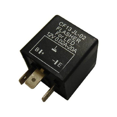

If the problem is with the hyper flash harness I would try replacing just the flasher module rather than the entire wiring assembly.

The hyperflash harness maker sent me a new flasher unit and I swapped that one in. Makes no difference - flashing dash/HVAC lights and panic alarm goes off with fob lock button.
