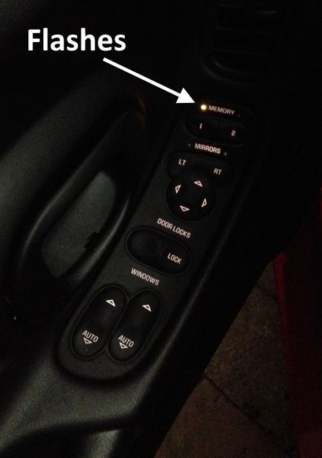

A few months ago I noticed what is probably several inter-related new problems. When I get into the Corvette first thing in the morning, the driver's door side-view mirror position is different, almost as if somebody came up and forcibly moved the mirror during the middle of the night. I doubt there are vandals in my neighborhood, but this problem continues to occur, although not always (as usual). Also when I get into the Corvette first thing in the morning, I notice on the driver's door interior console, the memory light is flashing, even after starting the car and driving, and continues to flash for about a minute then stops on its own.
Starting the car and pressing the Memory #1 button does not result in returning the driver's side-view mirror to previously 'stored' position. I have to use the up/down/left/right adjustment buttons to reposition the mirror. And pressing these buttons results in two of their own problems:
a) initial button press does nothing, second button press moves the mirror
b) while holding down the button, the mirror moves a few degrees then stops; I then must release and press the button again to continue adjusting the mirror position
The passenger door side-view mirror has none of these issues. I suspect there is a bad module somewhere.
Earlier this year both doors' side view mirror's glass were replaced with an aftermarket mirror glass having an illuminated turn signal indicator function. I do not believe that this upgrade work on the side view mirrors has anything to do with the driver's side-view mirror uncommanded position change, memory light flashing, or the adjustment buttons operating intermittently.
Any suggestions? I will be bringing the Corvette to my mechanic this month for other issues, and will add this to my list. Thank you!

did you ever figure out the problem? I am getting the same thing wear the memory light continuously flashes. And when I try to adjust the mirror with the button, the mirror will go for about a second. Then i must release and press the button again and repeat until I get the mirror in the right position.

I had this exact issue and was able to solve it by replacing the mirror motor itself. You pull the mirror off and cut the motor wires out and then wire them into a new one. I also had a trouble code for mirror motor (cant remember what the code was, but could aid troubleshooting)

The only reason im skeptical about replacing the mirror motor is because I am not throwing any codes. Might just start with the mirror motor if its not too expensive though. Had this problem for months and couldn't find a definite answer on the forums.
