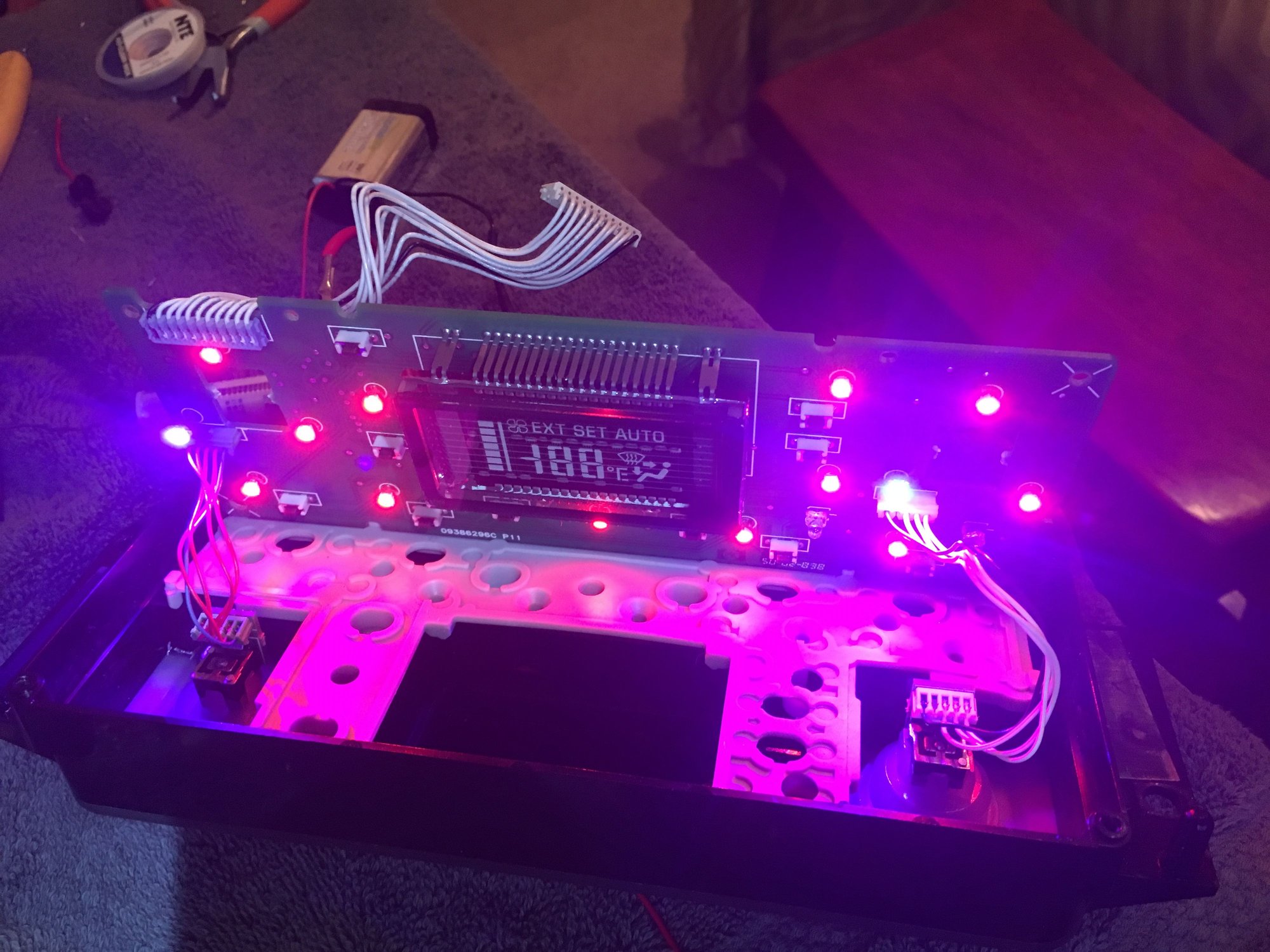

Working on my 2000 with dual zone climate control. I soldered the 8 pieces to fix the dim display. While I was in there I decided to replace a few of the burned out bulbs. Now, most of the lights don't work and the passenger side temp adjuster is no longer working. I believe it is fubar.
Does anyone know how to power the lights on the control without plugging it in the car?
Thanks in advance

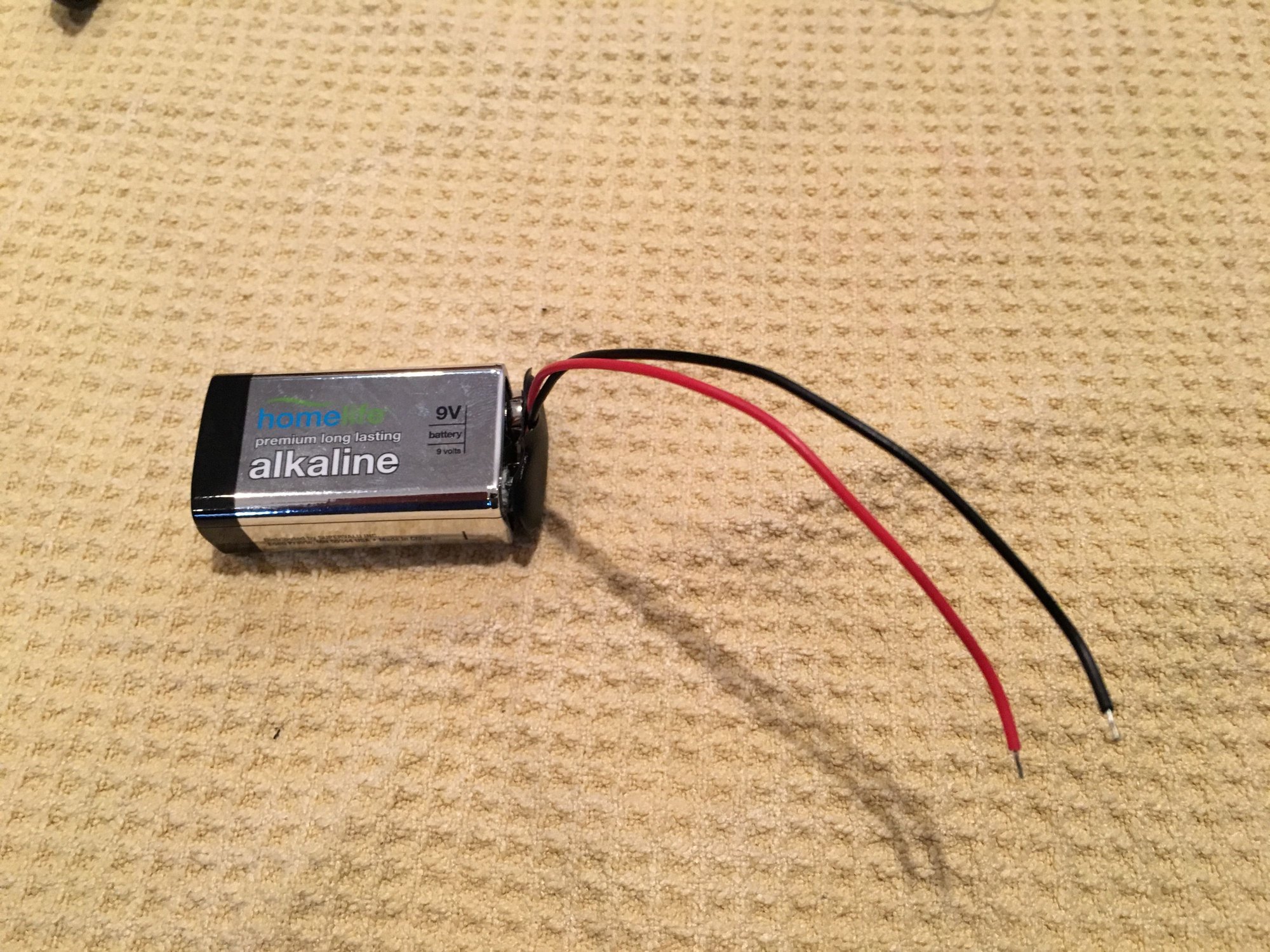

Just hook it up to a 9V battery

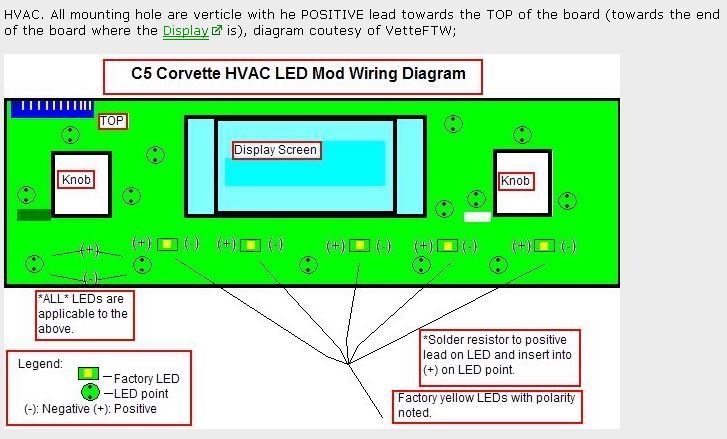

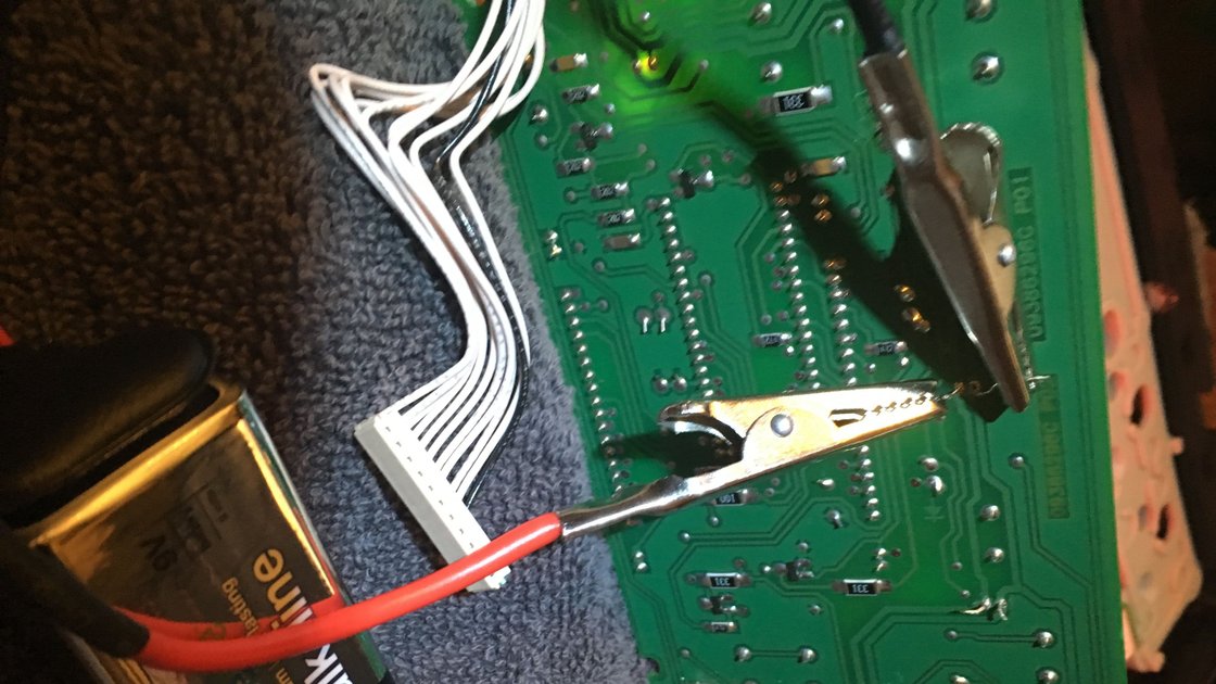

Positive to the back of a positive lead, negative to the back of a negative lead, in the light schematic above.

This pic is twisted, but you should get the point.

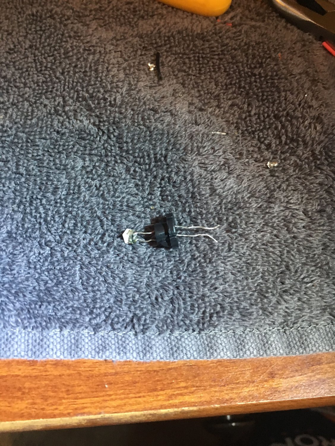

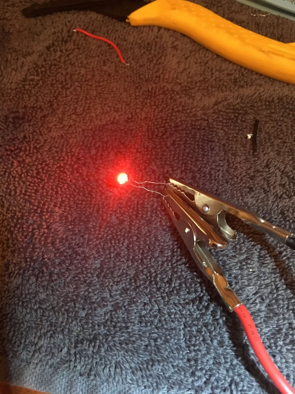

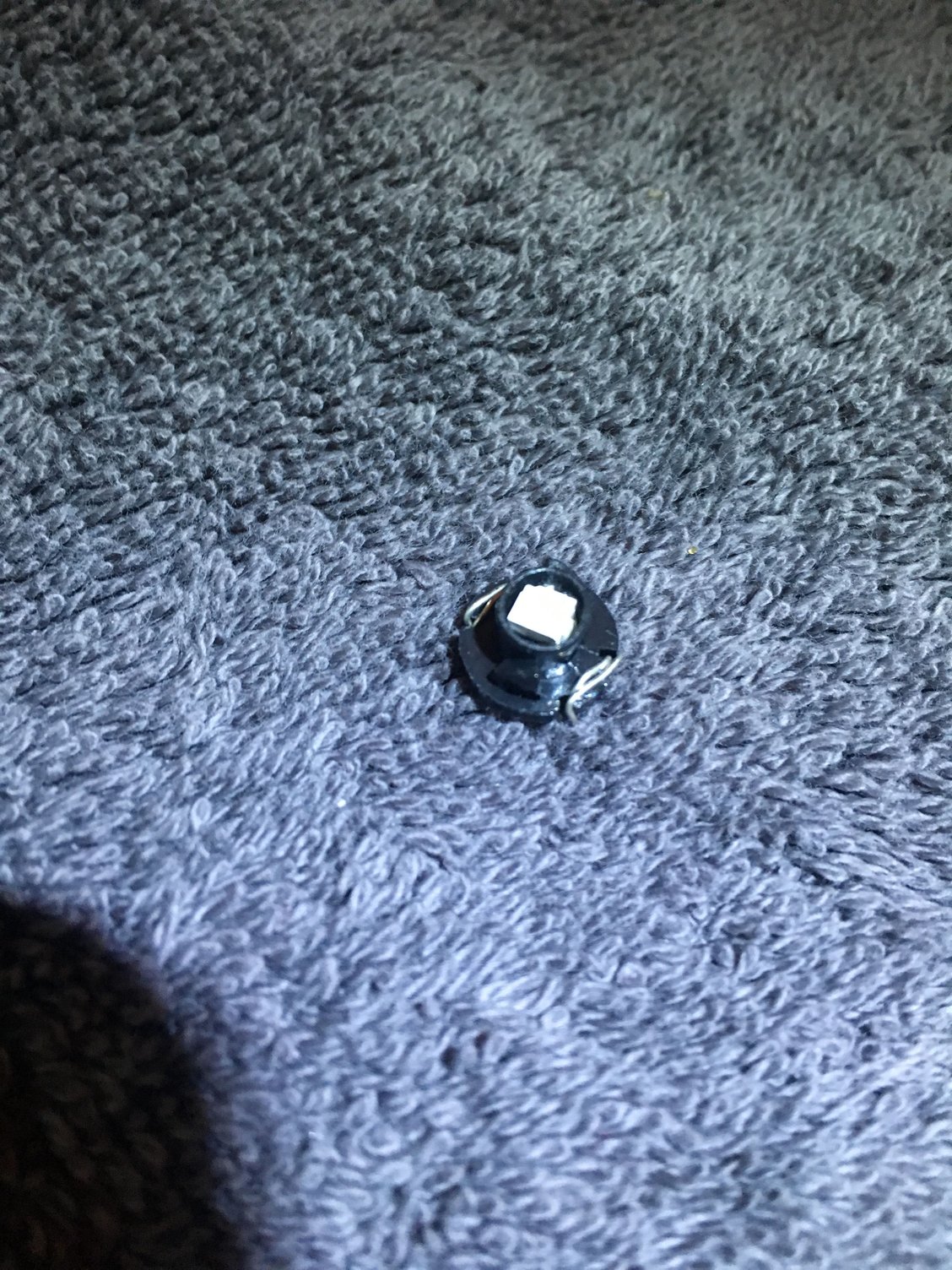

I bought T4 neo wedge LEDs and took them out of their housing (below).
