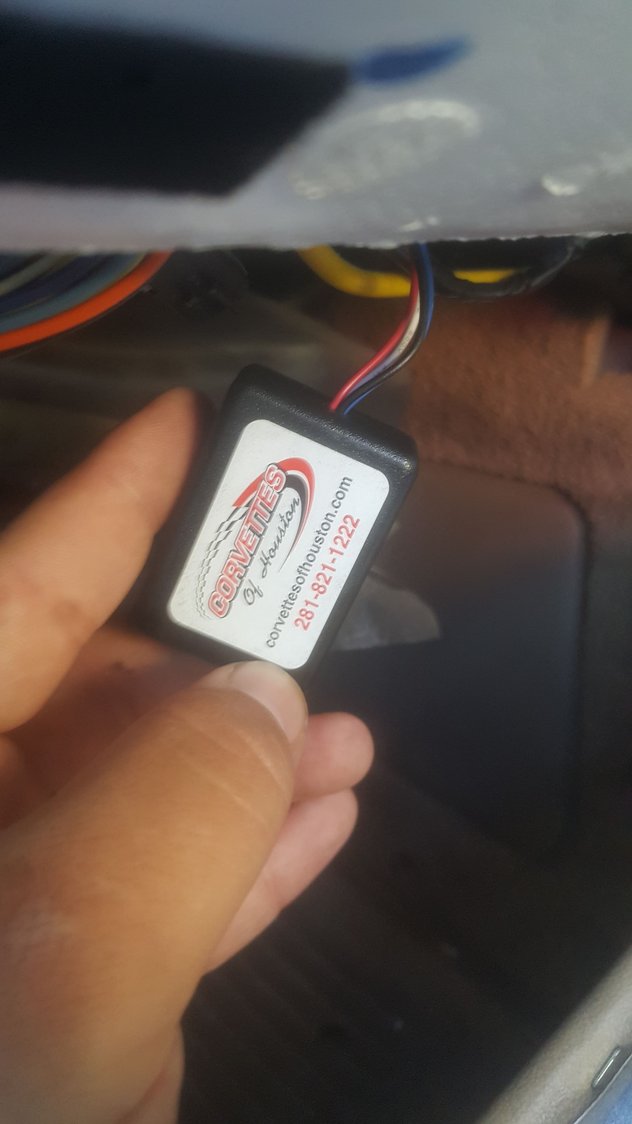

Yeah he's been a Chevy mechanic for over 20 years and he's pretty sure it's the ignition so I'm thinking it's that.
Side note, I found this under the steering wheel, do you think it's the column lock thing?

IF,,,,,,,,,,,,,,,,,,,,,,,,,,, The security light is FLASHING, it will never start. You MUST resolve that issue FIRST!!!!
That involves the VATs system and the sensor on the end of the ignition switch reading the resistor pellet in the key.
If the BCM can not read get the proper resistance/voltage when the pelet is in the system, the engine will not crank.
You should also read the DTCs using the internal DTC reader and that will tell you if the VATs is having an issue.

Well that's what was weird. The first time it did it, the security light flashed. Ever since then it hasn't. And it started after simply jiggling the yellow wire on the ignition. So I wouldn't think it's the VAT system. Especially cause I had tried both keys I have and nothing changed. I did pull the codes and there was nothing related to the car not starting. But at least it starts for now.
