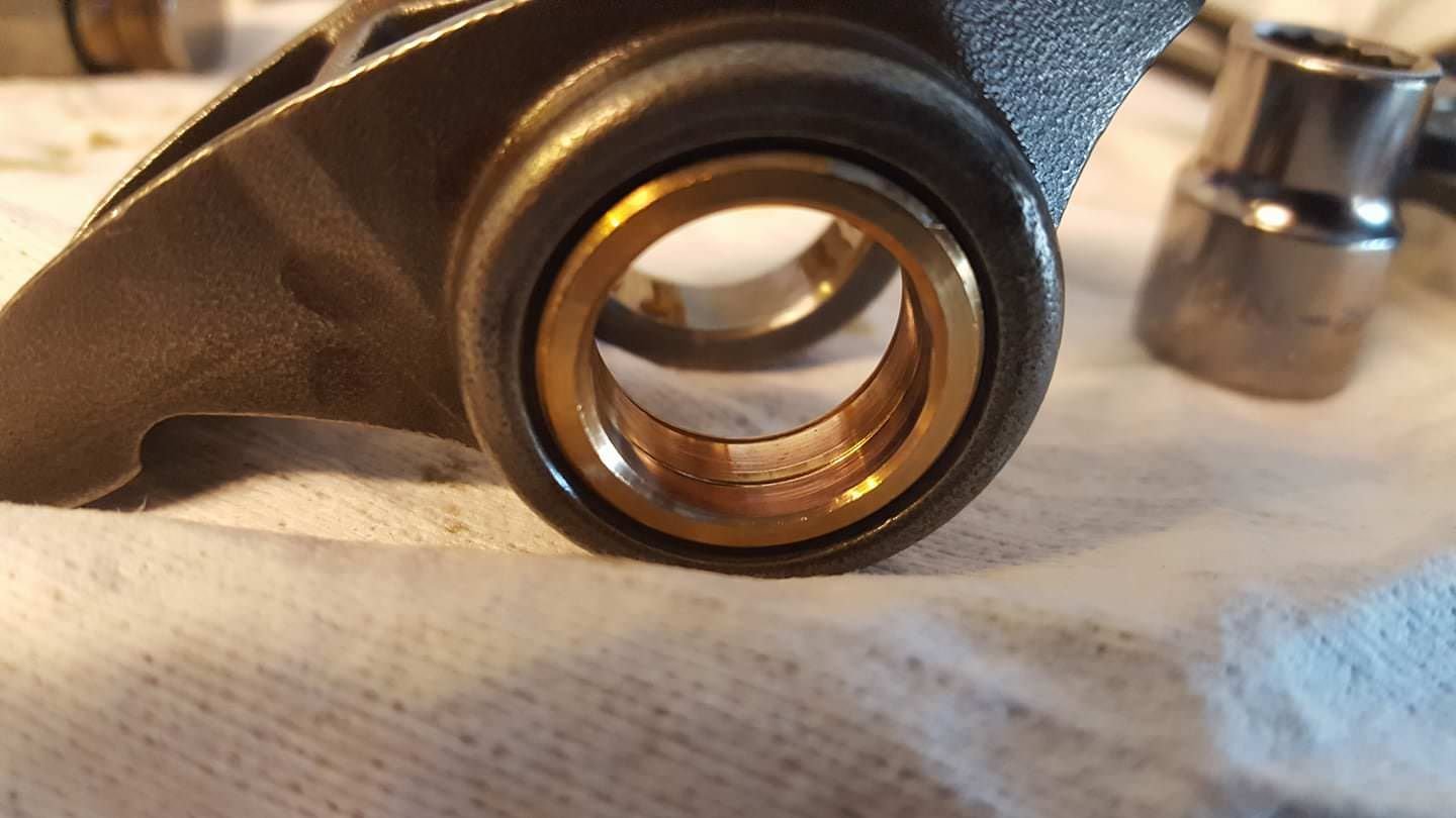

maybe get in touch with straub and they could give you a better answer... I do know they have changed the design slightly since first releasing their bronze bushing trunnion kits, this is what mine looked like when I got them about a year and a half ago
