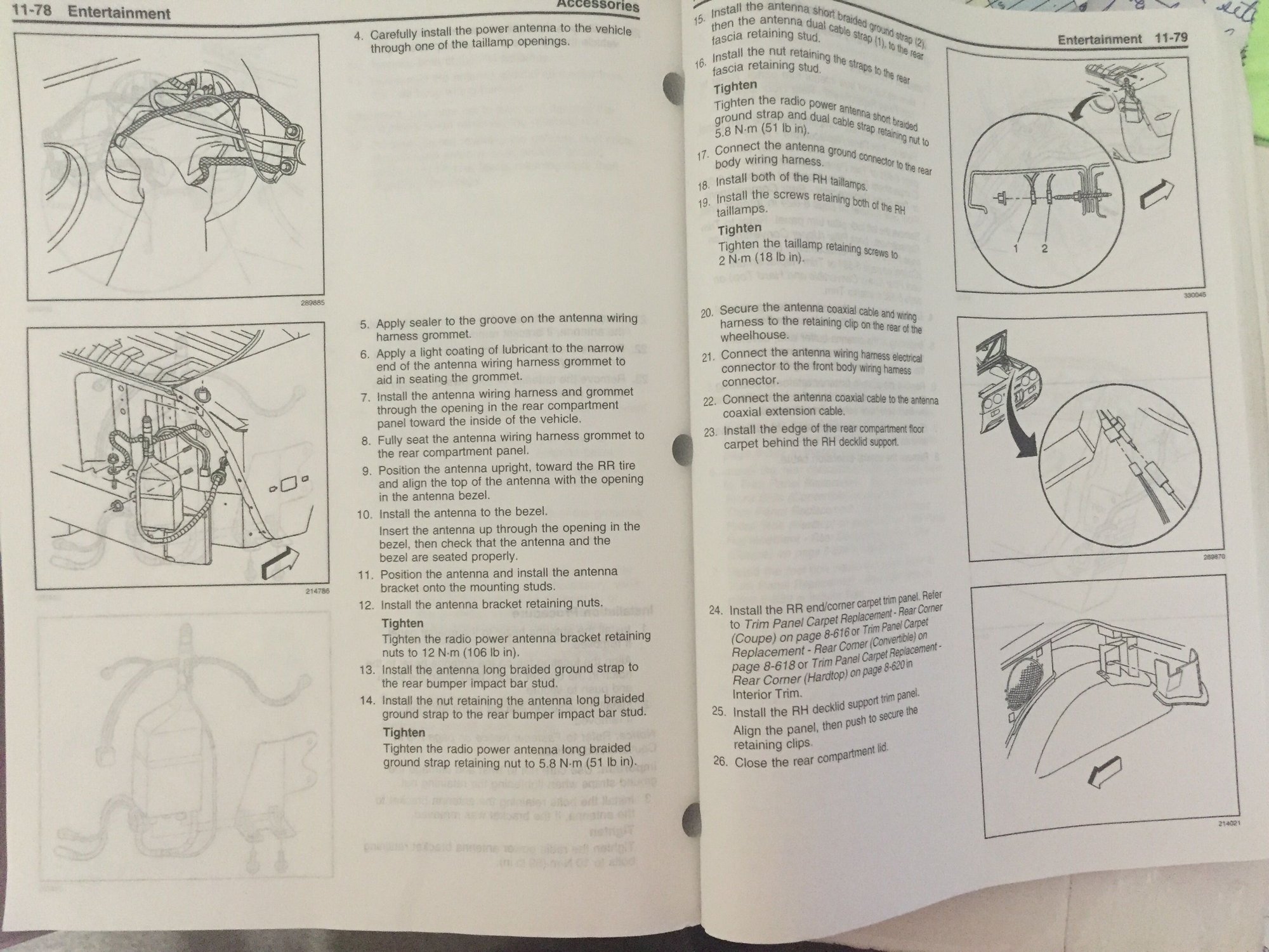

Can anyone tell me how to remove the Power Radio Antenna from a C5 (98 Convertible to be exact) I've tried searching here on the forum, couldn't find anything.
I've tried removing carpeted panels in the trunk couldn't get to it. Tried removing the right side muffler, no way to get to it there. I've removed the right rear wheel and the inner fender lining. I could see it, but couldn't get to it.
I hope I don't have to remove the rear facade to get to it. Does anyone know what I'm missing?

Originally Posted by 8VETTE7
You will need to pull back/remove the right side carped panel to disconnect some wiring. Then you need to remove the two right side tail lights. Need to do some additional disassembly of the antenna assembly in order to get the module out.
I will post pics from the shop manual that contains sufficient detail to get it out without damaging anything this evening when I have access to my shop manual.
8VETTE7,
Thanks for posting this, I was baffled as to how to get to that antenna.
Thanks Again,
Rick
