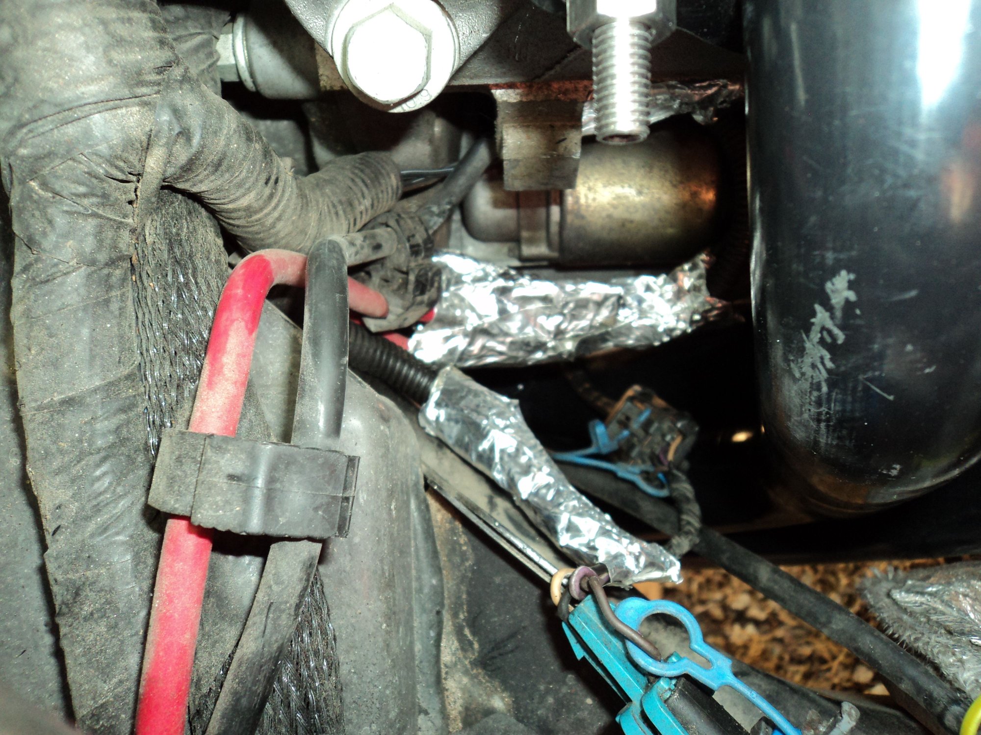

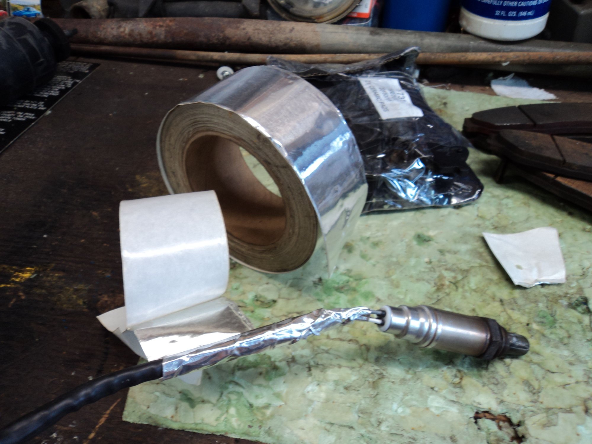

When you install your Headers -something to consider...... There is lots of info on the forum about wires getting burned near the Headers, so this is what I did...
You can get the heat/ tape from local hardware stores....Do both sides..

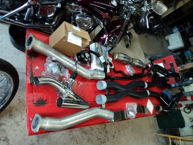

There are a lot of good headers systems out there, some $$ pricey. I went with the
HINSON Motorsports, Inc
4675 Appaloosa Drive
Birmingham, AL 35210
205-909-9402
www.HINSONMotorsports.com
Good performance and sound with just a tune, no other performance stuff.
I also put my rear o2s up front using "Racetronix wire plug for rear to front adaptor..

Carefully route your O2 wires, I would heat wrap them. I also used P clamps attached to the car by the trans tunnel heat shield bolts to hold wires up and away from the headers. Headers vary in placement of the O2s which will change how you can route things.
I also used tie-straps to hold the wires back out of the way.
