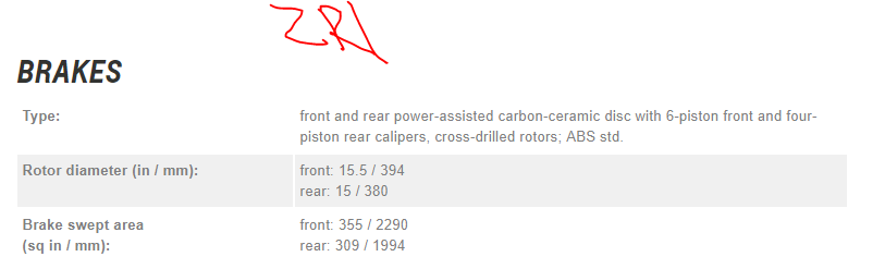

C6 ZR1 caliper is a bolt on solution, and AZ sells remans for like 150$ a corner.
The problem is the rotor!

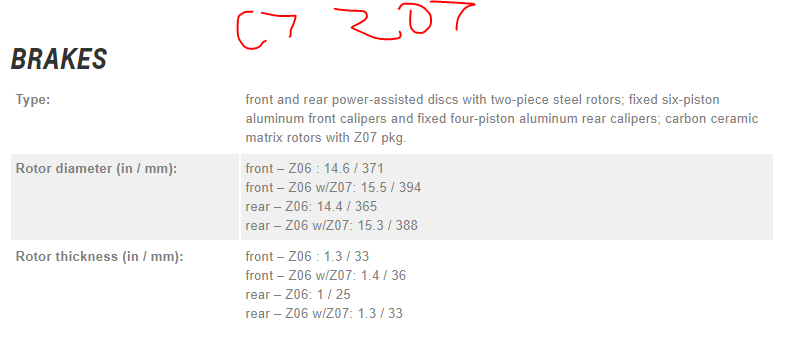

15.5" diameter is hard to come by, and expensive. I thought the only option was the zr1 CCB or one of the aftermarket iron replacements.
c7 z07 Iron rotor is ~$400 each (front, ac delco) (cheaper on Rockauto it looks like)
I need to see if Autozone can special order the calipers for me
The c7z07 rotor, on the other hand could also answer my prayers for a solution with the GT350R caliper.
