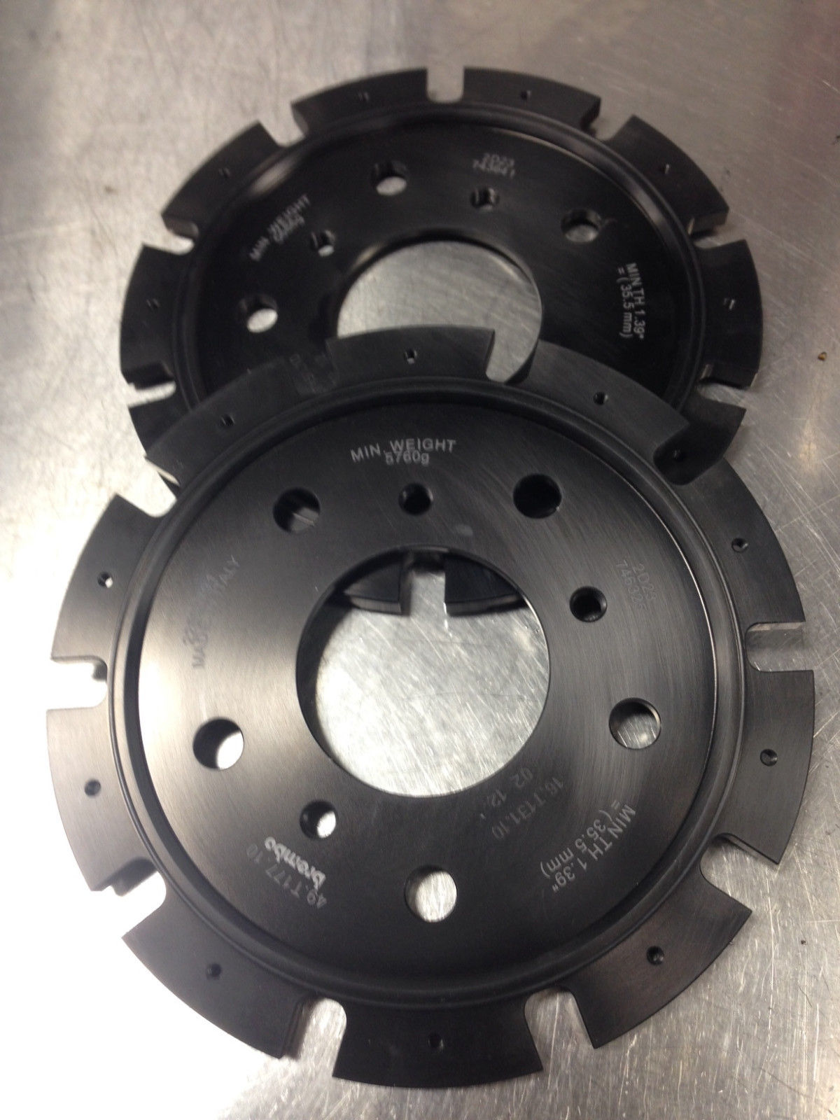

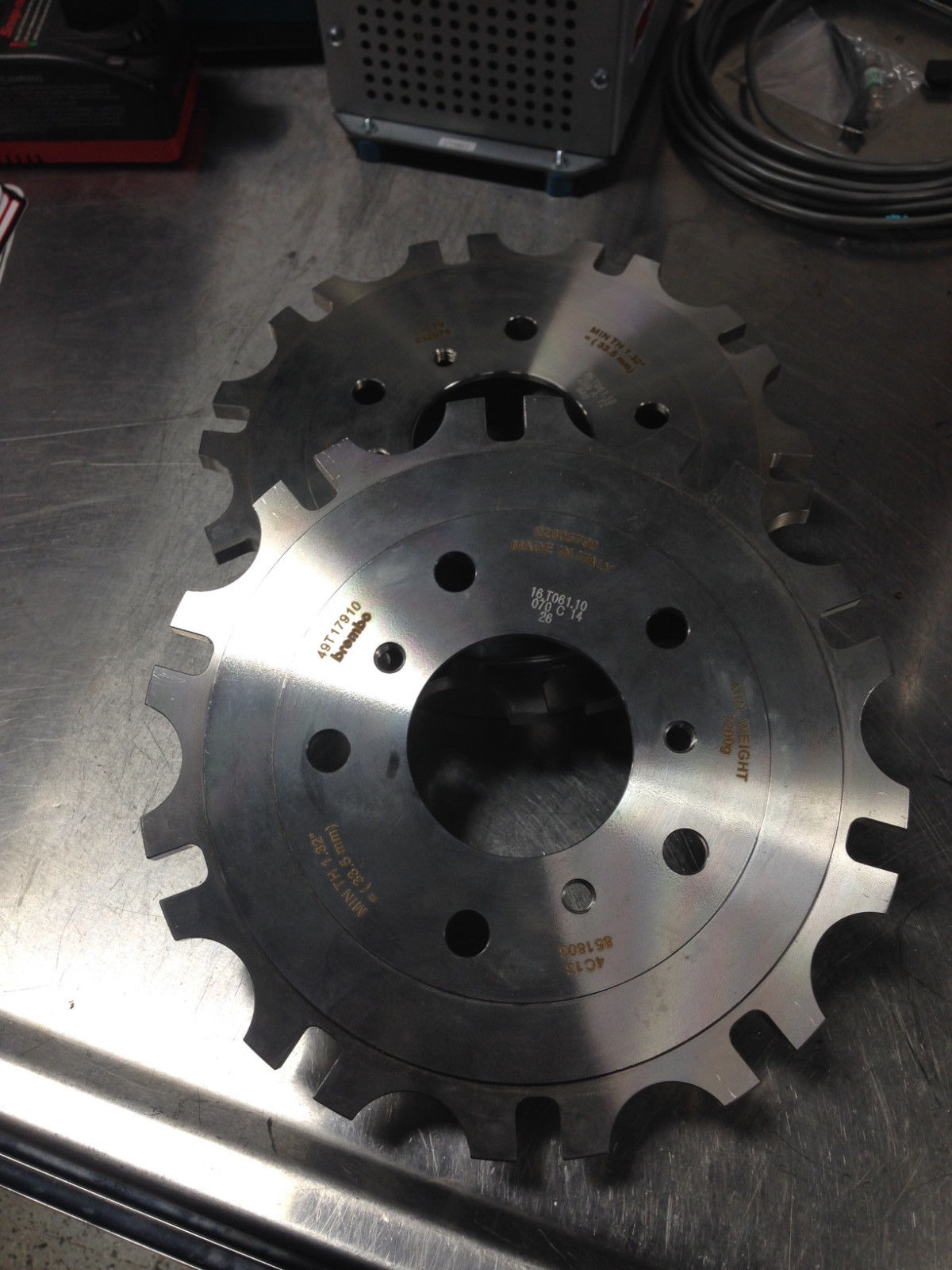

Things have just taken a major turn
Just ordered Zr1 rotor hats, dirt cheap too
Although I feel like I've stolen this thread with my ramblings, so I'll contain the rest to my thread here:
https://www.corvetteforum.com/forums...-the-fact.html
