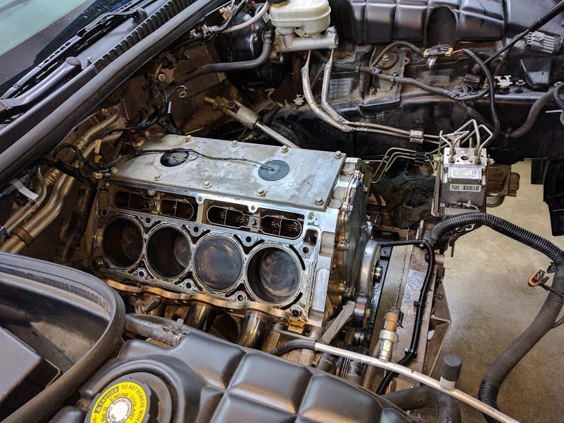

Old Jan 11, 2018 | 01:52 PM
bigmackloud's Avatar
bigmackloud
Joined: Feb 2013
Posts: 535
Likes: 92
From: Raleigh NC
hahahaha, sorry you're right. the mental picture in my head was the bare block like pictured above. that's what I get for trying to play on CF forum while I'm "working" too. sorry for the confusion, as you were.
