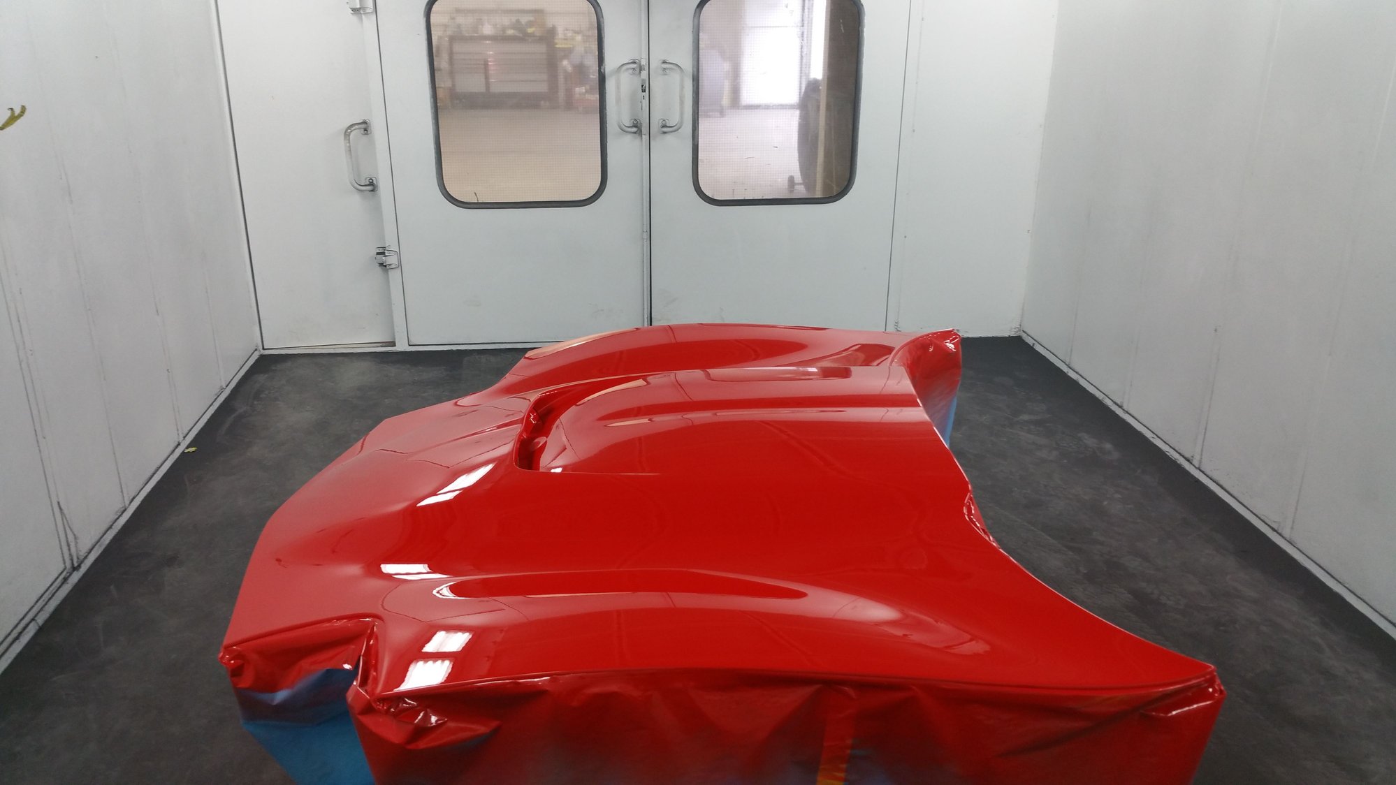

Originally Posted by dork
Automotive paints don't "dry" anymore; that technology is outlawed.
Really? so the heating process that was done after my hood was painted was a figment of my imagination? I need a drink...thanks
Heated paint booth
Heated paint booth
Heated paint booth
Not to worry. Your ignorance is pretty common. "Heated" only means to keep the ambient temperature above (generally) 60-something degrees. Catalysts don't require heat; to allow an environment where the paint will flow better requires a temperature suited for the specific resins/"solvents" being applied. It's not to force-dry the coating, it's to keep "room temps" at 'room temp'.
Ifn someone wants to "FORCE" dry the coating by raising the temp as your picture shows, that's their choice. But there's no need for it at all to be above comfortable temperatures. The catalyst will work anyway. Pot life for catalyzed paints hovers around 4hr. That is, most catalyzed coatings would be ready for handling overnight.
No journeyman painter would let a bodyman install a painted panel the same day; there's just no sense in it. Sure, some hacker might do it "under the gun" but as a common industrial practice, no. So 'forcing' the paint wouldn't gain anything whatsoever if the panel is to be installed the next morning anyway.
Someone who's raising the temperature of a booth after applying catalyzed paint is applied in the presence of an onlooker is just performing their best dog and pony show.
