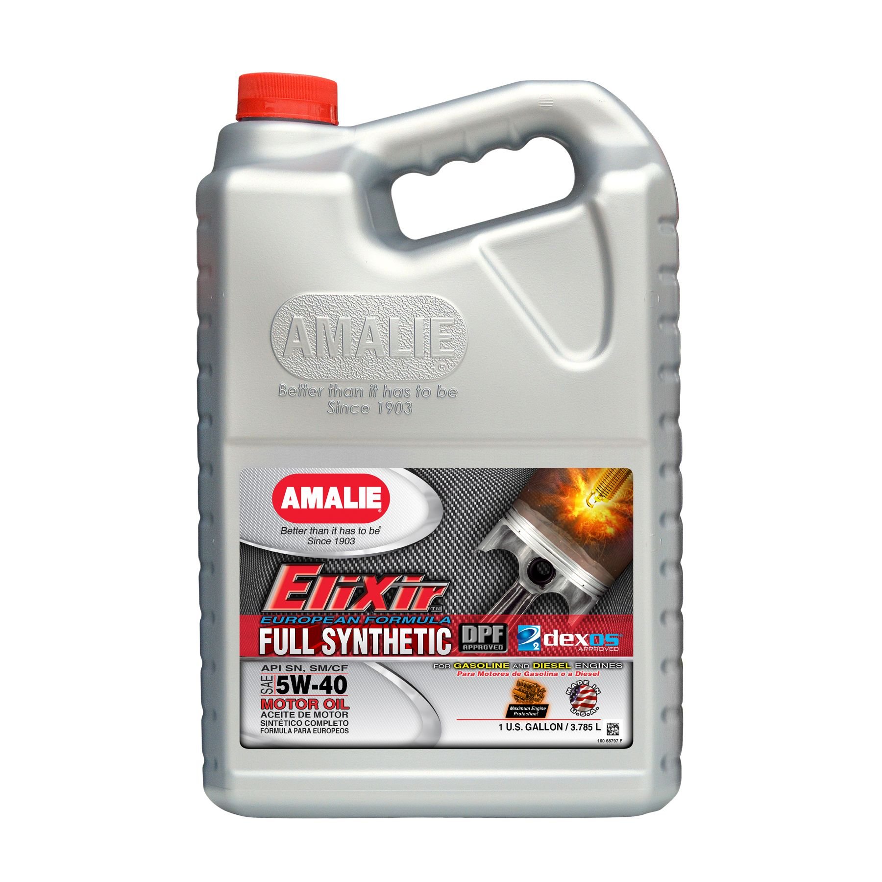

This is the oil I use, good price and free shipping. My personal Blackstone Oil reports show it outperforms Mobil One. My car is a C5 Z06 and GM specifically requires Dexos and this oil has it.
https://amaliestore.com/product/amal...-5w-40-dexos2/
