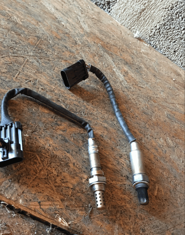

Here is a photo of the sensor on the passenger side .
I replaced both sensor last year and installed new type AFS 75 from AC delco
(left one)
