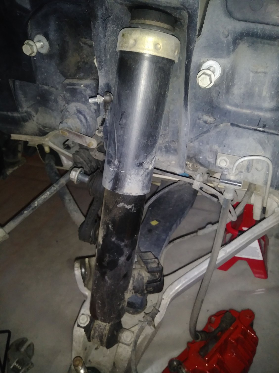

so i took this picture last night maybe you can tell me what i have here lol. im looking to upgrade the shocks but was curious about what the electronics are for!!

Those are definitely F45 shocks. Unlike Bill, I have not had a bad experience with them, and rather enjoy the ability to change settings in a daily driver. Comfortable cruising on the highway, tighten up for relatively high speed cornering.
I did change out the sway bars to C6 Z51 sway bars with metal endlinks. It tightened up the steering feel and reduced body roll in turns while not having too much of an impact on the ride. If you're running base C5 tire sizes, I would recommend C6 Z51 sway bars. C6 Z06 sway bars are for running wider tires from what I have read.
