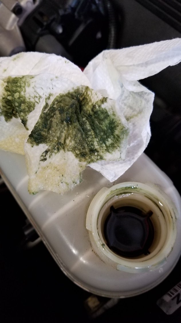

What is this green crap in the brake fluid reservoir? Looks like green grease. I guess this is the crap plugging the EBCM you told me about. I am scheduled to have oil and brake fluid changed on Tuesday.
What is the best way to exercise the EBCM to get that gummy stuff moving out of the ports? should I do this prior to having the fluid changed or will the fluid change clean it all out?

that is from lack of flushing the fluid... make sure the shop does a complete bleed from the calipers and don't just change out the fluid in the brake master or the new fluid will quickly become contaminated again... if it were my car I would probably buy an extra pint or 2 of fluid to make sure I got all that crap out

microbiological growth. basically algy. too much moisture in the brake fluid

You should do a complete flush and then repeat it regularly. suck everything out with a bulb and get a rag in there best you can. If the shop has the proper diagnostic meter to do an electronic flush of the ABS, it should be done. I went to a guy who had the tool, but didn't know how to use it. Choice two is to find wet grass somewhere and slam on the brakes several times to activate the ABS, which circulates the fluid. Jeeze, that fluid must have absorbed moisture for years. I'd also be concerned about cross-contaminating the clutch reservoir right next to it, and give that a good clean flush--at least the master. If the clutch master is also contaminated, go to the racing forum and look up the "modified ranger method" to flush the clutch slave and line. You really should do this yourself, as it's going to take several times probably.
