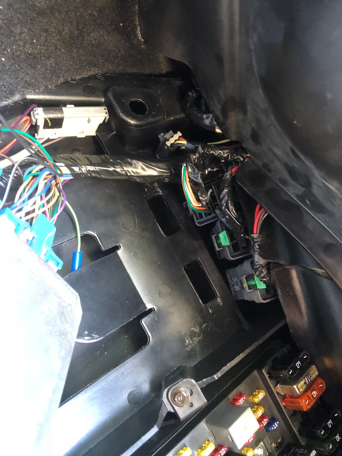

So, I got my kit today. I feel like I followed the directions to a T with the exception of not unhooking the relay (because there were 3 units where there should have been 2 and all were the wrong color and based on the directions this seemed more a recomdation than a necessity). it took a good hour plus (unless your 5 ft tall these are pretty hard to get to) and when I turned the key, ‘wait 10 seconds...’ ah, NO! I went back and did the brown wire thingy, turned the key and....NO! I went back and looked through the 3 relays (pictured) and after removing some tape determined that one had the right color wires, so I unhooked that and turned the key...and still nothing. Outside of the directions the only thing that I can think of is the passenger fuse 23, which is missing (i’m guessing I removed it last week and misplaced it). Do i need this fuse in? Could this one little thing be causing the error to still show up? Could one of the wires have gone in the wrong pay?
I’m not going to sugarcoat it, i’m not technically / mechanically inclined so if there may be a way to troubleshoot, feel free to dumb it down 😉
Call Richard at Compliance. Very helpful and will walk you through the installation.

I'd too would advise giving Richard of Compliance Parts a call if you need help troubleshooting (855) 565-8388. I spoke with him before buying the LMC5 and I found him to be very knowledgeable and helpful! By the way- while not a mechanic, I can follow instructions and I work on watches as a hobby (can take one completely apart, clean, repair and put it back together again) and it took me quite awhile to install my device. So my hat is off to anyone who can do this the first time without reading the instructions a couple of times and get this installed in under a half an hour. My car had only the first recall performed (computer reprogram) and my wheel locked, so I had an extra step to perform. Most of my time spent was due to the access to the car's computer being cramped. Also some of the connections can be a bit stubborn to release (at least that was my experience). .
By taking my time, following the instructions to the letter, I have not had the "Pull Key Wait 10 Seconds" error message.

Install of the LMC5 today took me almost exactly 20 minutes, from arriving at my car in the dealer's parking lot, to turning the key the first time after install. If you read through the instructions once before, then follow them during, it's very easy. I'm good at these types of jobs from my car stereo days, but anyone should be able to handle this.
No problems since installing the LMC5! I did not do the brown wire mod.

Make sure to read all instructions as the brown wire mod is not shown. Call Richard at Compliance if you have any questions.

Make sure you use the brown wire. Mine still stalled until I connected the brown. No problem since.
