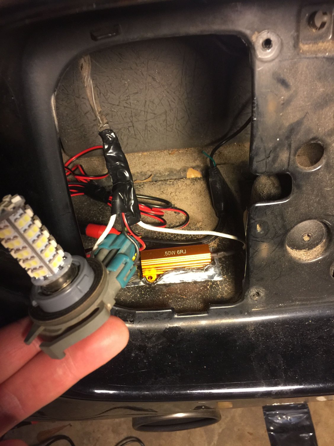

Originally Posted by OleStraightStick
So I wired up a resistor into the reverse bulb and so far it works perfectly.. Jim (Bravo1) had an awesome idea and it worked I will provide a few pics Incase it helps anybody in the future.. can’t stand when folks don’t follow up on threads..
I just noticed that it seems you used double-sided tape and attached the resistor to the black foam.
Word of caution: it's a 6-ohm resistor, so it is dissipating around 33w (14^2 / 6) when reverse is engaged, and it might get hot. On the other hand, it is a 50w-rated resistor and since reverse is not usually applied for long periods of time this might not be an issue. However, to be on the safe side, it might be better to attach the resistor to a metal surface using screws to make sure heat is safely dissipated.
I agree ! those resistors can get very HOT, I mounted mine to metal.
Attachment 48264815
Attachment 48264816
Attachment 48264817
Attachment 48264818
Attachment 48264819
Attachment 48264820
I just wanted to thank you guys for this post! I had the same problem this weekend with the LED bulbs. Resistor on order. I should have known from my HID install, needed resistors to make headlights go down when shut off. Thx again for the follow up with problem fixed! 👍 Ken

Just an FYI,
When using those resistors they should be screwed to a metal part of the frame.
The resistors can get VERY hot in use so if mounted to metal that helps dissipate the heat produced.
