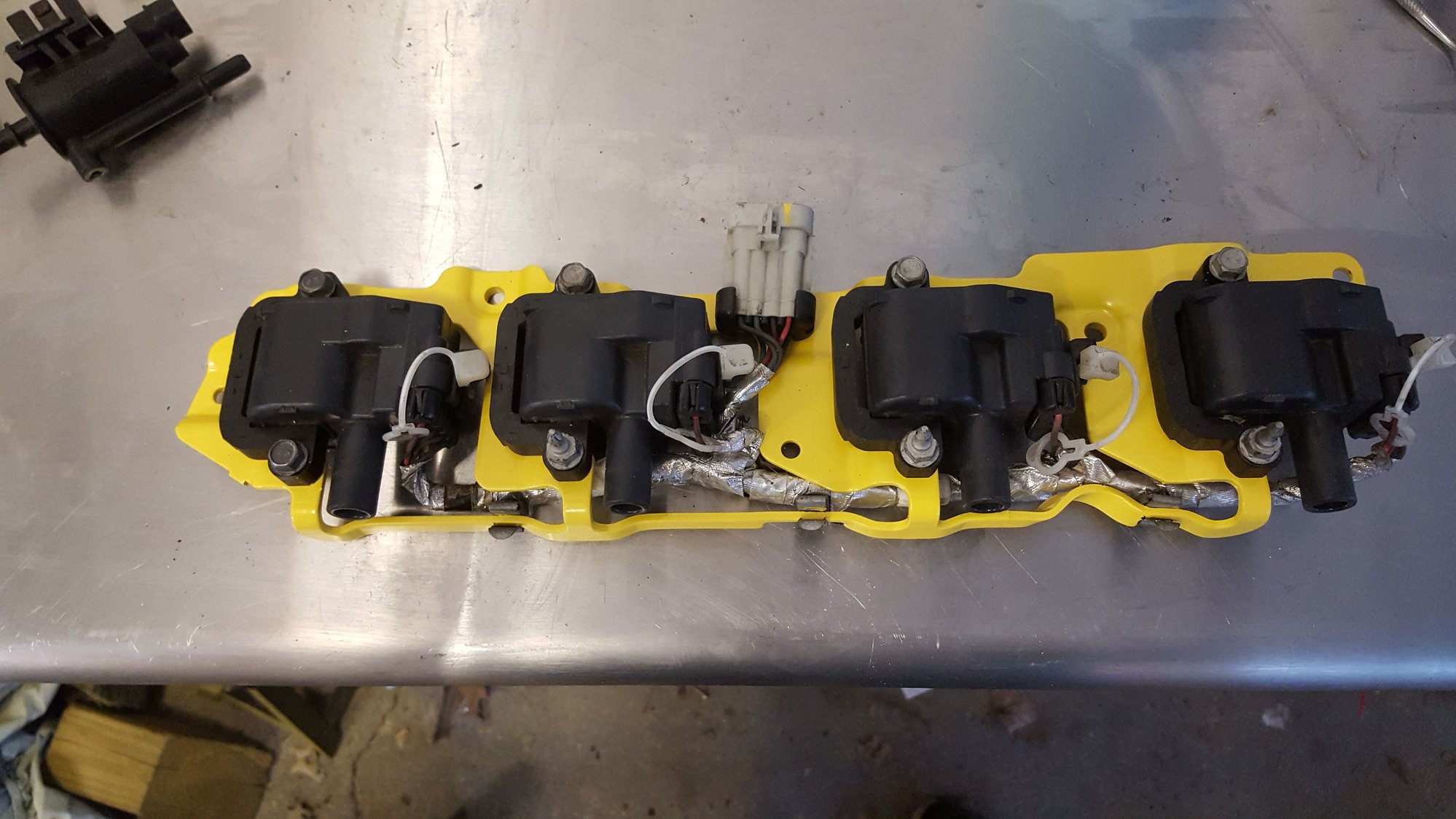

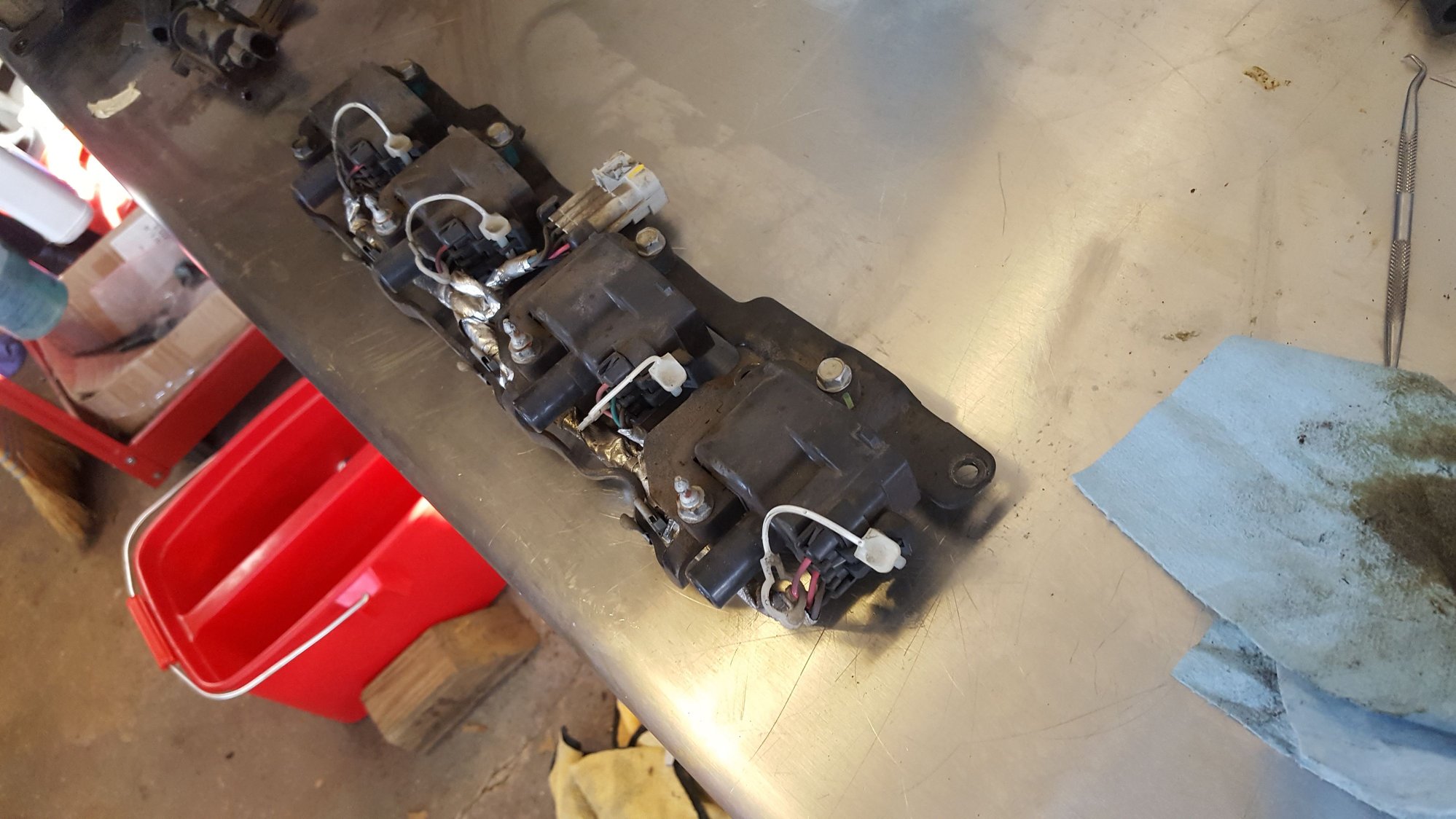

So while I was in the process of cleaning things, I decided to paint the coil brackets. I lucked out and found some engine paint at the pep boys that is close to MY color.
I'm not sure why I did it. But let me know your thoughts. Good or bad.
Before cleaning
After cleaning and painting

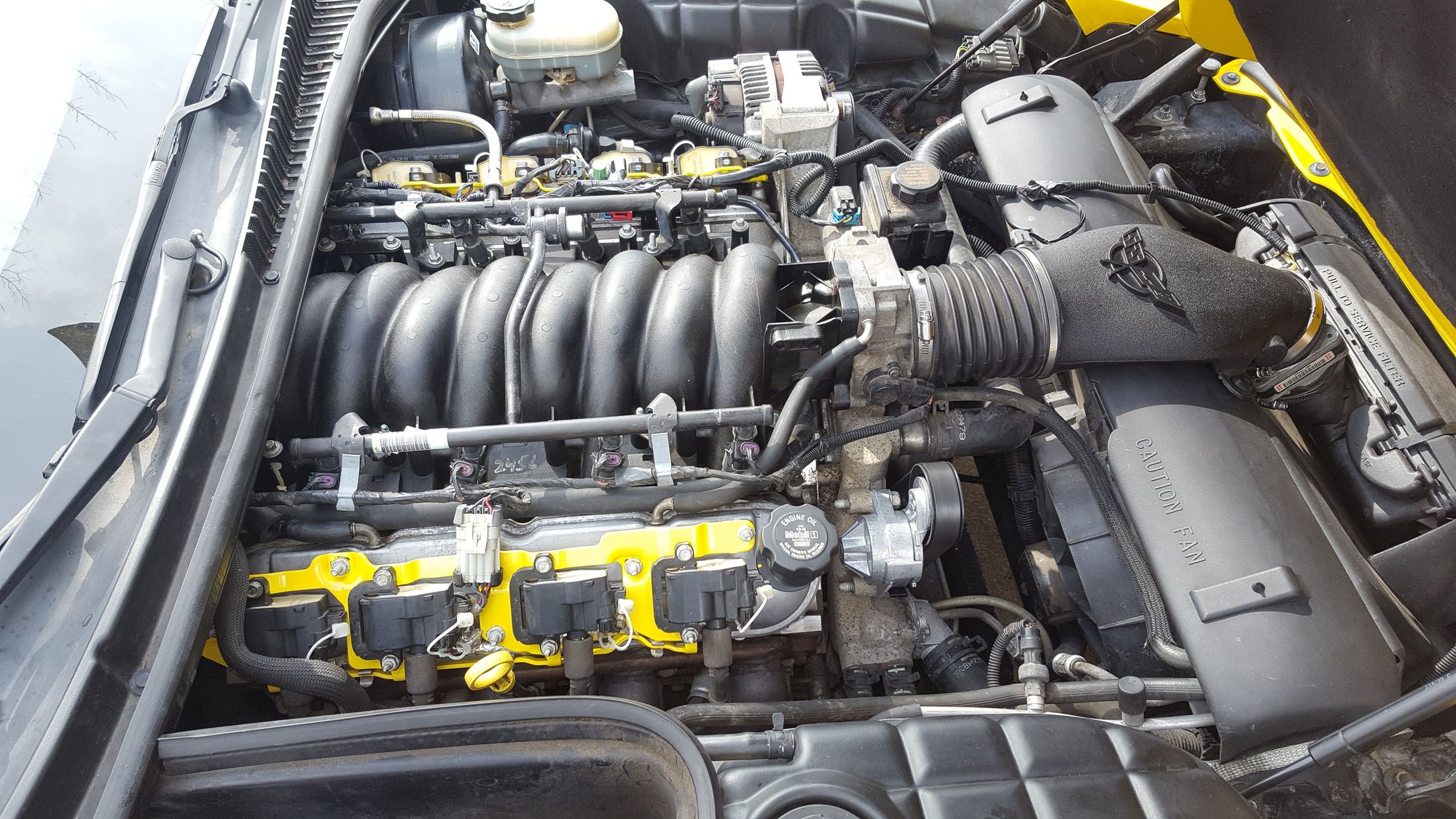

Well, I got it back together this morning. It runs better than ever. I'm guessing there was probably some vacuum leakage in the intake and I did find a PVC elbow that was broken. A few observations for anyone doing this job. I determined it was impossible to attach the rear vacuum line under the maf sensor. If you have a trick, please let us know. I bought a 45 degree elbow and about 4 inches of vacuum line and extended the whole thing. This allowed me to connect it and put the intake back on. Time will tell if it causes a problem. The EVAP tubing is extremely brittle. Be very careful removing the lines. I broke one removing it. I have to believe the PVC valve is an often overlooked piece. It's well hidden. Mine was awful. It wasn't completely stuck, but it hadn't been replaced in years.
The biggest plus and now issue is my oil pressure gauge works. The bad news is, I'm only getting around 20 and as low as 17 lbs at hot idle. It does go to around 30-35 when driving. I plan on swapping the cam next winter and I will do an oil pump at that time. I hope that raises the pressure a little.
While intimidating to look at, it is not a hard job at all. You can do the whole thing in a day. I took my time and replaced a few other things while in there.
Here are some after shots of it back together.
