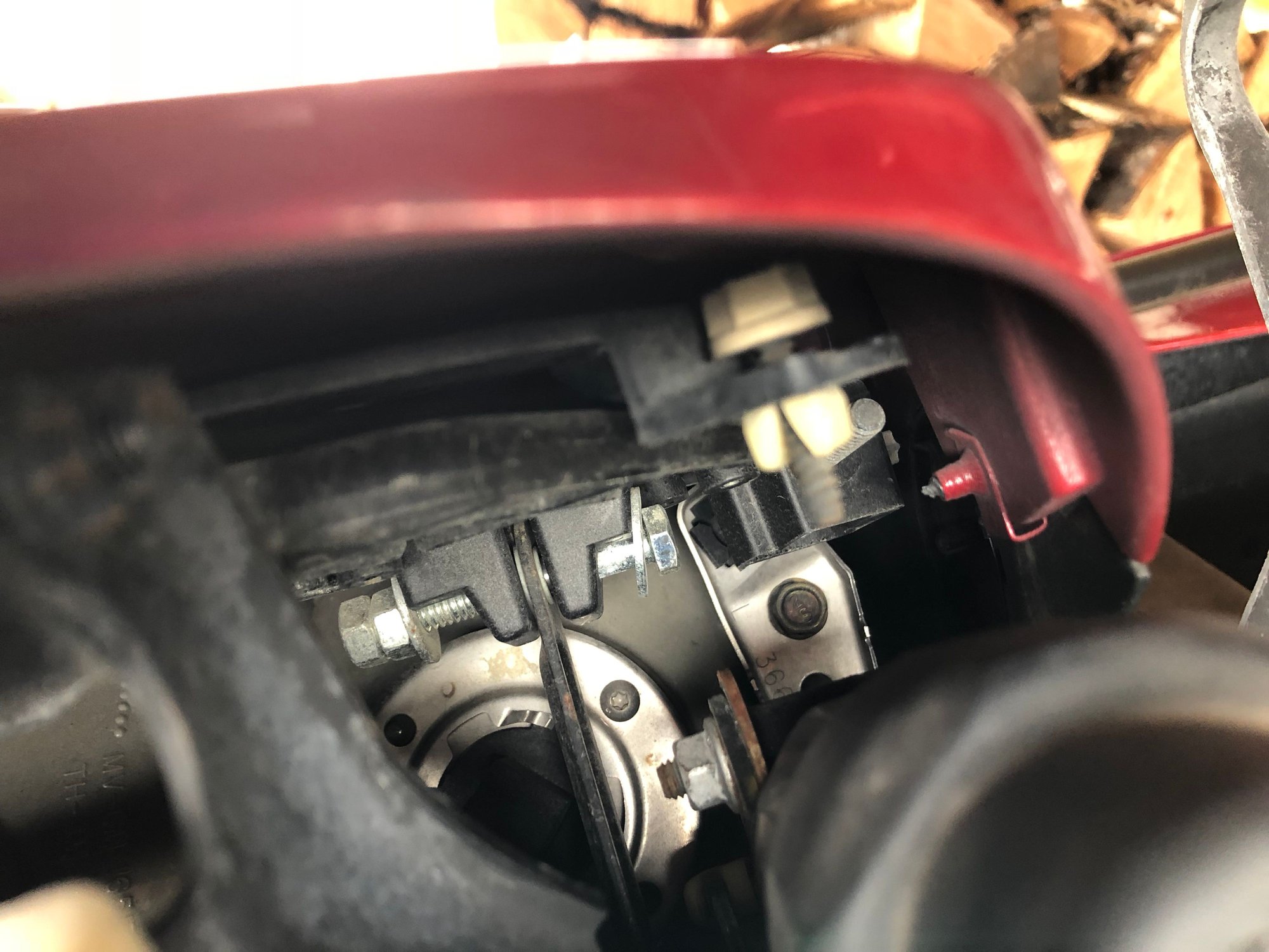

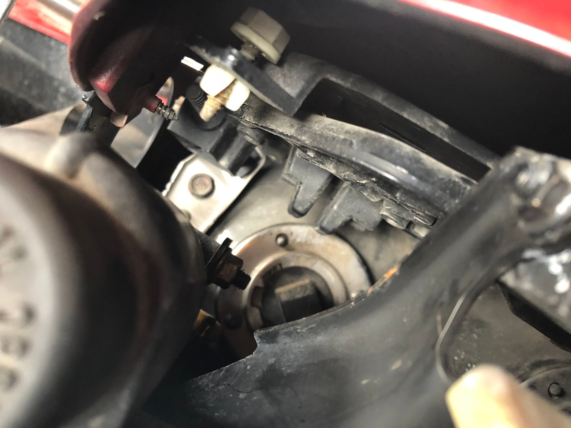

Apologies for the delay, just now got a chance to work on it.
Driver side headlight bolt
Passenger side

Thats.... not factory.
Whatever is holding up the pivot arm on the driver's side was likely the same on the passenger side, and either that worked itself loose or was stressed to the point of collapsing. I don't have a picture of it immediately but if memory serves me right the last time I serviced my headlight motor it is a combination bolt w/ lock style nut that when torqued hold the pivot arm in place.
If you didn't install that, my immediate assumption would be at some point someone serviced the headlights - likely the motors - did not follow proper procedure for removing them, lost the original hardware, and subsequently had to improvise. If you leave the housings on the chassis you're only supposed to loosen the lower pivot arm from it's mount on the motor and then remove the three hold bolts holding the motor. This allows the pivot arm to move properly while pulling the headlight motor.
I don't know if you're going to find those parts new as I believe they were originally supplied as part of the headlight "chassis" assembly. You may check with a Corvette salvager or recycler.

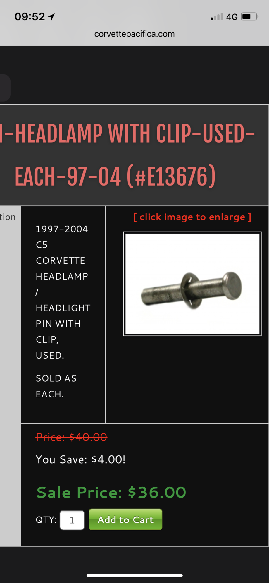

I did some searching online, and i came across this. Is this the correct piece?
