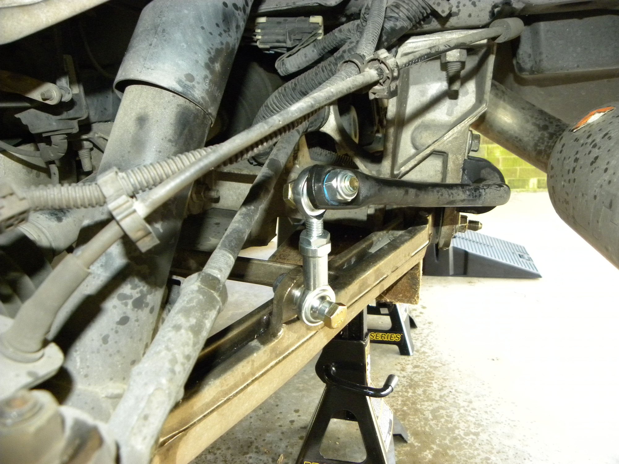

Originally Posted by sloopdawg
I went with the Steinjager end links and like them but to do it over again I would have went with Moog just because they have the grease fitting.
If you're going for adjustable open links, then I highly recommend getting boots for them as well. Over time, dirt and humidity will destroy the bushing. Boots will extend their lifetime enormously.
Also, I would install them with the male threaded end of the link on the bottom. That way any moisture can't wick it's way into the female side, of the link, avoiding possible seizing. Anti-seize on the threads helps over time, a dab of moly paste is even better since it doesn't dry out like anti-seize does over time. You can also liberally coat the ends of the links with moly paste before putting the boots on.
The other problem with the Steinjager links is the spacers. They don't provide enough lateral force support, especially where the A arm tab is concerned. The contact area is so small that over time it will eat into the aluminium. Skirted type spacers are highly recommended here.
Use the skirted side of the spacer, along with a washer, on the aluminium will eliminate any possible gouging or galling over time. That is the setup I've used in the picture of the installed link above.
Another option is conical spacers, which eliminates the need for a washer.
The only drawback here is that they don't work well with the boots. I initially installed these when I first installed the links, but skirted spacers work perfect with the boots.
