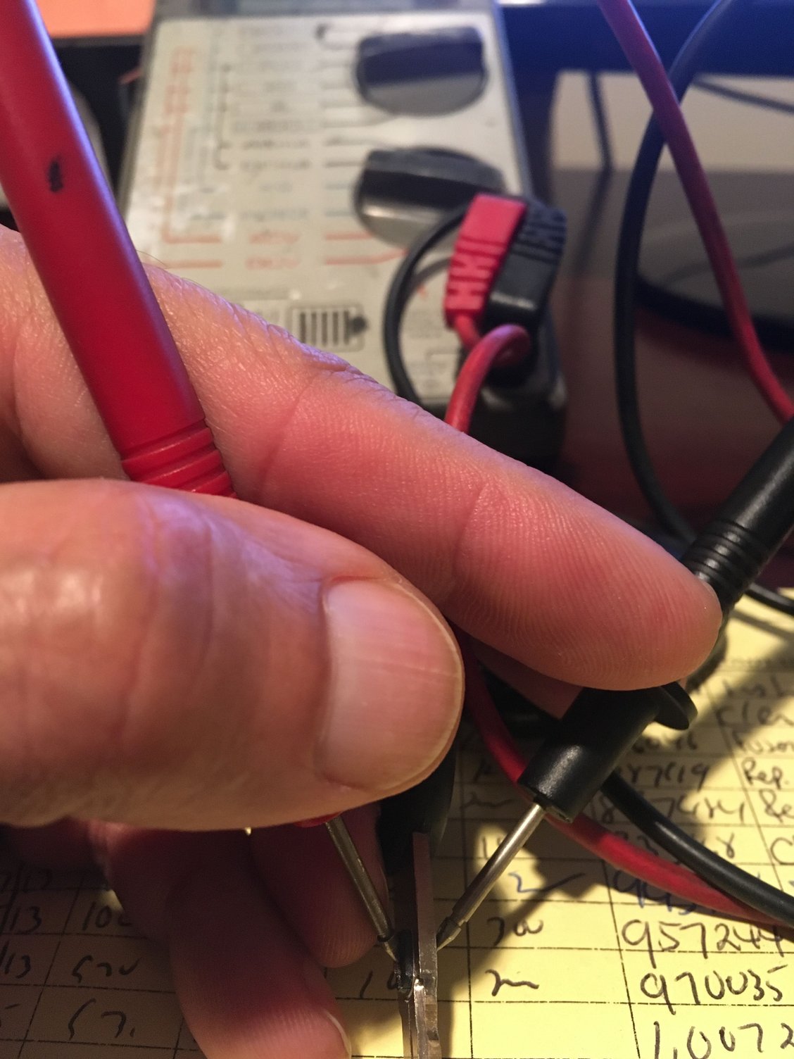

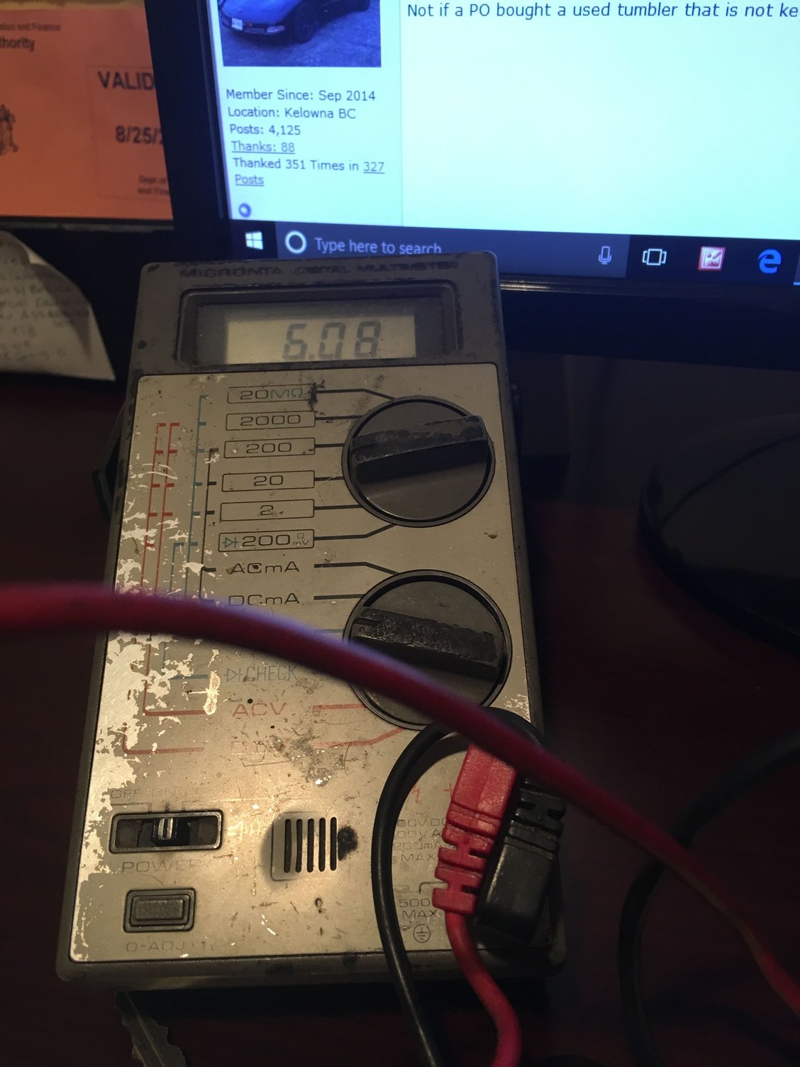

I just did this on my 99, I took an ohm meter and checked Resistance in vats, checked this 3 times and came up with my code, think it was like a 6.5. I purchased the blank key on line and when it came in, I checked it and was perfect. I took the key to a locksmith, I didn't trust anyone else. The key works fine...

Ohm meter on each metal probe of key.

Like this
Originally Posted by 1997 C5
How do I check the the Resistance in vats? what is vats?
