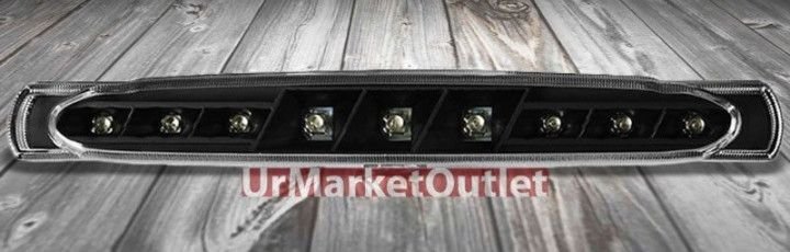

I have also ordered ordered this third LED brakelight .

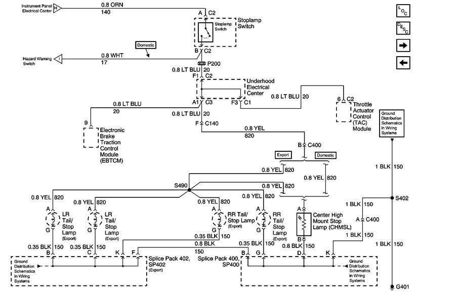

Do I need to connect a load resistor ( 6 ohm 50w) on this brakelight to avoid alarm from my EBTCM module when I activate my brakes .
The EBCTM receive a voltage signal from the stoplampwitch and I guess the voltage level is different when you use LED instead of stock bulbs .

The OEM 3rd brake light IS an LED assembly. Replacing it with another LED unit should not make a difference.

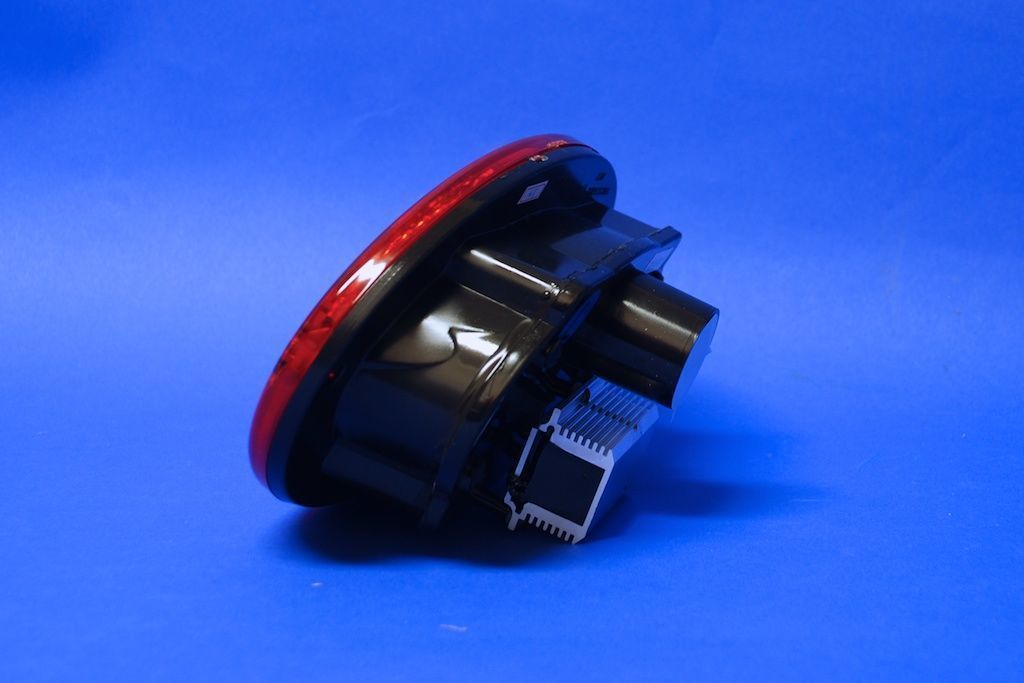

If your modified LED Halo taillights have the built-in resistors like the one shown below, no error code should be generated and no extra resistors should be needed for this purpose.

Thanks for your replies .
It seems like my LED´s have load resistors when I look on this picture from my ebay order and then my stock flasher should work without any hyperflashing ( I hope ).
