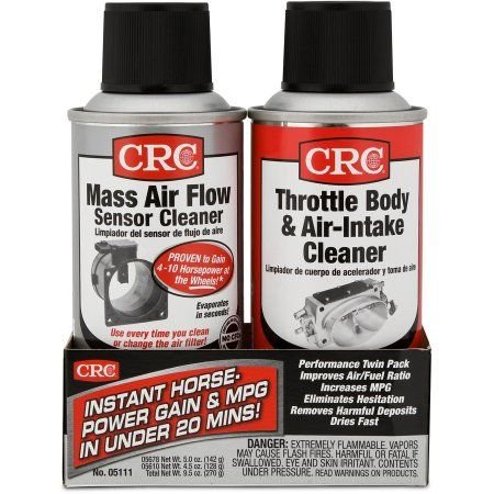

You can also clean your throttle body while your at it.
Walmart sell's this 2 pack one time use
Thats what I purchased at Walmart a couple of weeks ago.

Best bang for your buck.
On a side note: I was SURPRISED how much carbon build-up was around the throttle blade before i cleaned it.
Once cleaning was done on both MAS and TB i noticed a huge difference in throttle response.

Also did both ...the throttle body and the MAS. Much smoother idle and throttle response.
