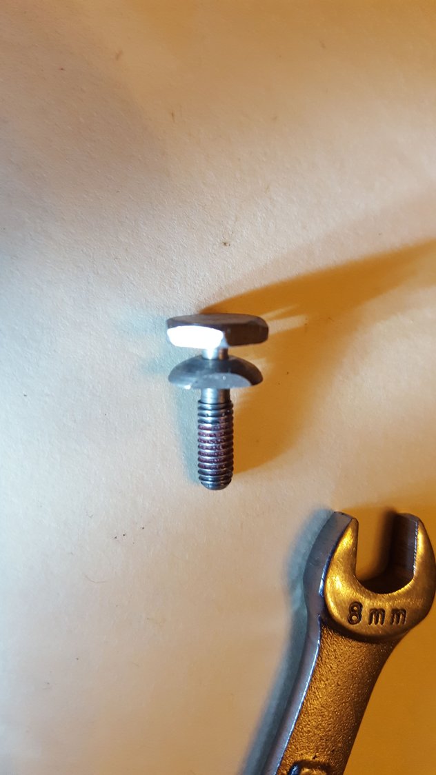

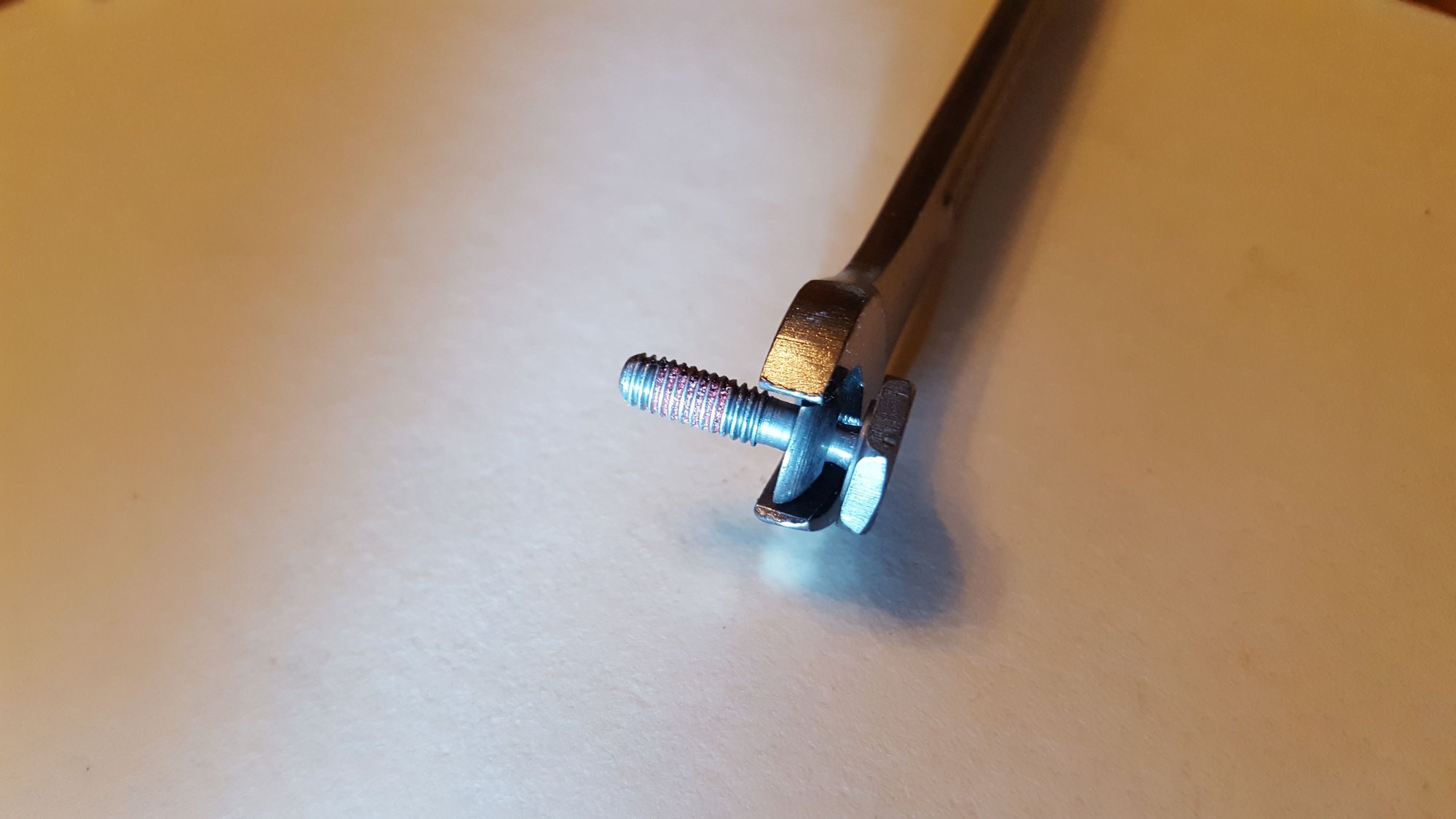

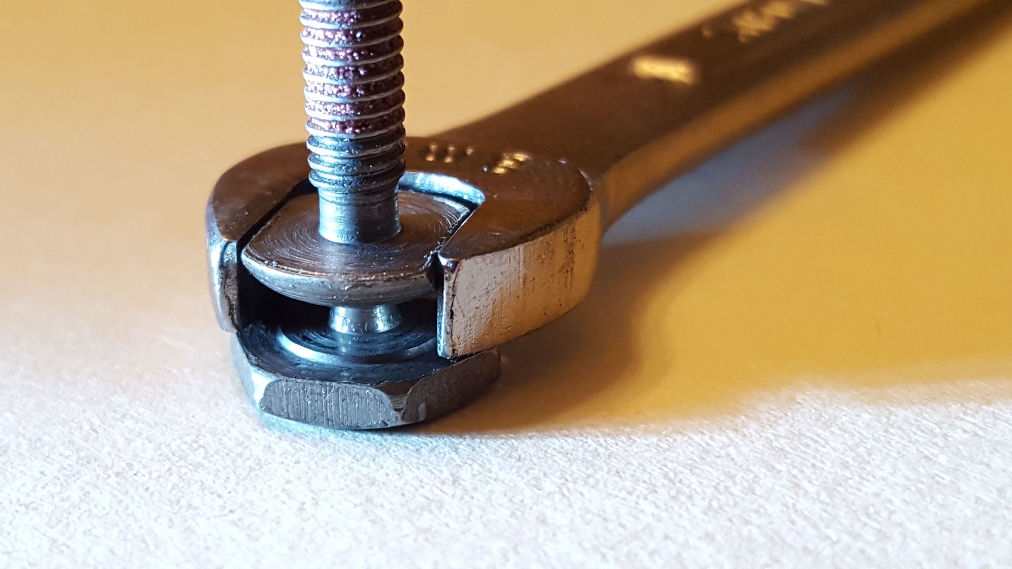

As your dealer did the repair back on 05 Dec 2001, I suspect your dealer used GM/AC Delco parts, therefore you should be able to remove the bolts>>> you will need a 8mm open end wrench to remove the bolts.
To remove the bolts proceed as follows;
Using the 8mm open end wrench, loosen all bolts on the fuel pump module. Once the bolts are loose, you can use a pair of “mini-vise” grips to clamp on the head of the bolt to remove the bolt.
WARNING>>DO NOT USE large pliers or LARGE VISE GRIPS on the bolt head as you can “side load” the bolt while turning the bolt and SNAP THE BOLT OFF IN THE FUEL TANK THREADED INSERT!!!
TIP> these bolts are not beefy by any means and extreme care should be taken when removing this style of bolt. If you take your time and DO NOT “side load” the bolt while turning you should be good to go!
Replacement Bolts> Below are pics of the AC Delco replacement bolts and they are the “shear style” bolts which reduce the risk of striping the threaded inserts in the fuel tank.
After Market Bolts> If using standard aftermarket bolts you will need a torque wrench to apply a specific torque to the bolts as to NOT strip threaded inserts in the fuel tank.
Getting a fix the first time> you should be "good to go" by replacing the fuel pump module seal and bolts.
