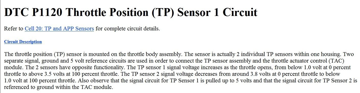

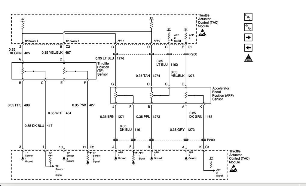

The ThrottlePosition sensor consists of two individual position sensor circuits. It seems both sensors have problems.
Check the wiring and plugs on the TP .
I attach both troubleshootings procedures ( P1120 and P1220 )
