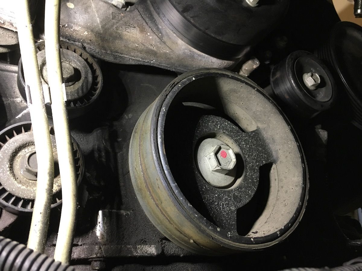

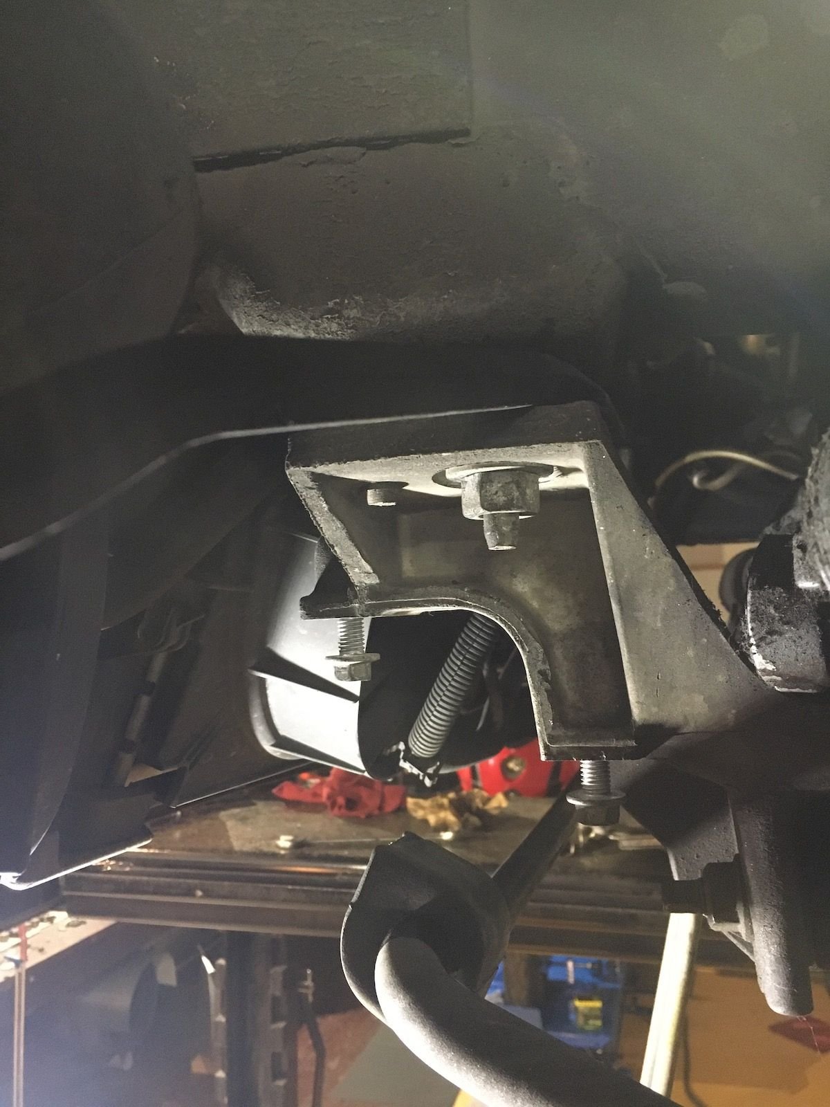

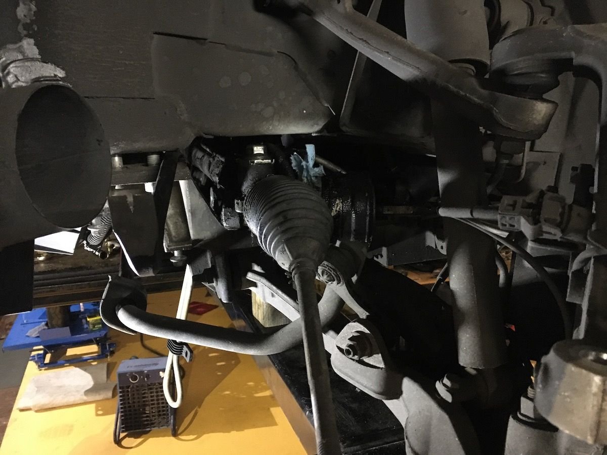

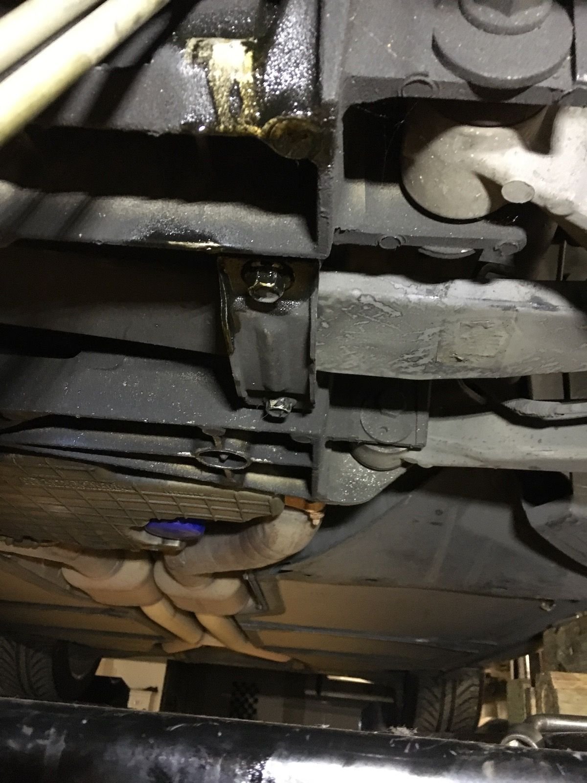

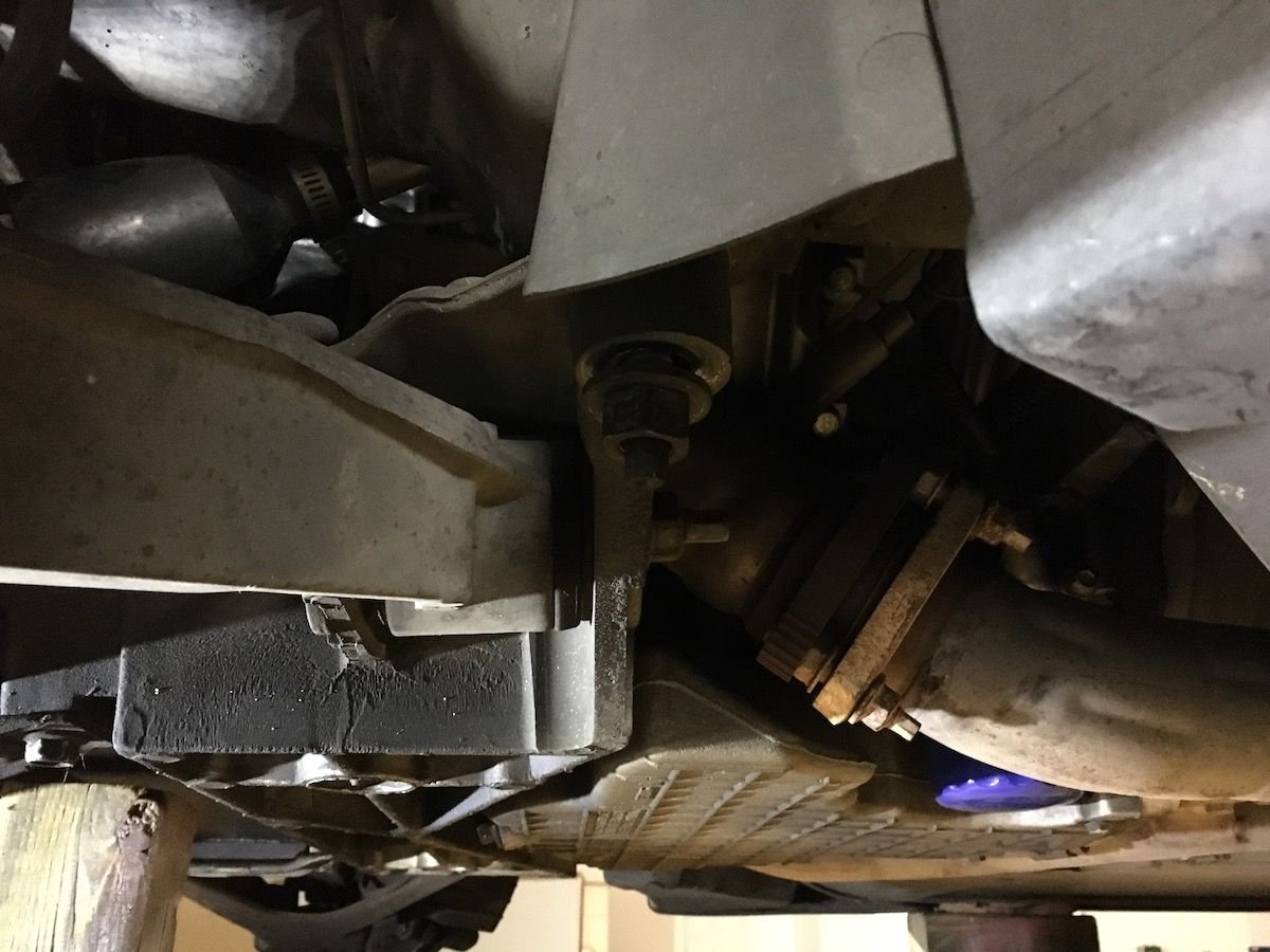

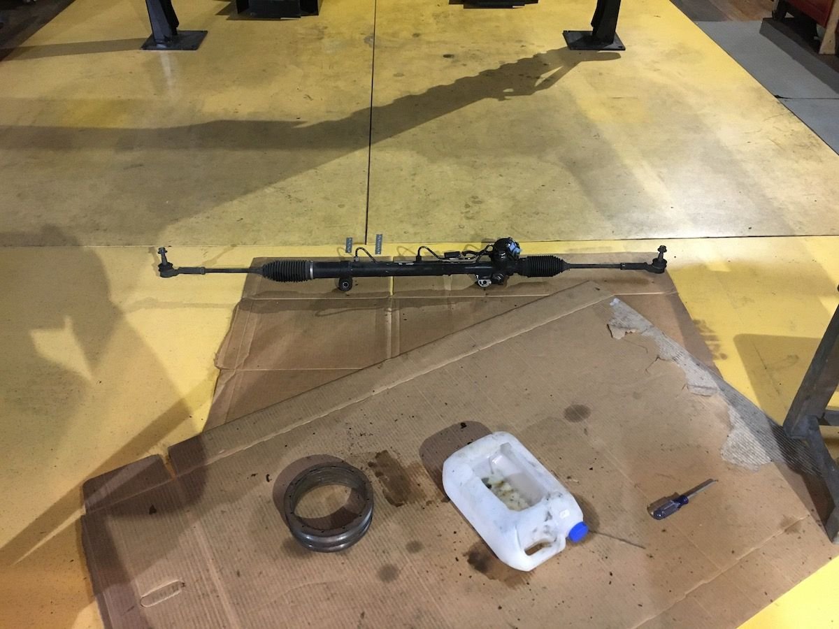

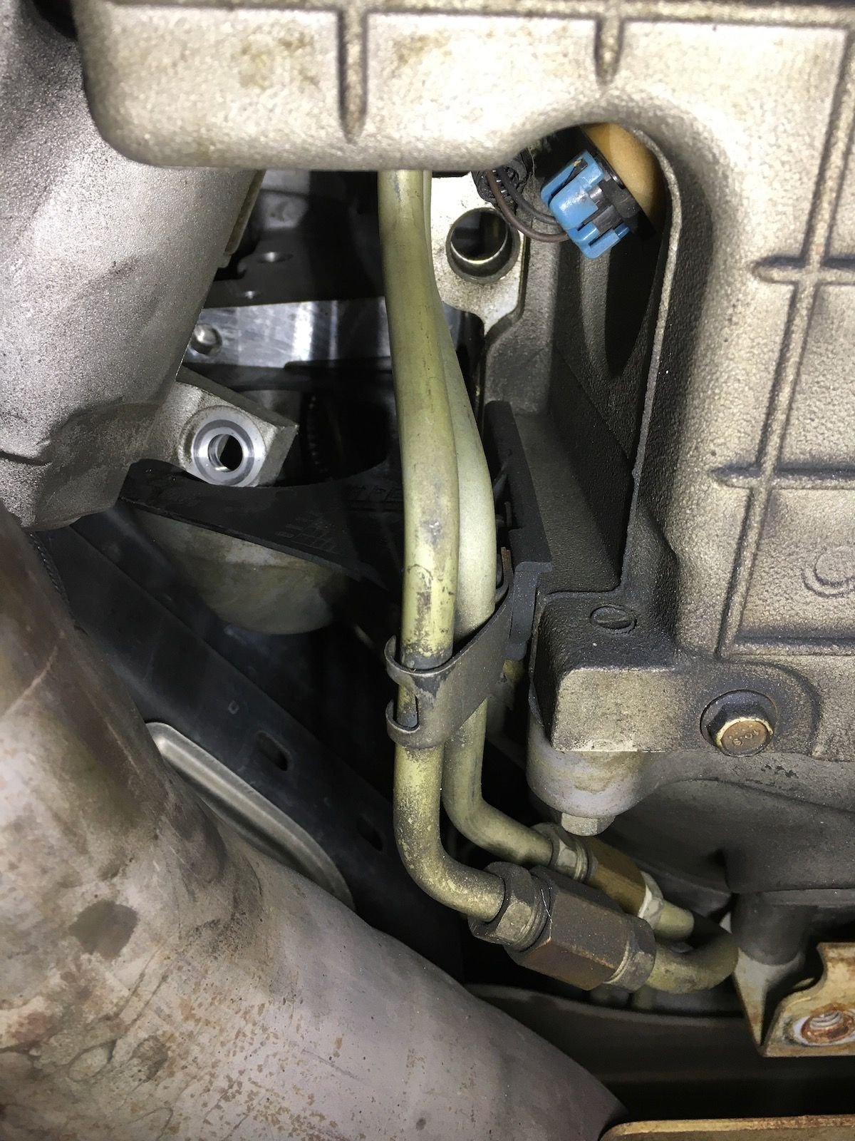

I am changing the damper on my 98 coupe right now and would like to share my experience so far with a little text and photos.
The subframe bolts, I used a breaker bar to push it down, seems like the spring is keeping/pushing the subframe up so no worries it will not drop down.
View from the other side, my '98 only called for loosening the pressure lines and the electrical connector no brakeline stuff.
The rear driver side bolt.
TIP: All of the four 15 mm bolts on the composite spring needed tensioning, they were a little loose so check yours.
Steering out, I discovered it was a remanufactured rack (89K miles on car) and it came out quite easy.
Total separation!
I had to drop exhaust to get to the starter bolts, then I just pushed the starter forwards/tilted and there seem to be room for the flexplate lock but I will know tomorrow when parts and tools arrive.

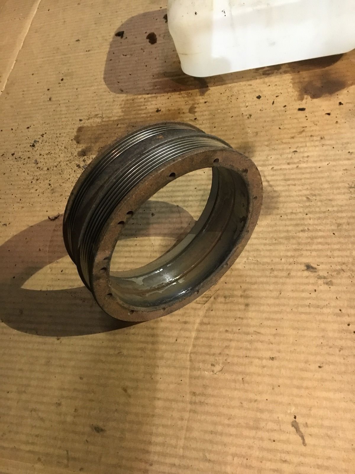

I replaced mine because of an oil leak which was caused by the seal where it ate into the balancer hub. The G.M. replacement one has a wobble to it where the old one didn't. Warranty Yes, time and will to re-replace it No
