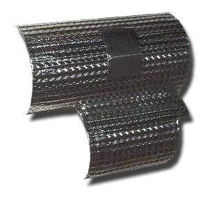

You could also try one of those starter heat shields from DEI (7" x 24"):
1) Versa Shield (500°F direct and 2000°F radiant):
2) Starter Shield Ultra 47 Series (1350°F direct):
3) Starter Shield Onyx Series (1350°F direct):
Or one like this from Lingenfelter:

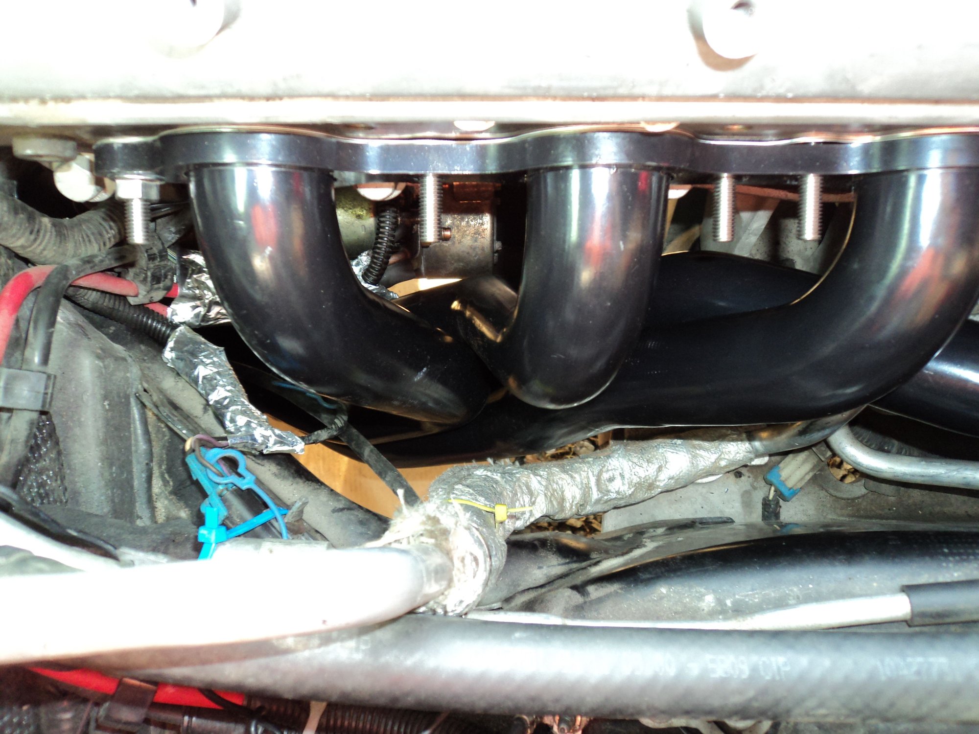

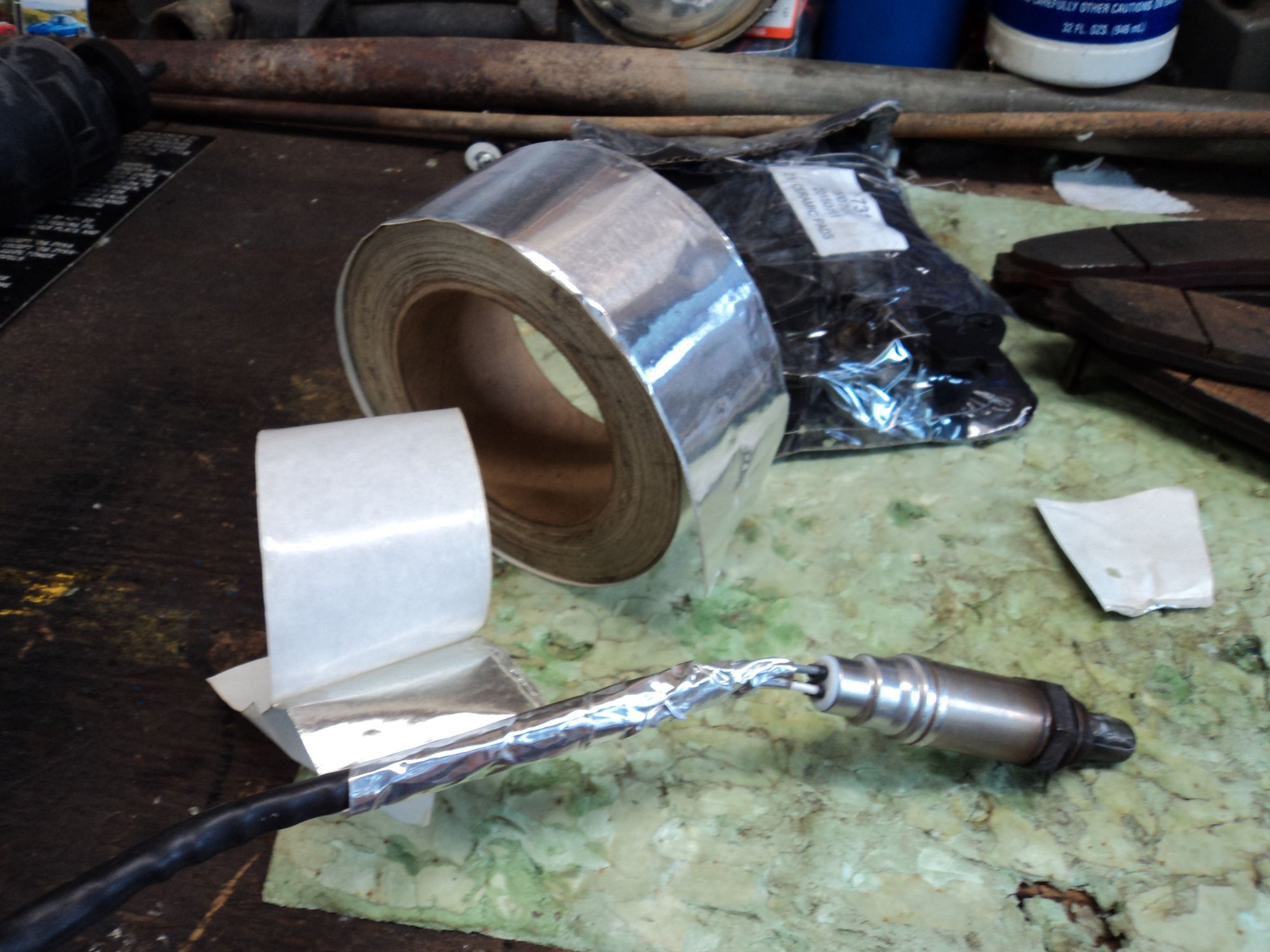

Try using heat duct tape and tie straps to hold them out of the way...
I wrapped all wires around the headers...
at the starter, fire wall ect....
no burned wires in just over a year.

Just wrap them all....both sides...
