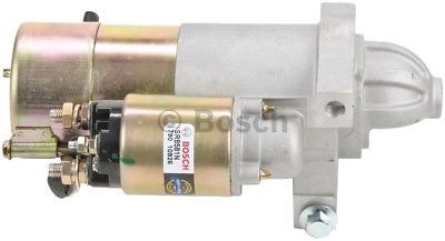

Have you checked the alternator-starter-battery connection path?
Go to the starter solenoid and check the main connection for burnt, corroded or loose wires. That is where the starter, alternator and battery connect together and it is often the cause of charging issues.

This seems like a dumb question:
Is that by the starter?
Iirc, that requires either jacking the car or using a lift, taking off the wheel, a shroud, and a bracket.
If that's the case, I'm going to need to take it to a shop - that's too much for me to tackle....
If I'm wrong, please please please correct me.

The starter itself, and the wiring, you should be able to get to ok simply tighten by just jacking the car up. Even with headers I could do that. I have headers and had to remove the passenger side header to gain good access to the ground above the starter. My reason for getting to the ground was to remove it. It was being replaced by one in a different area due to a battery relocation.
Not sure if you can get to either from the top or not with stock exhaust. Someone else will know though.

Yes, the starter solenoid is physically attached to the starter. As you can see in this picture, it is the cylinder-like device on its side, where the electrical connections are made:
This is a view from below, passenger's side:
This is another angle:
And another one:
Give it a try!
